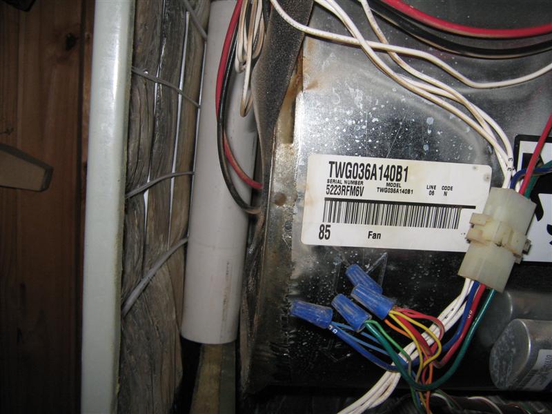

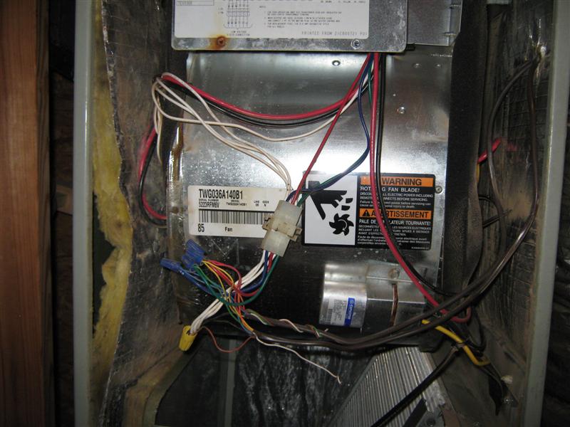

Tally got me to wondering what the coils and terminals look like in the compressor. I had a really busy day today, so I asked my dad to take a look. I also printed out some of your comments and suggestions. With that, he looked at the coils and determined them to be nice and clean. He looked at the terminals and also said they were good. He set the AC to 65 degrees and while it was running, he felt the wires, which were cool.
He then went to do the same on the inside, blower unit. I'm drawing a blank on what it's called. The filter was clean. I change it the first of every month. I've never opened it up, but Dad did. The heating coil is spotless.
But he did find a big suprise.
The insulation that lines the sides of the unit was sucked into the fan or blower. It's a wonder tha any air got through the insulation since it was sucked in there so badly.
He had already pulled it out when I got home, but he didn't know what to do in order to stop it from happening. The first picture shows it starting to get sucked back into the fan/blower again. Just in the picture, it's amazing how much air the insulation blocked.
I found a metal screen/grill type of thing in my scrap pile that fit after cutting it down to size. Then I wedged in a length of scrap 2 inch PVC pipe to hold the grill in place. There is now a large gap between the insulation and the fan.
I'm hopeful that this will allow the air to flow freely, which should require allot less power and electrical usage.
Thank you.

Yep, Eddie you got it! With a lack of airflow over the evaporator, the coil would likely ice up, further restricting airflow.... it's a vicious cycle that will:
a) cause your house thermostat to say, "Hey- we need more cooling! Keep running!" (and not get any...)
b) Do bad things for the compressor (eventually), as the liquid will NOT evaporate in an iced-up evap coil (no source of heat), and potentially --likely, after a bit-- send liquid back to the compressor...:eek::eek:
That insulation "plug" alone would make your compressor run a lot more than it should. If it sounds OK (no loud rapping noises like loose valve-lash on rocker arms in a gas engine), it's probably OK- compressors are pretty tough, actually. If it did pump liquid, the valves-- spring-loaded flapper type, most likely-- are usually the first to go. You might wish to check it's efficiency: you should get about a 15 degree drop over the evaporator, between incoming air and discharge air, assuming humidity isn't extremely high. (I keep thermometers on my heat pump all the time for that purpose- one at the filter and one in the discharge duct.)
Your wire mesh-over-the-insulation solution should be perfect.
