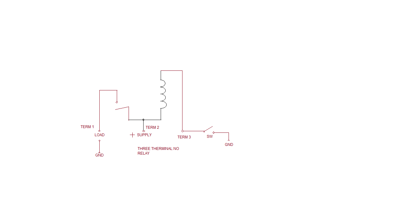

Hey here is a three terminal relay:
   / electrical relays #9
This seems silly to me. You close the switch to energize the coil and closes the contact which then supplies voltage to the load. Why not just have the switch in place the the relay contact? Hmmmmm, I'm sure there must be a reason but it escapes me at this time.
