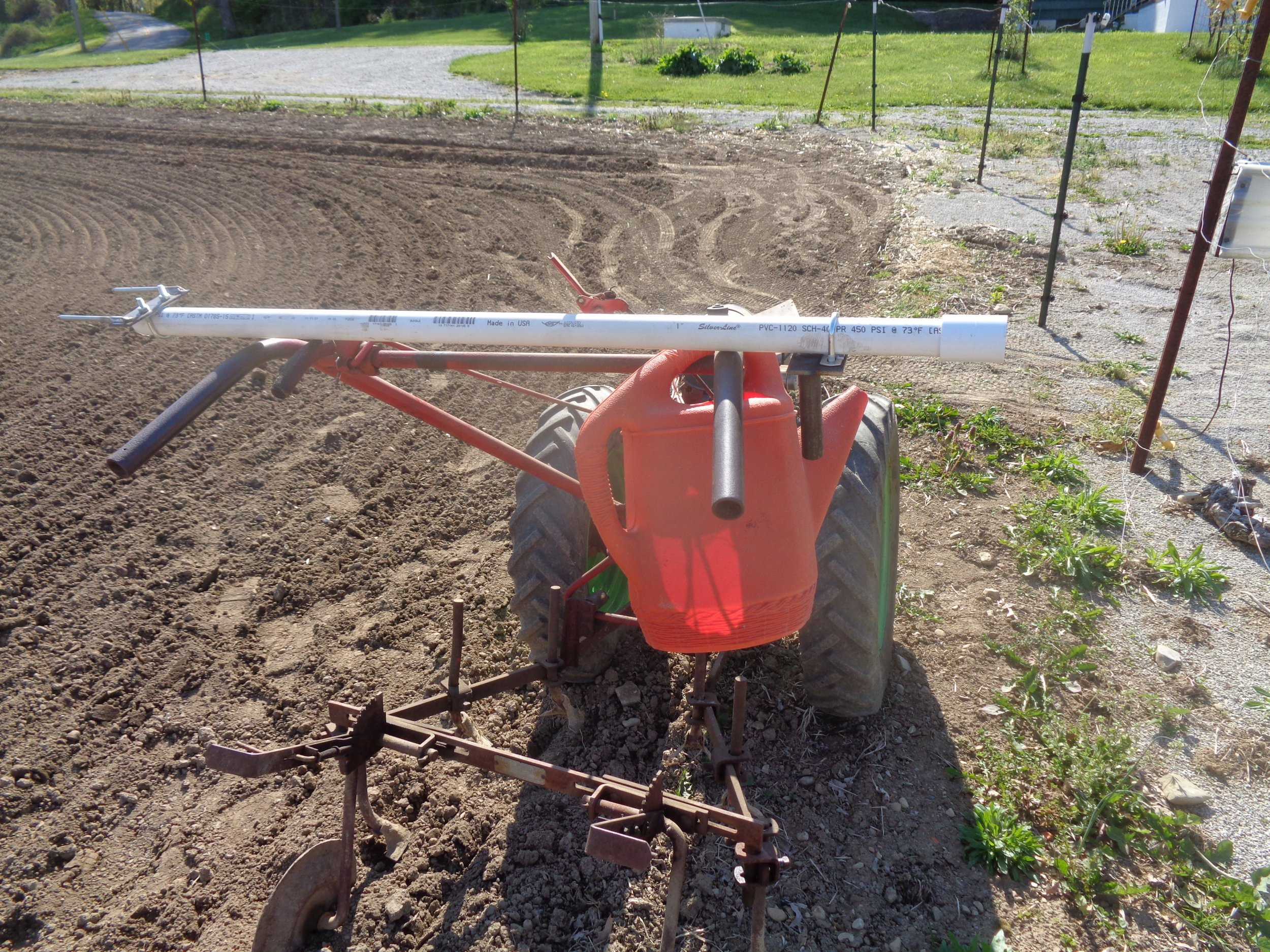

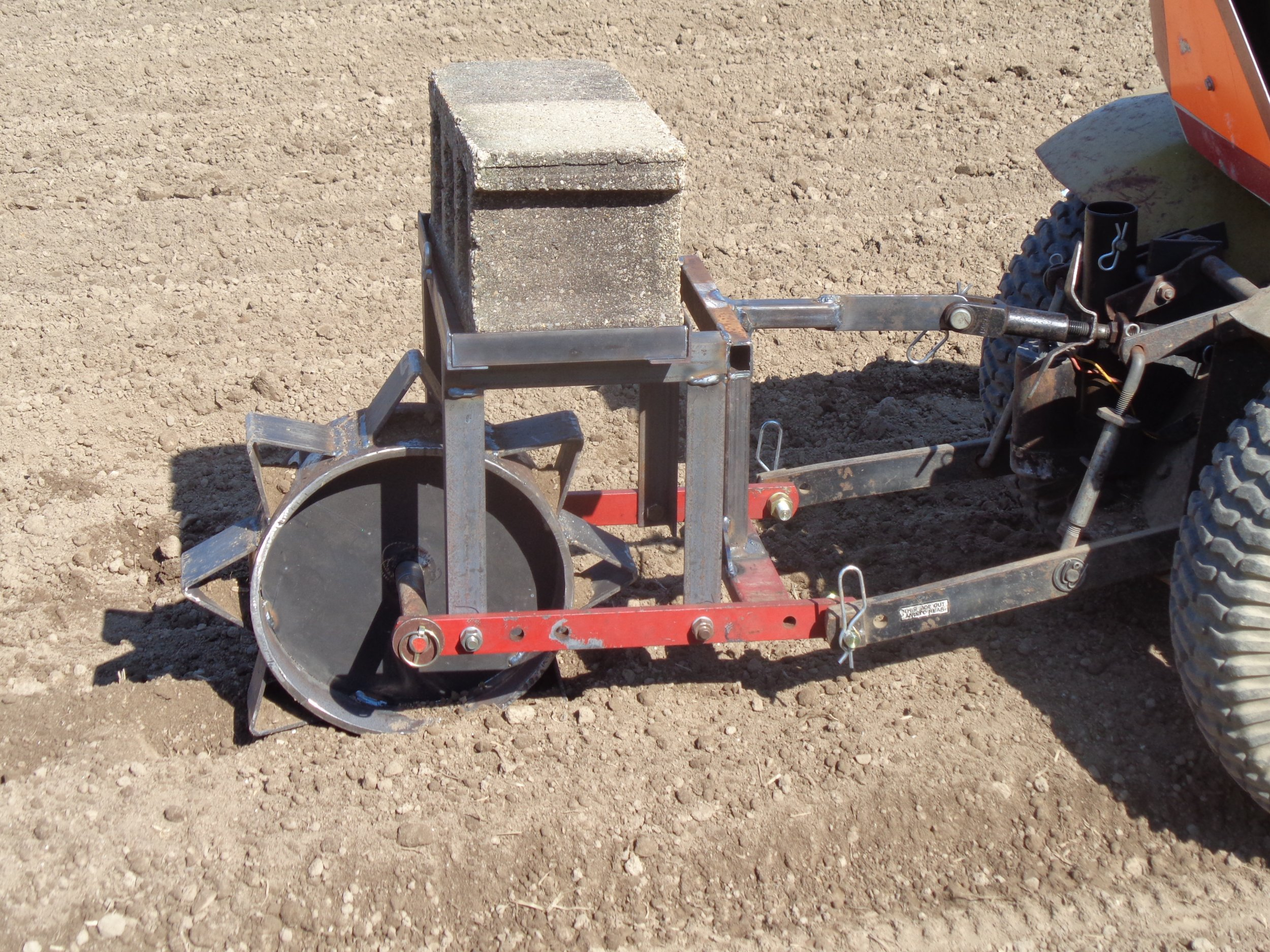

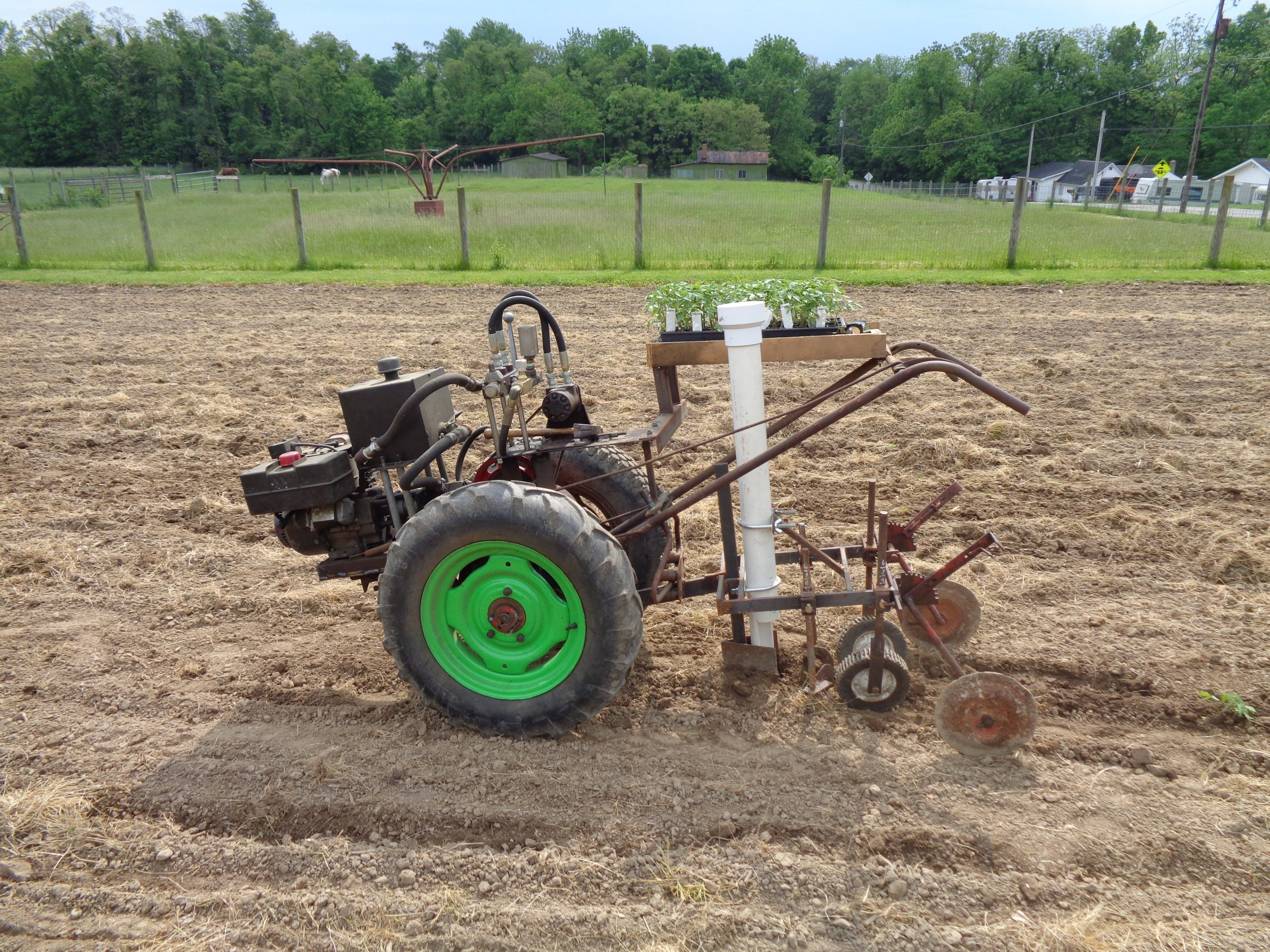

And, in the last 6-8 years have made a few things to make life easier for an old guy. Like a transplanter built from an old David Bradley2 wheel garden tractor, to set tomato, pepper, and cabbage plants, to a 3 pt. dibbler wheel I use behind my little Sears 4 wheel garden tractor with 3 pt hitch. It make "dibbles" 4" O.C. so as to plant onions 4" apart, or other items spaced to any distance apart, in 4" increments. I normally use onion sets, and made a simple planter out of 1-1/2" PVC pipe. A 5 qt. ice cream bucket holds the sets. I just run my belt through the handle to carry it. Not very high tech., but it works great. Last year, even built a small germination chamber out of a large refrigerator out of a camper. Stripped it out, put an 11 watt grow light in it, a 1 qt. slow cooker filled with water, and a digital heat mat thermostat to control the slow cooker heat. The slow cooker provides warm moist air usually around 90º, and moisture/humidity up to 80%. I can germinate onion seeds in 36 hours. Tomato seeds in 4 days. Pepper seeds in about 5 days, which normally seem forever to get to germinate with other methods I've tried. It's not too hard to find a fridge that doesn't work anymore, but I wanted a smaller one. I posted a want to buy ad on FaceBook Marketplace, and within 45 minutes someone answered back they had one, and only 10 miles away. The other items I have around $40 in, but should last for years. The great thing is, I can start onions, and peppers in Feb., and have them to transplant size (usually takes 6-8 weeks) by sometime in April. So, not only can you save money buying plants, you can start them from seed, and grow your own. I do buy many tomato plants from an Amish greenhouse, but for $1.10 a dozen, I'm not going to use up space in my little greenhouse to try and grow them for what I can buy those for. But, I do start one's they don't carry in stock.
Looks like I got a bit off track, but maybe it will give you a little more incentive to get that Cub going. At least you have until Spring to get things going, and bugs worked out. There is a decent garden thread here on down in Lawn and Garden. Might be something to look through someday this winter, and get some idea's. Going to post a few pics of my toys I've made, and use.
