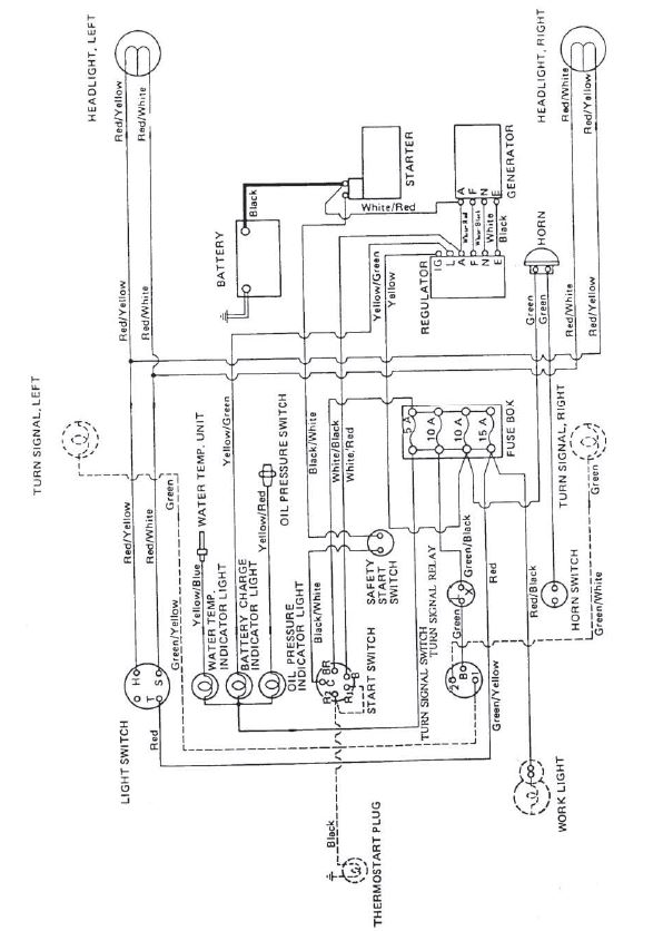

Sep 22, 2015 / Electrical issues #1 J Jamester New member Joined Sep 22, 2015 Messages 23 Location Memphis, Tennessee Tractor Yanmar YM2000 I in desperate need of WIRING DIAGRAM for Yanmar YM2000, does anyone have one???
Sep 22, 2015 / Electrical issues #2 H HoyeTractor Gold Member, Approved Advertiser Joined Jul 11, 2002 Messages 1,097 Location North Texas Tractor Yanmar Hope this helps
Sep 22, 2015 / Electrical issues Thread Starter #3 OP J Jamester New member Joined Sep 22, 2015 Messages 23 Location Memphis, Tennessee Tractor Yanmar YM2000 PERFECT!!!! Thank You so much
