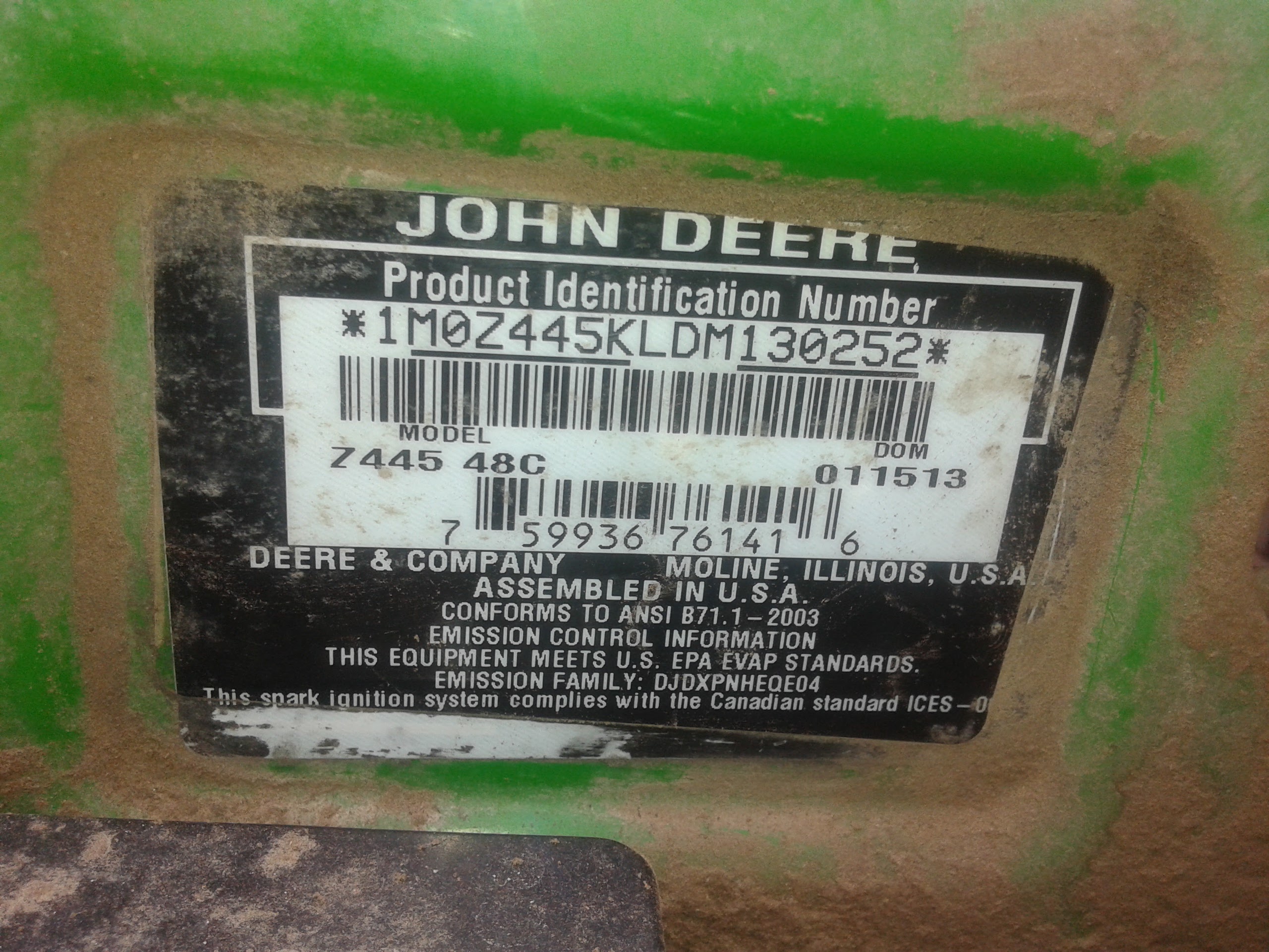

20151120_134048.jpg here's the serial number. Like I said sometimes it's turn over sometimes it won't, new starter, new battery, new relay, new ignition, sometimes with the handles in neutral i can't pull ebrake up it'll die, then if ebrake is up sometimes it won't start noticed my hour meter on even with mower off so don't know if short somewhere or what?

Sound's like a safety switch or safety switch wire connector problem. No way in telling you which it is,you'll have to test each to determine which is at fault.
   / Electrical issues starting shutting off #7
possibly a bad ignition switch.. try unplugging that and see if the hour meter is still running.. if it stops, that's you problem.

No I'm saying I've replaced all this stuff that I mentioned earlier, and I'm still having this problem I'm thinking it might be in the safety stuff, I wiggle the handles and move the park brake around and it would say right and then it would start also.
