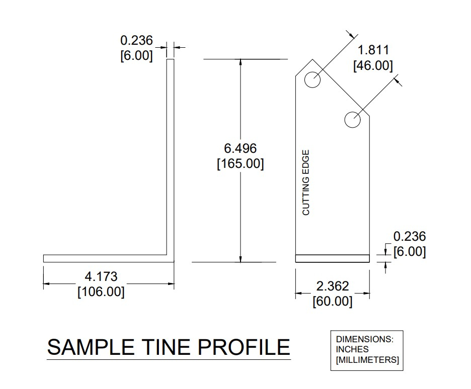

Ok, I did take the tiller out and did some quick measurements.
Diameter of the rotor tube: 65mm , thickness somewhere between 8 to 10 mm.
Diameter of the flanges: either 160 mm or 170 mm. Hard to tell with a measuring tape
Distance between flanges: 180 mm
Thickness of the flanges: 8 mm. For some reason I thought it was more than that, maybe because I was checking some heavy duty tillers the other day and mixed up the specs.
And the specs of the tines are on the picture. It takes 16 left handed tines and 16 right handed tines for a total of 32.

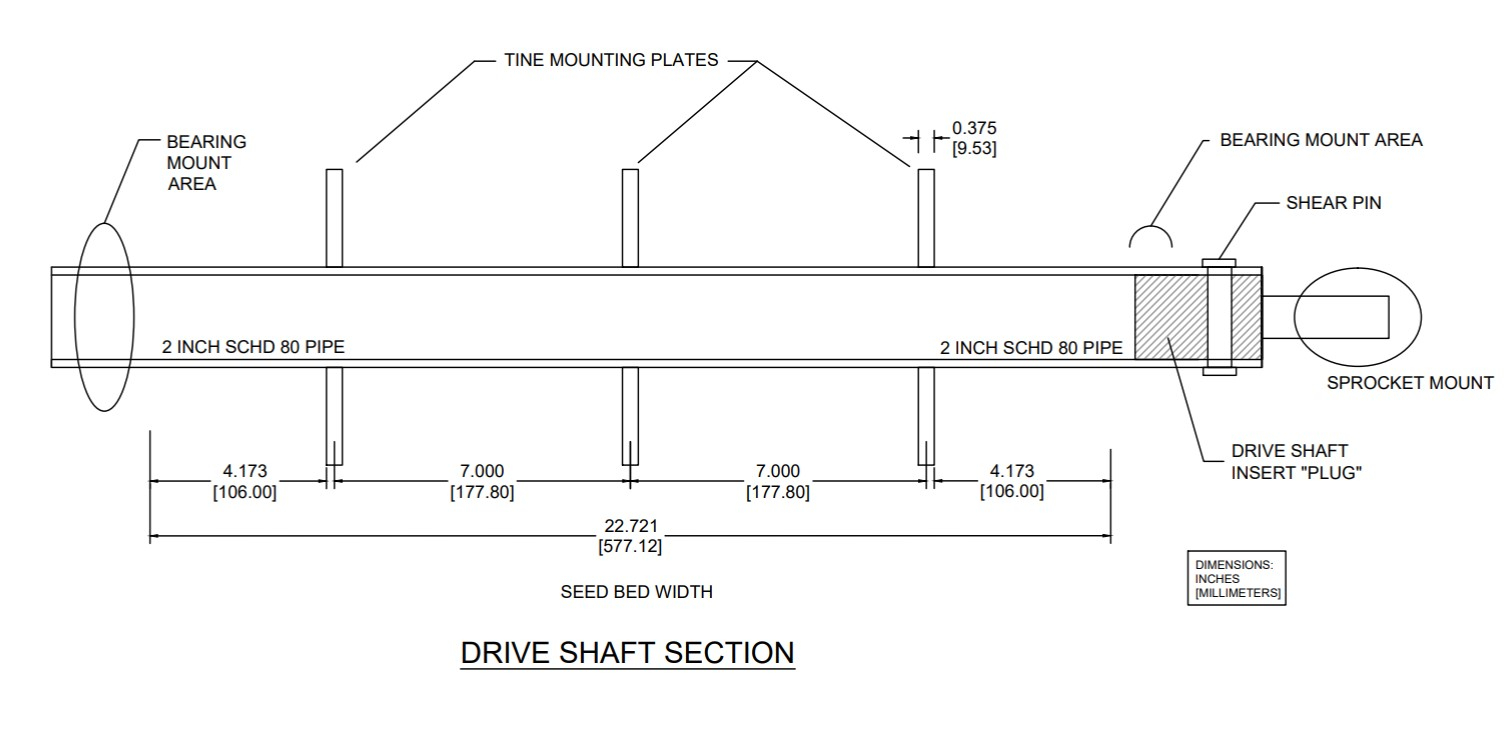

Updates on the Design . . . .
(see sketches)
Drive Shaft Section:
+ Sprocket Mount – this will likely be a 1:4 chain drive. Any ideas what pitch? 1200 RPM, 5 HP motor.
+ Bearing Mounts – looking at using 2-3/8 inch Pillow Block Bearings. Do these seem tough enough?
+ Centers Between Tine Plates – drawn as nominal 7 inches. Could be slightly wider.
+ Shear Pin – Mechanical. Good or Bad idea? Could also use “Electric Shear Pin” (Current / Amps Limit)
+ 2 Inch Pipe Drive Shaft – just using because it is cheap, available, and easy. Better ideas?

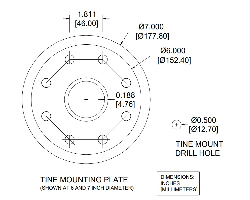

Tine Mounting Plate:
+ Hole Layout – just done to match Sample Tine Profile. Could be smaller or wider pattern. Ideas?
+ Size of Plate – just done to match existing samples – 7 inch has more substance, 6 inch may allow deeper soil penetration and less materials.
Sample Tine Profile:
+ Using the Profile of the Tine in this discussion. Will probably select a profile / manufacturer that is locally available and cheap.

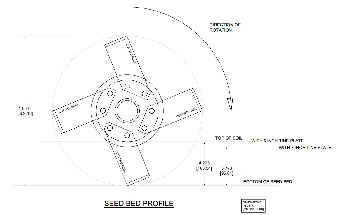

Seed Bed Profile:
+ Looks about 4 inches deep. Is this enough, or do folks tend to bury this type Rototiller deeper? (into the Tine Mounting Plates)?

I appreciate the metric and imperial dimensions. I've seen so many machinists videos that I actually don't mind imperial that much and it's a good exercise going back and forth on converting units.
I think it looks good overall. I like the tine placement and the flange spacing.
Definitely like the shear pin as well. The Japanese tillers do it the same way. If it's not too much trouble, I would keep the shear pin just in case and still add some sort of electrical protection.
As far as chain and bearings, my tiller uses a #100H heavy duty chain, I believe it's 1 1/4" pitch, but it has to handle much more power than your setup with the 5hp electric motor.
On the bearings, mine uses a double row deep groove ball bearing on each side. ID is 45 mm and OD is 85 mm. Then again, you probably won't need something that big.
Definitely use some commonly available tines. By the way, I'm sure you noticed but the tines are clocked on the rotor so it's like a spiral.

Big differences between pipe and tube. Pipe is not as consistent for structural strength and hard for fabrication. Use tubing or DOM tubing.
THANKS!
Only thing appealing on the Pipe is it is common, cheap, and already laying around. ;)
But not using that much, so buying some higher quality and higher strength is not that big of deal, either.
Any ideas on the use of square tube? -- for the Drive Shaft, I mean. Just Pondering. That would let me just use Angle as the attachments for the Tines. Like I say, just pondering. Would probably have round tube inserted at the ends for the bearings.
Any thoughts about the bearings or chain/sprocket drive?

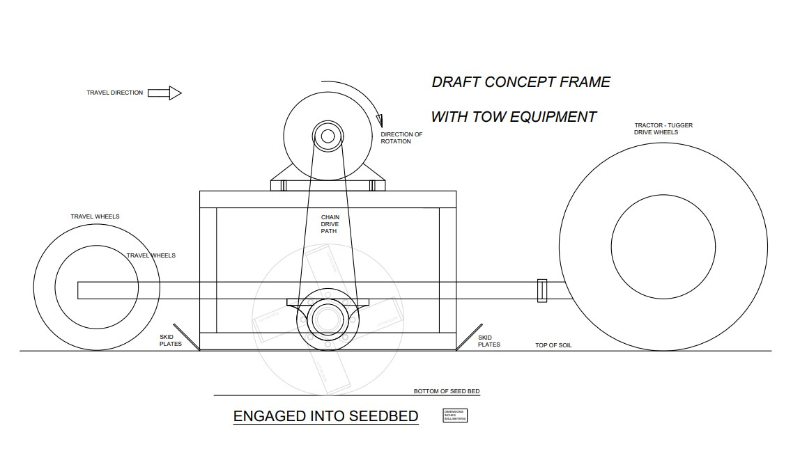

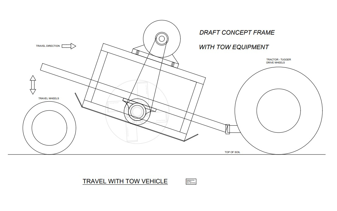

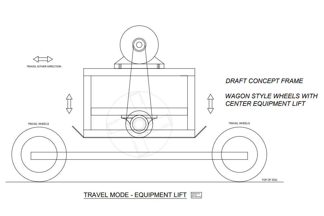

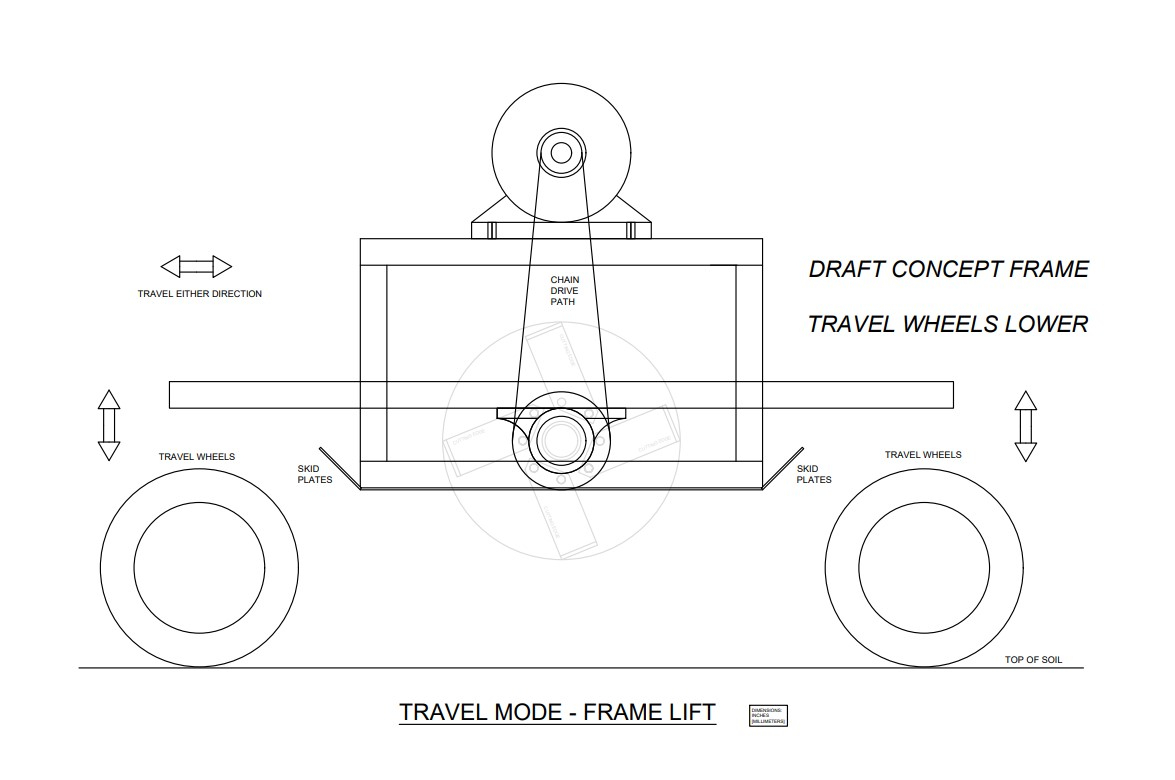

This is some concept discussion of best ways to do both motion on the field, and also transportation between sites.
One feature of a rototiller, is that it CAN (not saying should, but just can) pull itself along through the soil. This is sometimes managed or controlled with a drag tine, or throttle speed, or could be managed with a braking cable anchored at the edge of the field.
It can also have mechanical drive wheels attached, or have lift / transport wheels like a typical towed disk harrow. Sketches below. Any insights or comments are welcome. Thanks!

   / Electric Rototiller Details -- Review, Comments, etc. #19
Not all rototillers are the same. Field tiller vs garden tiller (TSC).
My 50 year old Howard rotavator has a two speed gearbox.
Good used tillers are out there.
Learn about underground mining to gain some mobile electrical operation knowledge.
