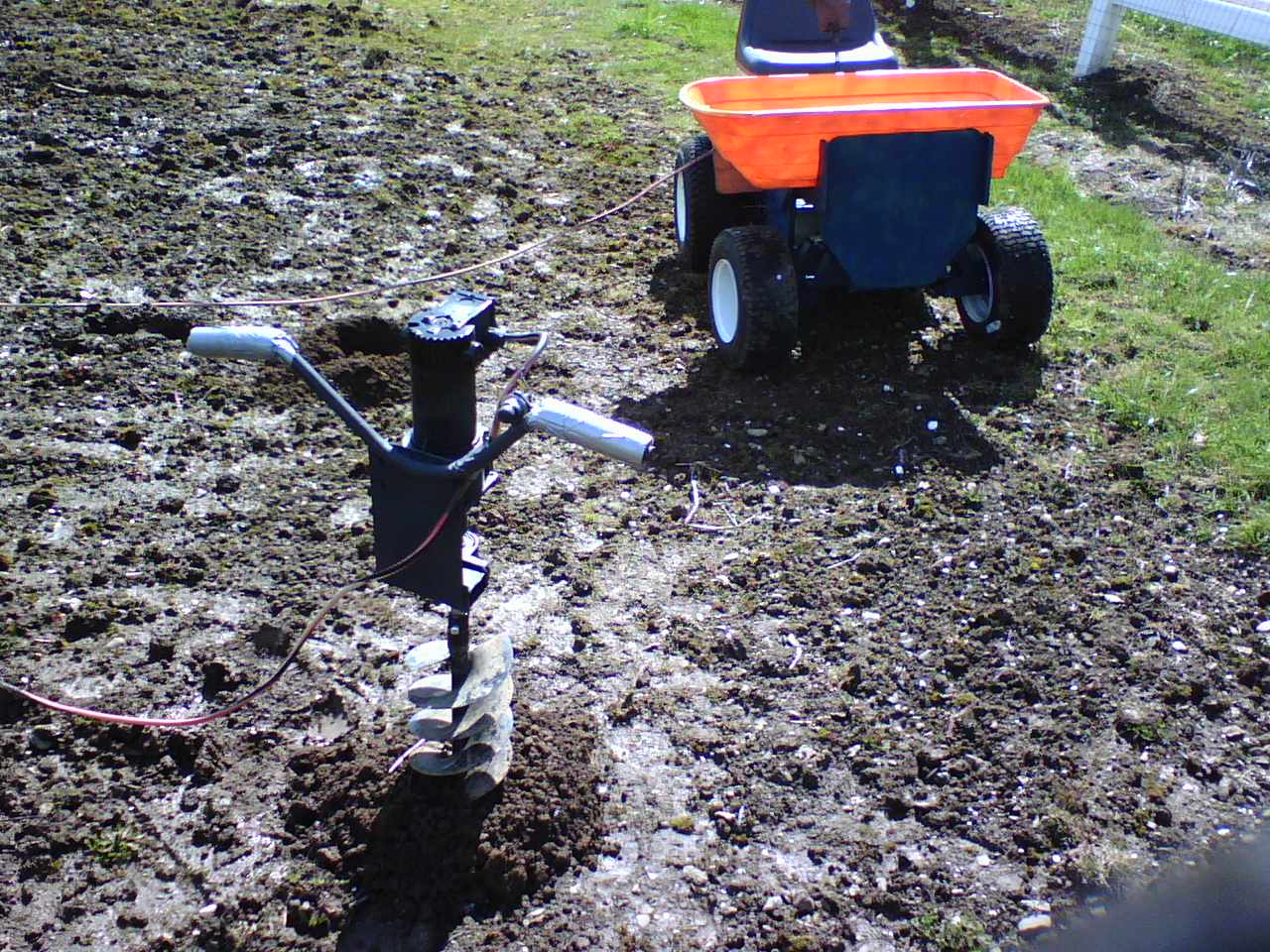

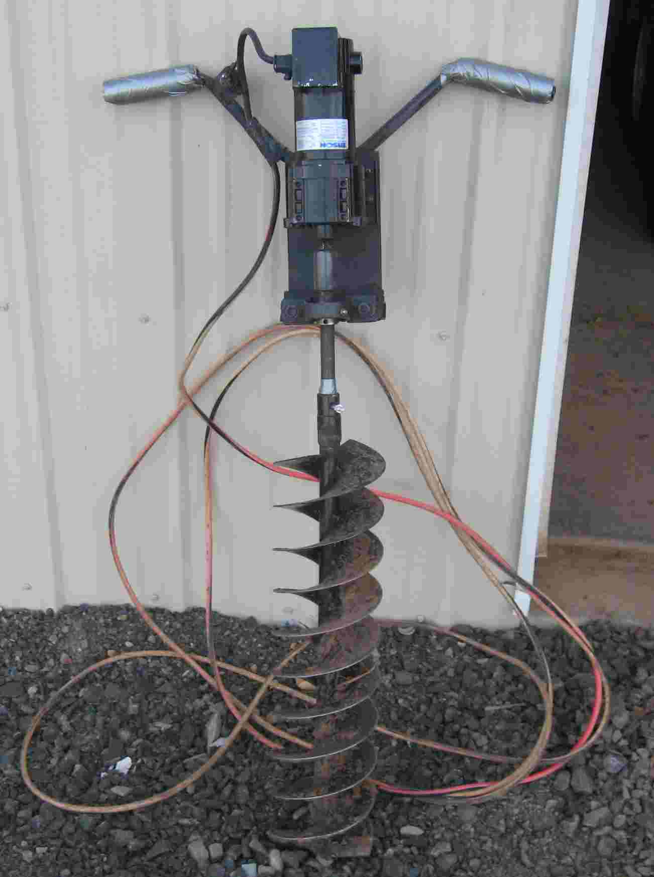

I built a 24v electric post hole digger to go with my electric yard tractor - lets me easily drill holes for tree and pumpkin planting, without going through the hassel of mounting my 3 point PHD on the (real) tractor.
It was pretty simple to build, since I just tap the power off of the yard tractor - I used a 12/24v bison gear motor, 10amp, 120rpm, from surplus center. Made some fitings, welded together, added a pillow block bearing, 6" auger, wiring and switch, and it works great - drilled 100 pumpkin patch holes over the weekend.......

not so much the pumpkin seeds, but making pumpkin mounds- last year a guy down the road put in a pumpkin patch and ended up with nothing but dead pumpkins...too much clay, not enough soil.. so this years experiment for us is to drill a (short) post hole, fill with compost, ending up with a nice little pumpkin mound... a drip system to keep it wet, and hopefully we'll have a nice patch...
and yes, you do need to keep an eye on the cord, reminds me of the electric lawnmower I used as a kid, I think it ate a few cords when I wasn't paying attention.
On this project, the cord is a piece of the neighbors christmas lights extension cord.. he ran it along his fenceline and the cows ate a few holes in it, worked out good for me.....
