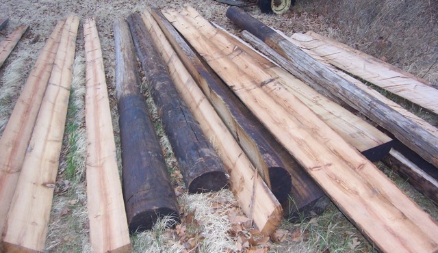

I made a split rail fence by taking an axe to the end and starting a crack, then driving steel wedges in the crack every couple of feet. Drive in a block in the end as soon as it's wide enough to spread the halves.
Yep. I have split posts/rails from black locust. Start a wedge in the end and 'chase the crack' down the pole. They should split easily but you need a minimum of 3 wedges.
Chainsaw? Will work but it is slow, hard work.
Harry K

What are you using them for?
I used them to build my pole barn and Just dug bigger holes to accomodate the larger poles.

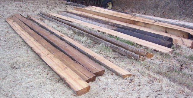

Pole barn ... I am wanting the one side to be flat to recieve the plates and the purlins better.
I ripped 3 yesterday with my Sthil Farm Boss ... a job no doubt. Am planning to try the wedge deal today.
What about just notching for the plates/purlins? It seems to me that you could do that with a circular saw and a chisel.

I get to many projects going!!
Anyway I ended up taking them to the sawmill ... had 12 and came back with 24 !!!! Cost me 90 bucks and they are nice... now to get started on the barn!!
