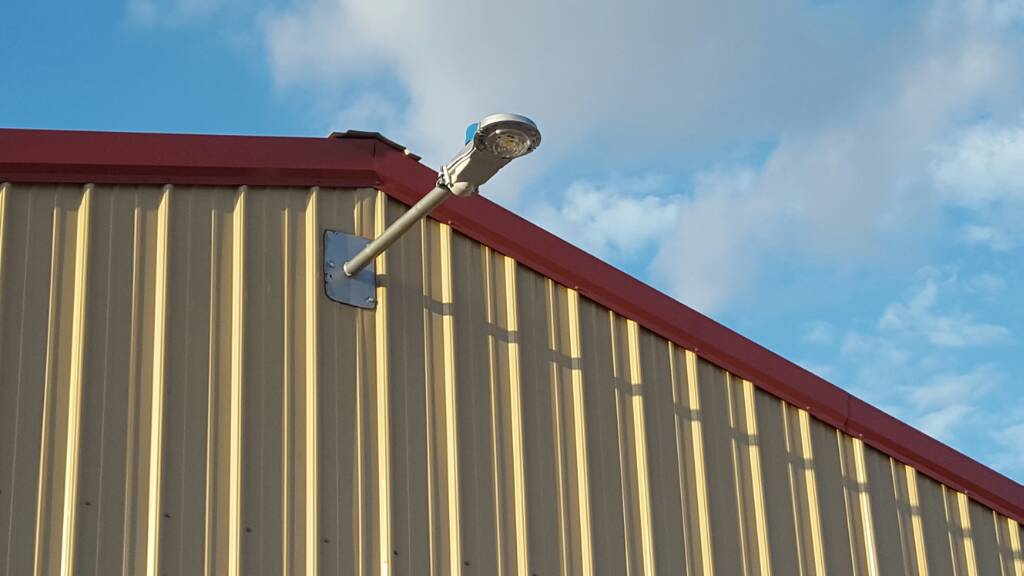

Electric is done and it came out great! I have not mounted garage-door-openers yet. Here are a couple of pics. Outside dusk to dawn LED,
I've seen those LED area lights around, but never one in operation. My wife wants me to light a 60' round pen. Think that one would be adequate about 20' up?
Super dark here, so a little light goes a long way.
