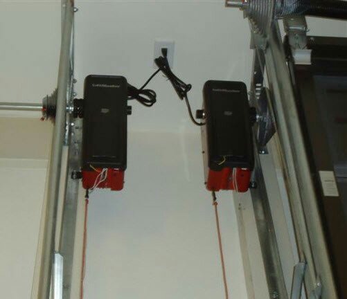

Thank you for all the replies and suggestions. You guys are a great resource. I saw on another topic a different option for a garage door opener I was not aware of....anyone have these or have used them. They look great.
It is a liftmaster side door jackshaft opener.
Elite Series 85 | Garage Door Openers | LiftMaster
View attachment 484045View attachment 484046
I have one and I absolutely love it. I got it because it doesn't need any extra crap to lift a 10' door, and requires no structure over the door. Was dead easy to install, and operates silently. I just got the internet gateway for it ($60), and now I operate the door from my cell phone. Programming is a little goofy, but if you follow the instructions precisely you are golden.

Yeah, those openers look pretty cool: thanks for passing that along! An interest for me is that they might provide me with a better way to setup for operation under generator power*. I was thinking about having openers plug into outlets and should I lose power I could unplug from the regular circuit power and plug into a separate circuit that'll be served by a generator: my situation is more than complicated, so I won't go into all the details. Anyway, having these things down from the ceiling area would tend to allow for this kind of switching.

There is a video on you tube that shows they sell a battery backup......no power issues.

I actually just made a little video of mine, here it is:
The 8500 comes with battery backup, all you have to do is purchase and install a compatible battery. One thing I was misled about before purchase, was that this door would be hard to open manually if the power went out. It is NOT difficult. It has an emergency disconnect just like any other door operator which disengages the operator from the door, hence, anyone who can open the door before the operator is installed, can open it after.
The internet gateway turned out to be pretty cool. It doesn't physically connect to anything except power (wall wart) and ethernet to your network. It only needs to be within radio range of any operators you want to control. Setup was simple and straightforward, and it doesn't matter if you use the Chamberlain or Liftmaster apps or hardware, they are totally interchangeable. I bought the Chamberlain gateway, registered it on the MyChamberlan website, and use it with the Liftmaster app on my phone...works fine.
The price worked out to about the same as it would have been if I got a comparable hp conventional operator and the extension kit to make it work on a 10' door.
