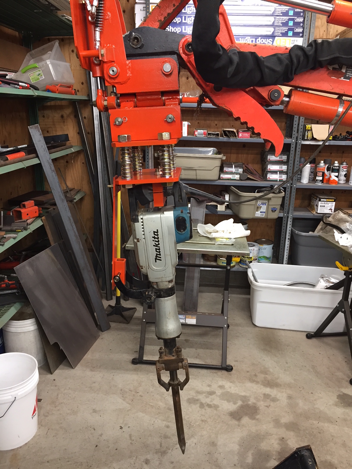

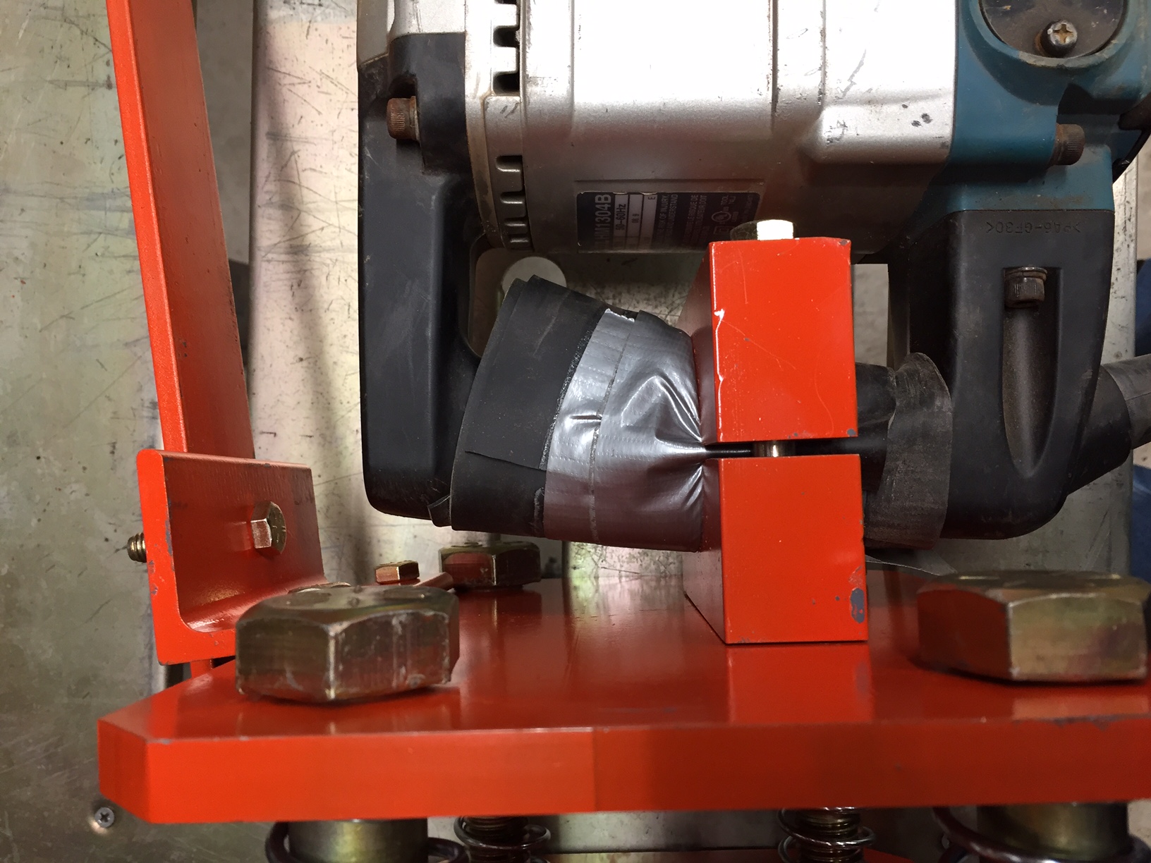

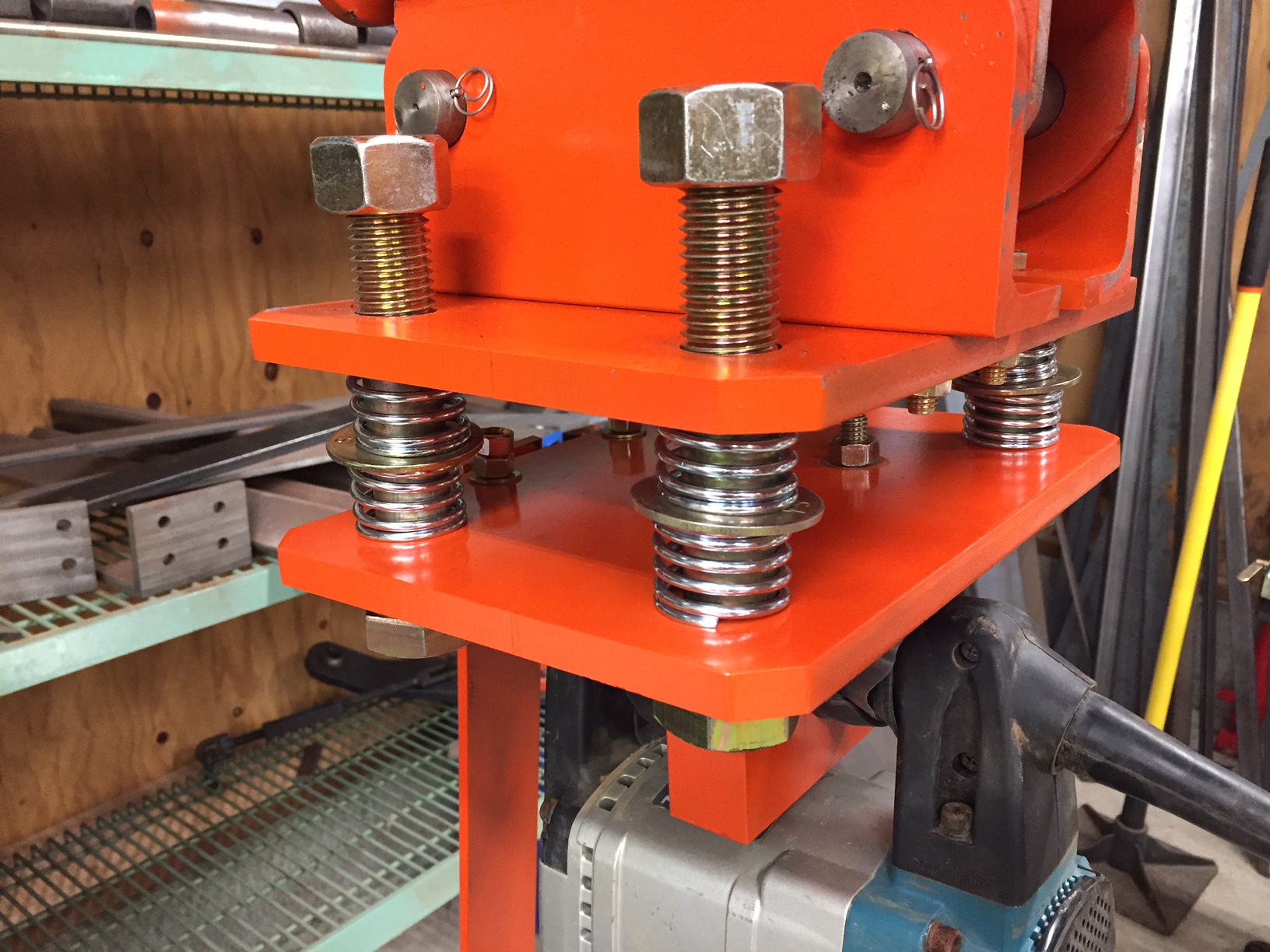

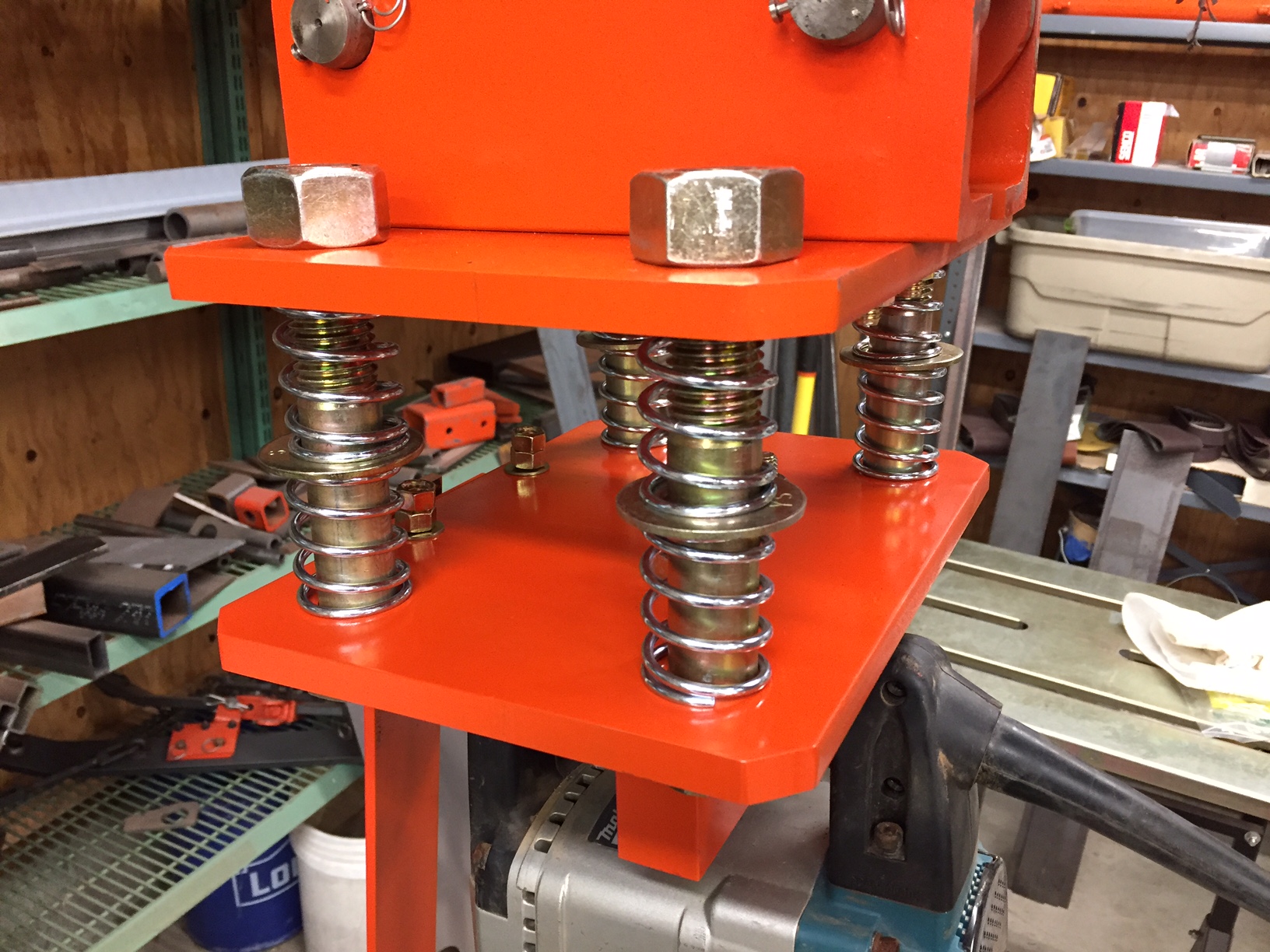

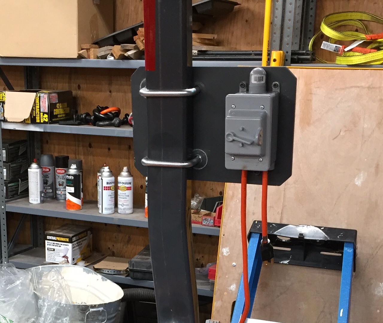

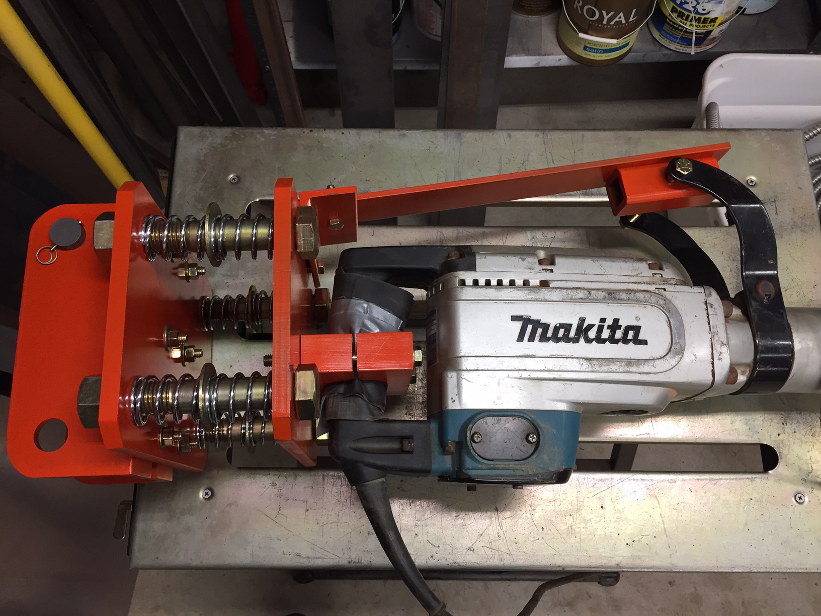

I have about 100 ft of concrete walkway to break up and replace this summer. My old Makita hammer will do it, but my back is not what it used to be. This winter I made an adapter so the hammer can be mounted on the backhoe coupler. The backhoe is just used to position the hammer, not to put down force on it. The bottom plate of the adapter connects to the hammer. The top plate of the adapter connects to the quick coupler. In between are four 1" bolts with eight moderately heavy springs. The springs allow me to position the hammer without putting excess down force on it. I put a weather resistant switch enclosure on the ROPS. One power cord goes to the hammer, another goes to a building receptacle. I could run the hammer from a generator too but since the walkway is between buildings I can use a long extension cord. The setup works as planned.
Photo 1: the adapter mounted to the hammer.
Photo 2: four wraps of strong rubber sheet around the handle to protect it from the clamp.
Photo 3: hammer mounted on the backhoe.
Photo 4: springs extended.

Photo 6: hammer control switch.

that is really nice planning and completion. Can you use it horizontally to bust out a wall if the need came up?
Yes I think so. The hammer is clamped at the main handle, and also at the side handle. I hooked the side handle up to allow slightly off-vertical use. I was not thinking of completely horizontal. But it could be used that way, sticking straight out behind. No different than handheld operation I guess.

What is the downforce of those spings? might need to add some weight to get it working correct.
/ Electric Demolition Hammer Mounted on Backhoe
#12
It is an important consideration for sure. Too weak and too strong are both bad choices. The springs I got are rated about 50 lbs/inch, max about 70 lbs. With eight of them, and a bit of compression. I figure the downforce on the hammer is probably 150-300 lbs. More than a heavy weight hammer operator could put on it. But hopefully not too much. I am not ready yet to break up the concrete walkway, but I did try the hammer out. As far as I could tell it worked about the same as hand held.

Even with spring adapter, hoe may exert too excessive down pressure on reciprocal mechanism . Elec hammers are designed to function under their own weight, the recoil repels human down pressure. Might work for awhile, doubt long term success. Here is an idea, visit a contractor supply store not a DIY like home depot but real contractor supply. Show your design, ask if the mfg will warranty the tool? That will be your answer. You did do a nice job on design and fabrication. But ask a tool to perform in a manner outside design perameters in not a formula for success. Do you want honest feedback or just affirmative accolades?
EDIT: from hoe seat very difficult to determine down pressure being applied/exerted
