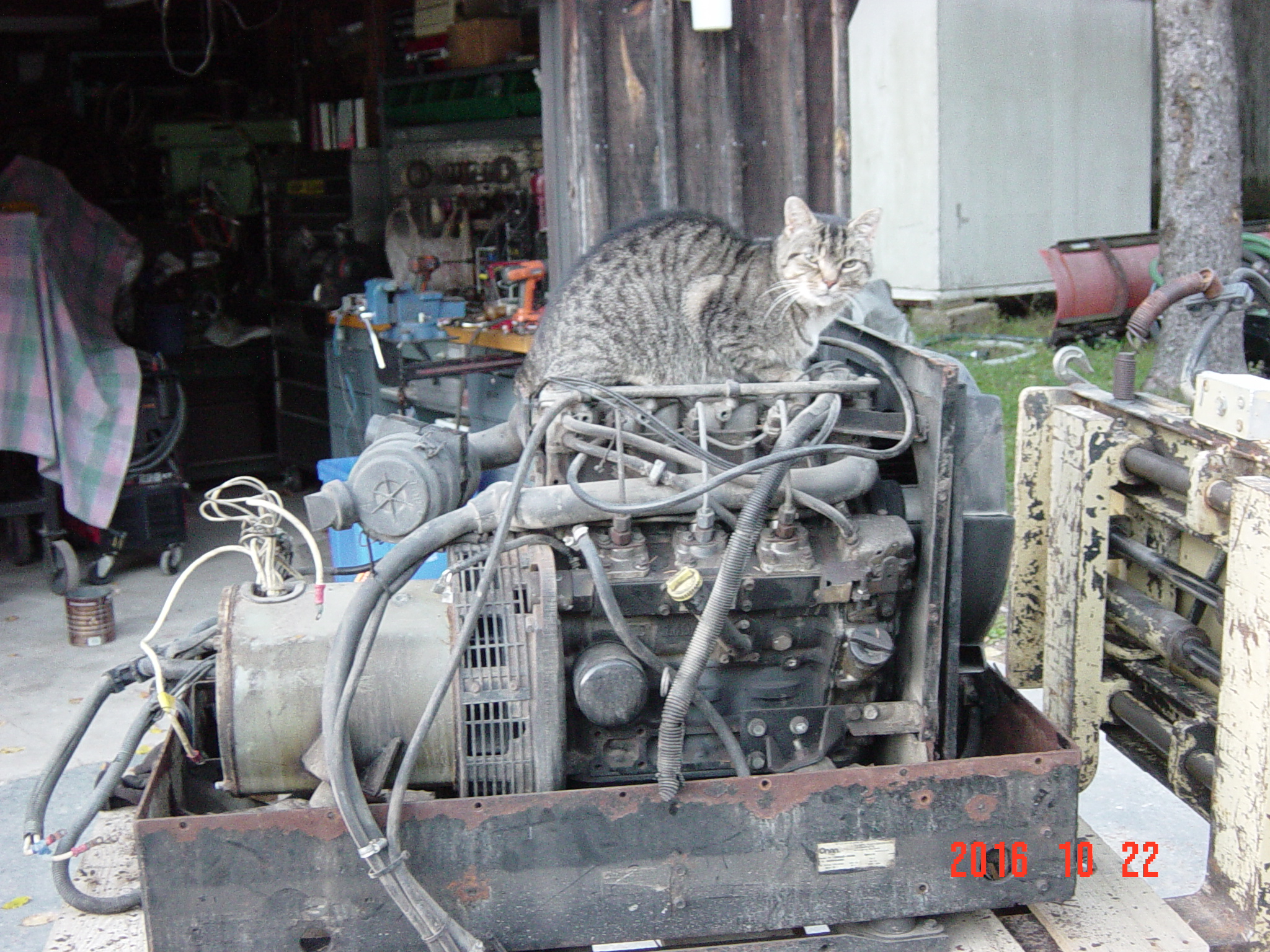

BTW, that's a nice lookin' "CAT" diesel :D ...Steve

I don't quite know which purrs nicer. That is a really sweet running Isuzu. Just a bigger and more expensive project, given the cooling requirements, than I had figured on.
