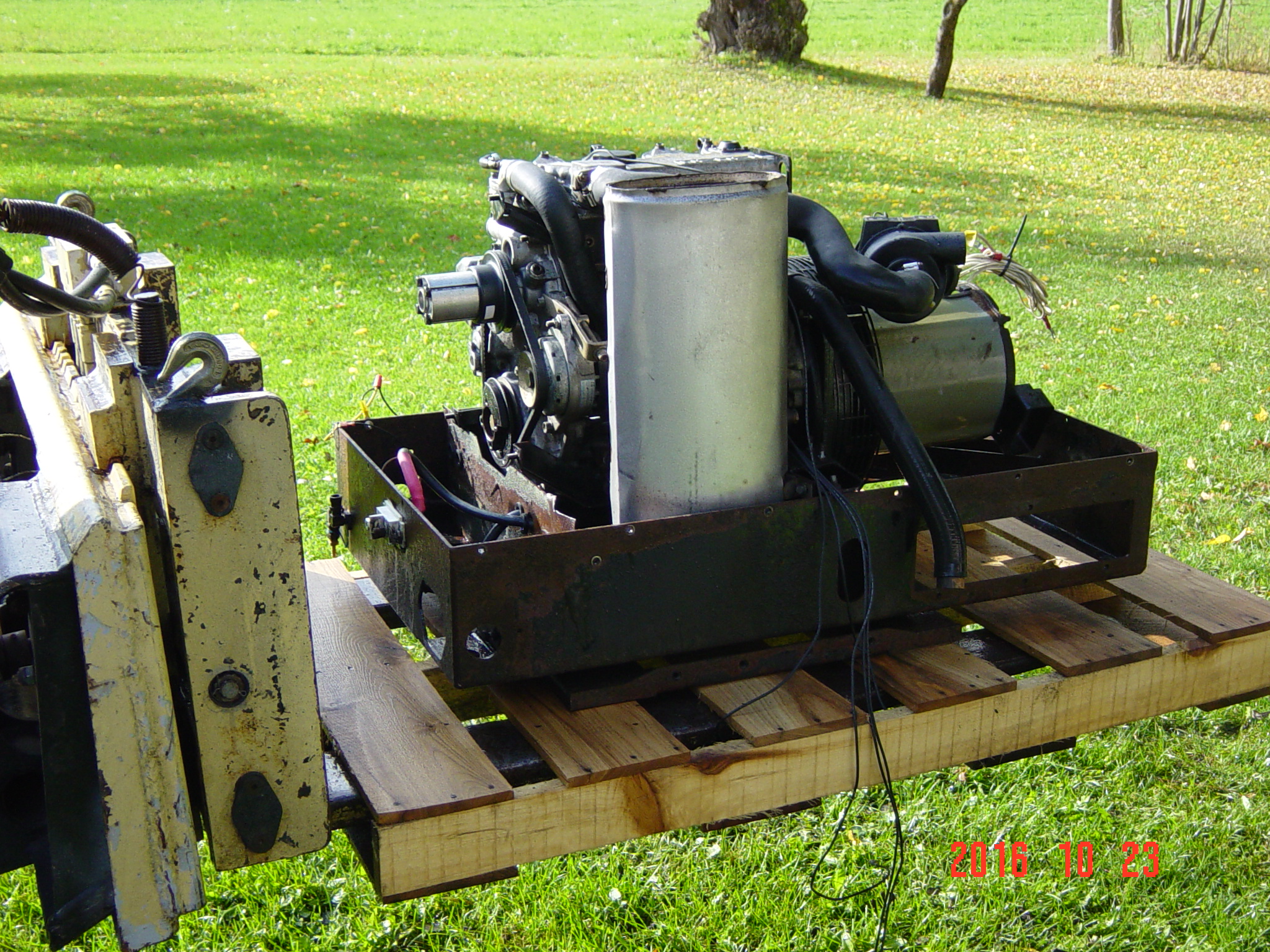

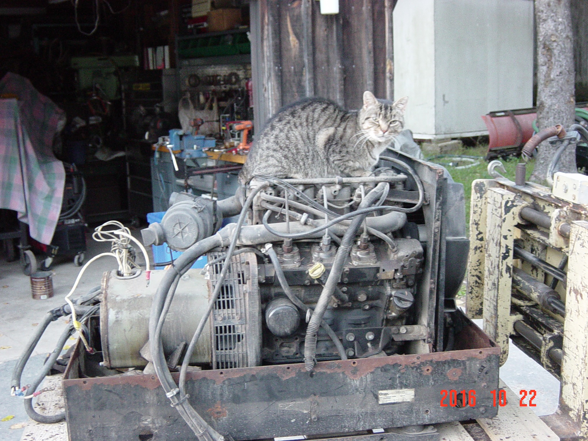

A pic of my latest project:
And after a bath:
I also realize, that I know nothing about the water jacket of an engine. I ran the engine, connected to the water faucet, and now worry about freezing. I poured in a little anti freeze, but didn't have much.

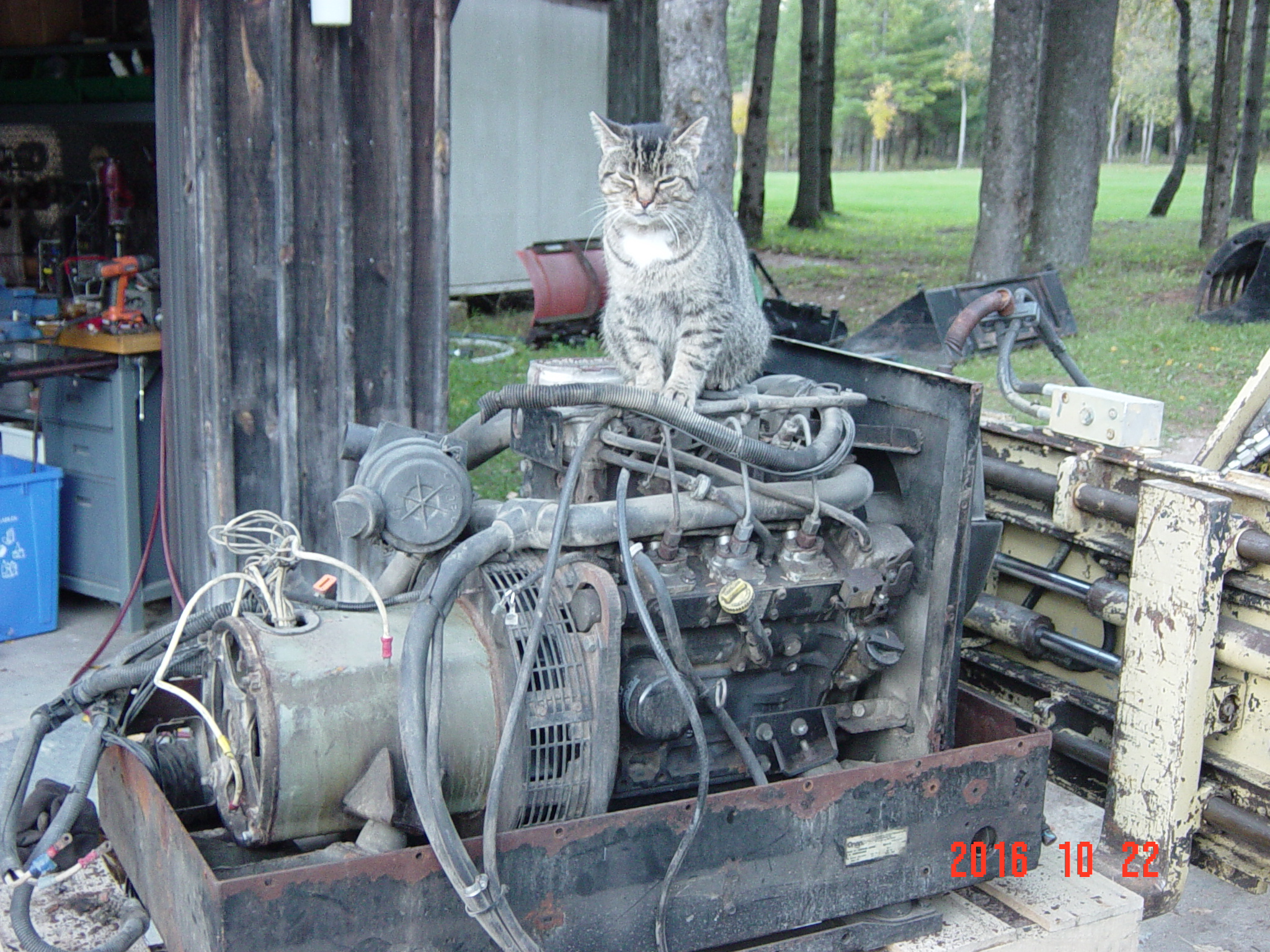

In my way of thinking, monitoring rad temperature would make more sense. When shut off, that fan would continue to run as long as that engine is hot, long after the fan has cooled the rad down.
A slightly better view of the blower. I have never seen this before.
