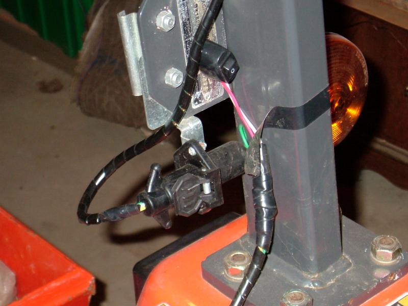

On my BX1800 I used the two wires for my lights. I didn't check with a meter to see if it was grounded, just assumed. They worked fine all last Winter. Now Junkman has me wondering so I will have to go out and check it.
You can see in this photo my hookeups. I ended up using a trailer plug set up instead of the cigarette lighter plug, but I am not using for anything but lights.

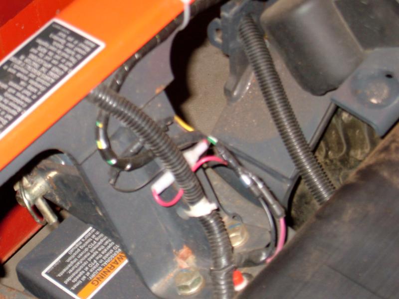

And here is the power wiring under the seat.

I used those 2 wires with a inline switch and blow a fuse when I turned the switch on. Like junkman said use the hot wire and ground to tractor and it works ok
   / Electric connections BX2200 #8
My BX2200 is a coupla years old - I used the two wires under the seat, one is hot, the other is ground - I connected them to a cigarette lighter socket and use it to power my magnetic work light and sprayer, but not at the same time.
