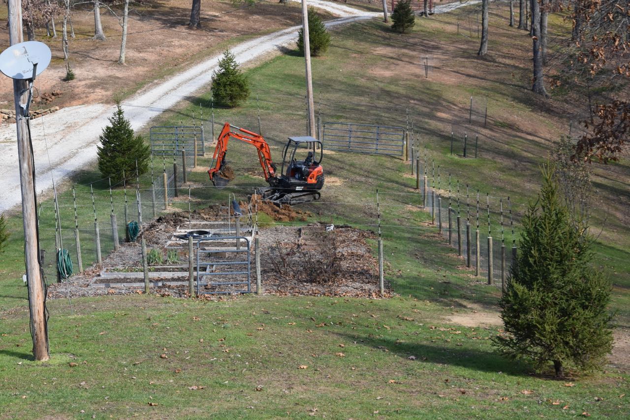

Wow - lots of info, thank you all.
I am concerned that the Deer are going to ignore the fence and that would be bad.....
We have a lot of deer problems but they seem dumb. My current garden fence is 4' of welded wire, then I stuck those cheap fiberglass push in posts into the top of my regular wooden fence and ran string (yes -string - colored survey string) between them. Did this when the garden was smaller for years and it worked, no more deer at all. I explained the garden this year and did the same thing again and it worked great again. Well now we are thinking of fencing in a bunch of trees and making an orchard - this is where we thought it maybe easier and less expensive to do an electric fence but now I am thinking it may not be. Again I am only looking at about 200 or less feet of fence so I am not wondering if I should just do it the same way and be done with it?
The night I started fencing in the new garden it got raided by deer. The fence was down for 20 hrs and they already figured it out and attacked my wife strawberries so I know I need something to keep them from Apple trees.
Here is the current fence system and the new one will be to the right
You can also see all the little oaks and ornamental trees have to be caged to protect them from the deer.
