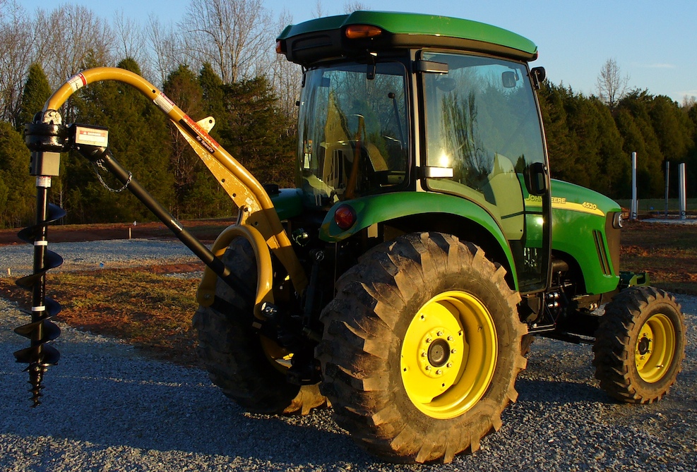

I have a JD 4520 with E-PTO. The tractor has 50 HP on the PTO at the rated engine speed. My questions is what is the HP of the PTO when I have the E-PTO engaged and am at the lower (and correct) engine speed?
Years (decades?) ago, you could get torque curves for engines (torque vs. RPM). As you gear up the PTO for the economy mode, it would have less torque. Combined with reduced engine speed that should mean less power. I suspect the answer to my question will involve wrestling with concepts of torque and horse power.
The event that has triggered this questions is I purchased a SpeeCo PHD that is rated at max PTO of 40 HP. While I normally get good quality and well matched attachments all from my JD dealer, I only need to make 36 6" holes for my next project. I'm sure there will be more holes in the future, seems like every time I use my manual post hole digger I swear it's the last time and it's not. So the PHD decision was a mix of a fit of frugality tempered with the local clay soil and not too big rocks. I am hoping that careful use will make it work and the $600 I saved will be good in the long run.
I've also used my MX6 mower with the e-PTO. It really bogs down the tractor when I engage the PTO, but my dealer says it's OK. I use it like this when I'm effectively "mowing the lawn" and it's all level surface with grass where I'm taking off 4" or so. I've also used the sickle bar in this mode and it seems to have all the power it needs. I use the MX6 in "normal" PTO mode in areas that get cut once a year, and it's great. One pass at 5 MPH and I'm done.
So there's my questions and circumstances that brought it up. TIA.

I heard back from the dealer. He said no one has ever asked that question before. He called Deere and they said that:
"The 540/'540 economy' PTO allows operators to select the engine rpm needed for their PTO application. The economy position provides 540 rpm to the PTO at approximately 70 percent of the engine's normal rated speed. Effective PTO HP in the 540E mode is 65% of the rated PTO HP. The 4520 is 50PTO HP times 65%. The effective HP rating is 32.50PTO HP."
This would also explain why the MX6 _really_ lugs down the tractor, and I have to be at 1900 RPM to start it. The PTO range on that cutter is 30 to 70 HP. So getting back to the PHD the e-PTO at 1500 RPM will probably be perfect for 6" and 9" holes. Sounds like I could use my 15 to 30 HP tiller too (width constraint is the big problem there). Because of it's name, the e-PTO sounds like a fuel saving device but in fact it can let you use a broader range of implements and let you play with PTO speed, much like the PTO speed selector on other tractor brands. The name (e-PTO) might be how you market an old trick to a the new dogs.
Steve: I remember in another post your saying that your idle speed was 1250 to 1300. Mine is 1100. The operator and service manual state it's 1100, and advises that at 600 hours you should "check low engine idle speed". Later, in the service engine section the action to take if it's off is to "see your John Deere dealer. Wonder if this ties in with your computer problems. Just FYI
I'm getting a hydraulic top link top link (ordering it today). That should leave me with only one axis to worry about.... I should be drilling my holes this weekend if the weather co-operates. Look forward to hearing how things work for you.
Pete
