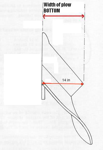

Plow size is the width of the flat bottom trench the plow cuts in the ground, not degrees or angle.
Here is a top view of a 14 inch plow, showing how to measure.

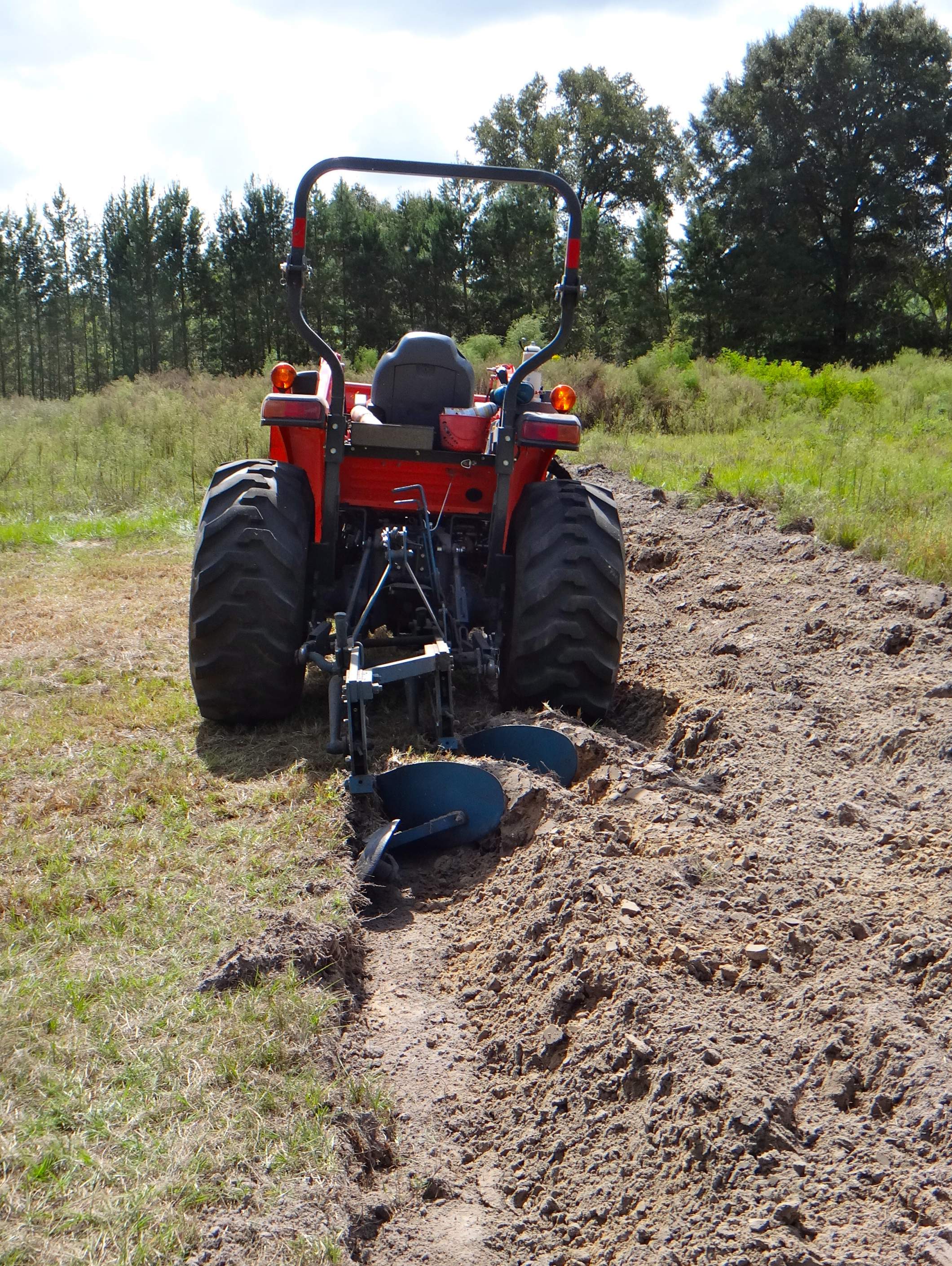

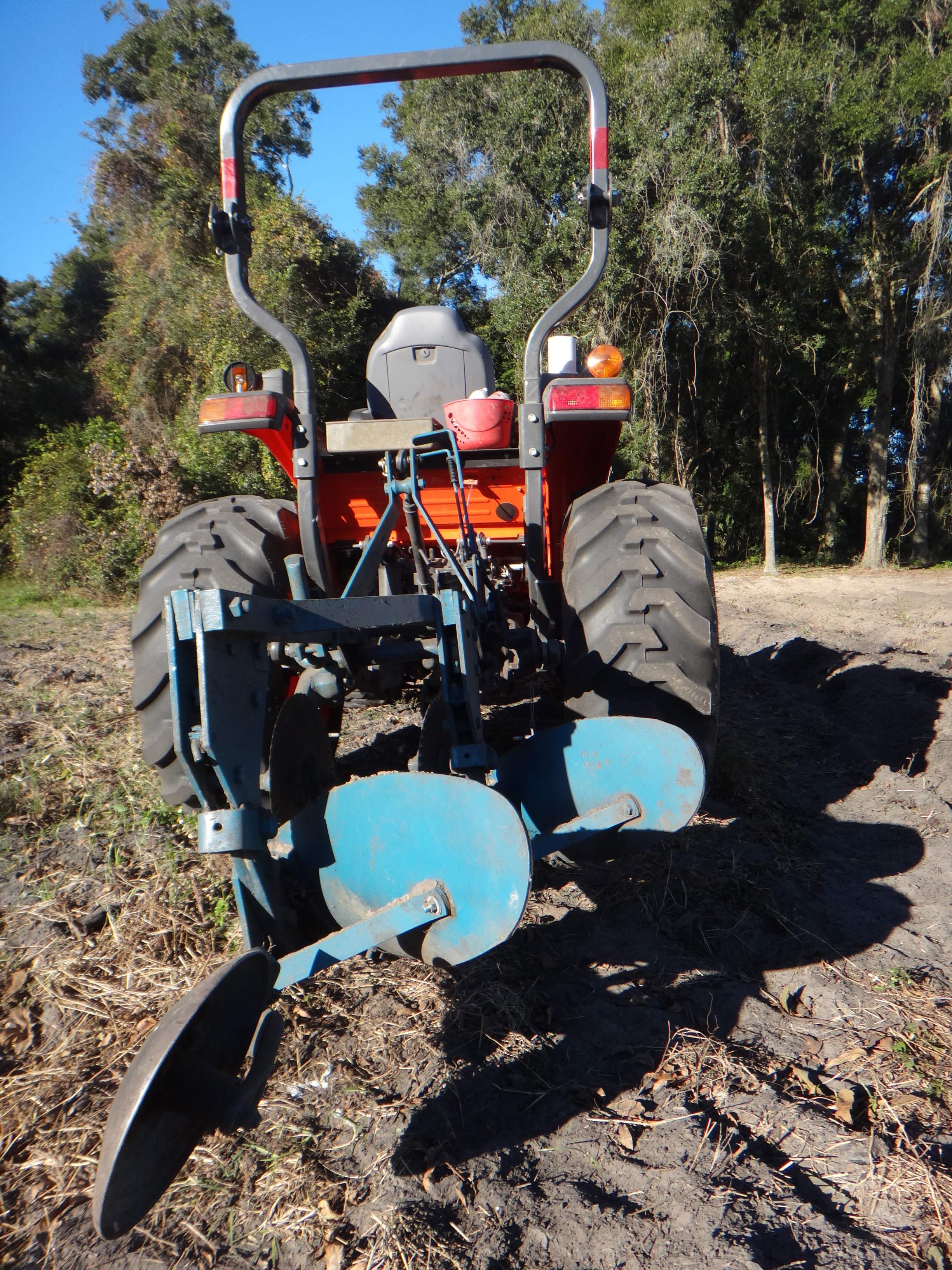

Start by reading every one of FARMWITHJUNK's plowing posts. I learned to use a Moldboard Plow following FWJ's threads in the T-B-N ARCHIVE, before I consolidated same. Your reading comprehension skill will be tested.
https://www.tractorbynet.com/forums...oard-plow-wisdom-farmwithjunk.html?highlight=
A Moldboard/Turning Plow is the classic. In Pennsylvania, with its sometimes stoney soil and slopes, Disc Plows, which tend to roll over buried rocks larger than 5" or so, and roll over some tree roots, for better or worse, seem to be used by 50% of sodbusters. Disc Plows have a much, much shorter learning curve than Moldboard Plows and turn some "soil" which would discourage Moldboard Plow users.
Disc Plows do not yield really pretty furrows. Severing tree roots is often desirable when "opening" land.

A Disc Plow is NOT a Disc Harrow.
TDP2 Series 2 & 3 Blade Disc Plows | Tufline
Disc Plow | Turf Pride USA
When plowing with anything, or roto-tilling, you must be cautious not to mix less fertile or infertile subsoil with quality Top Soil. Almost all vegetable nutrition is taken up in the upper 7" of soil.

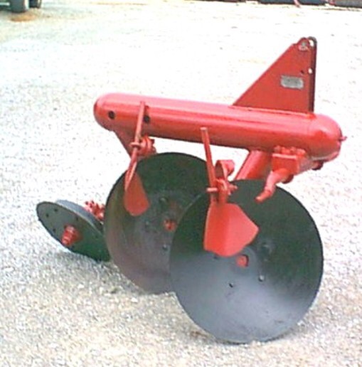

Here is a disc plow
And this is a moldboard plow

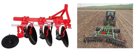

Ok - for this uneducated member, can someone post a picture of a disc harrow v.s. a disc plow?
/ Educate me on plows please #13
Plow----harrow
