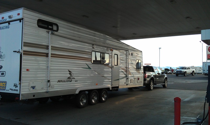

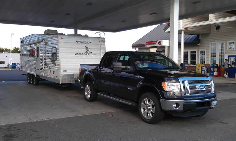

Not my truck, but this is a pretty big load. I think the guy said he got 8.5-9.0mpg. Jsut search for ecoboost tow test. It is on one of the forms.
I would say that is a honest #. That truck has 3.73 gears, can tell by the mirrors, and I would guess that trailer has 3 3,500# axles so its within its 11,300# tow rating for the Eco Boost F-150 with 3.73 gears.
