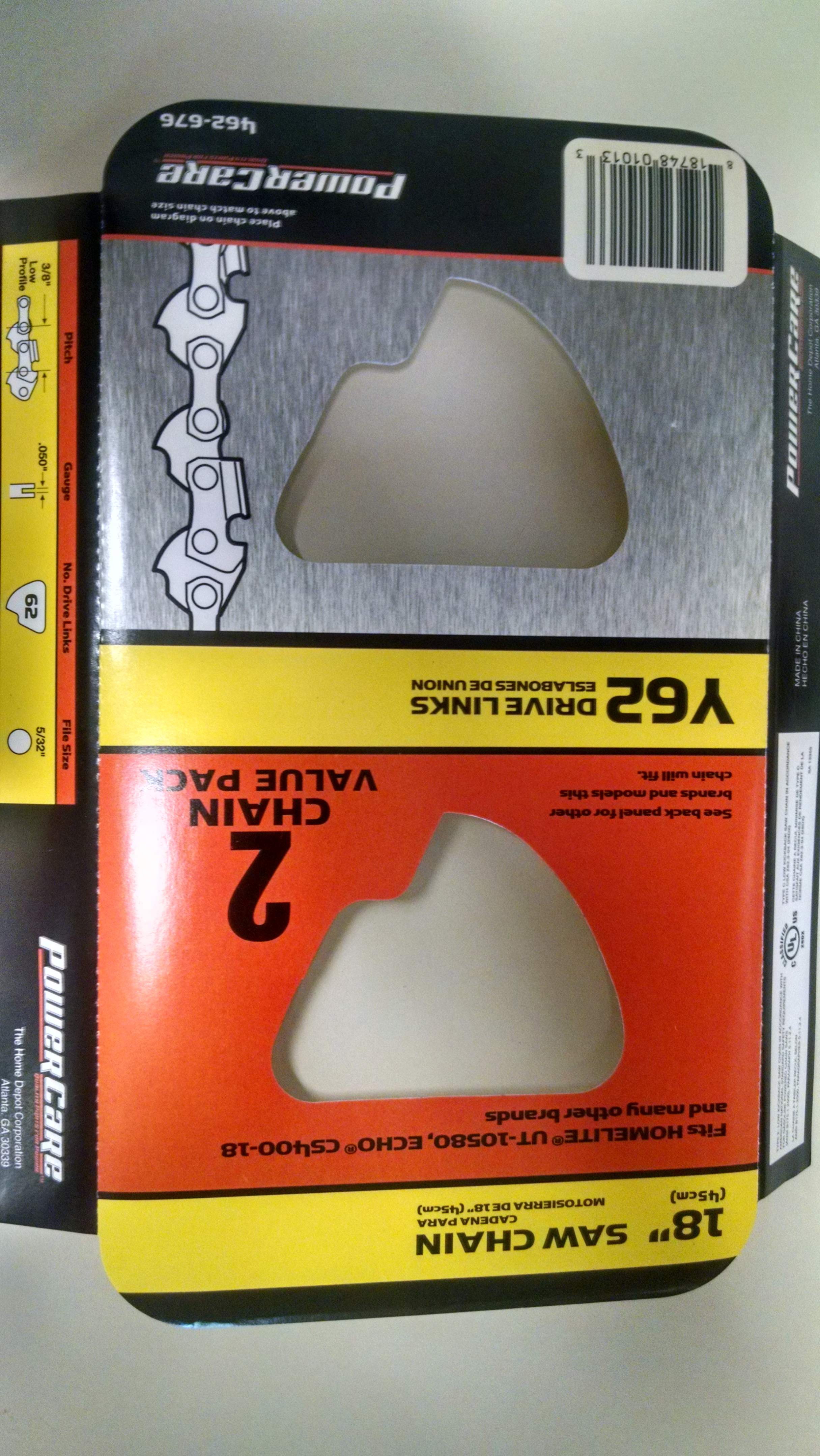

Did they sell you the right chain? Specs call for .325 pitch X .058 gauge .
This smells like winner winner chicken dinner...
Look at this pic, I believe the chains are different size, how can I tell the size? What do I do if it is wrong, go buy a different bar for that size chain?
I hate being a n00b...
David

The package the chains came in should ID the pitch and size of the chain. I would replace the chain with the one that fits the bar rather than replace the bar.

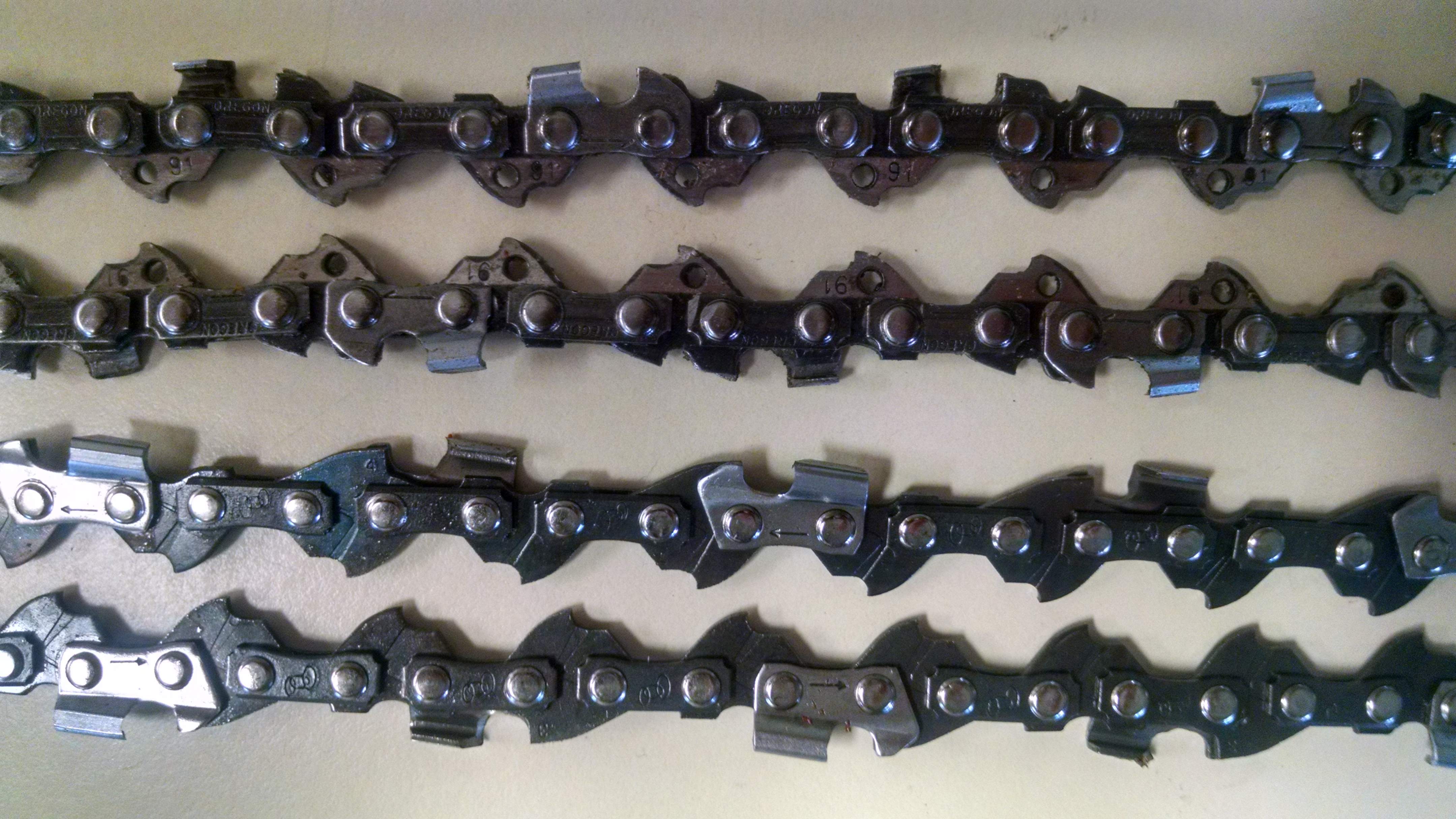

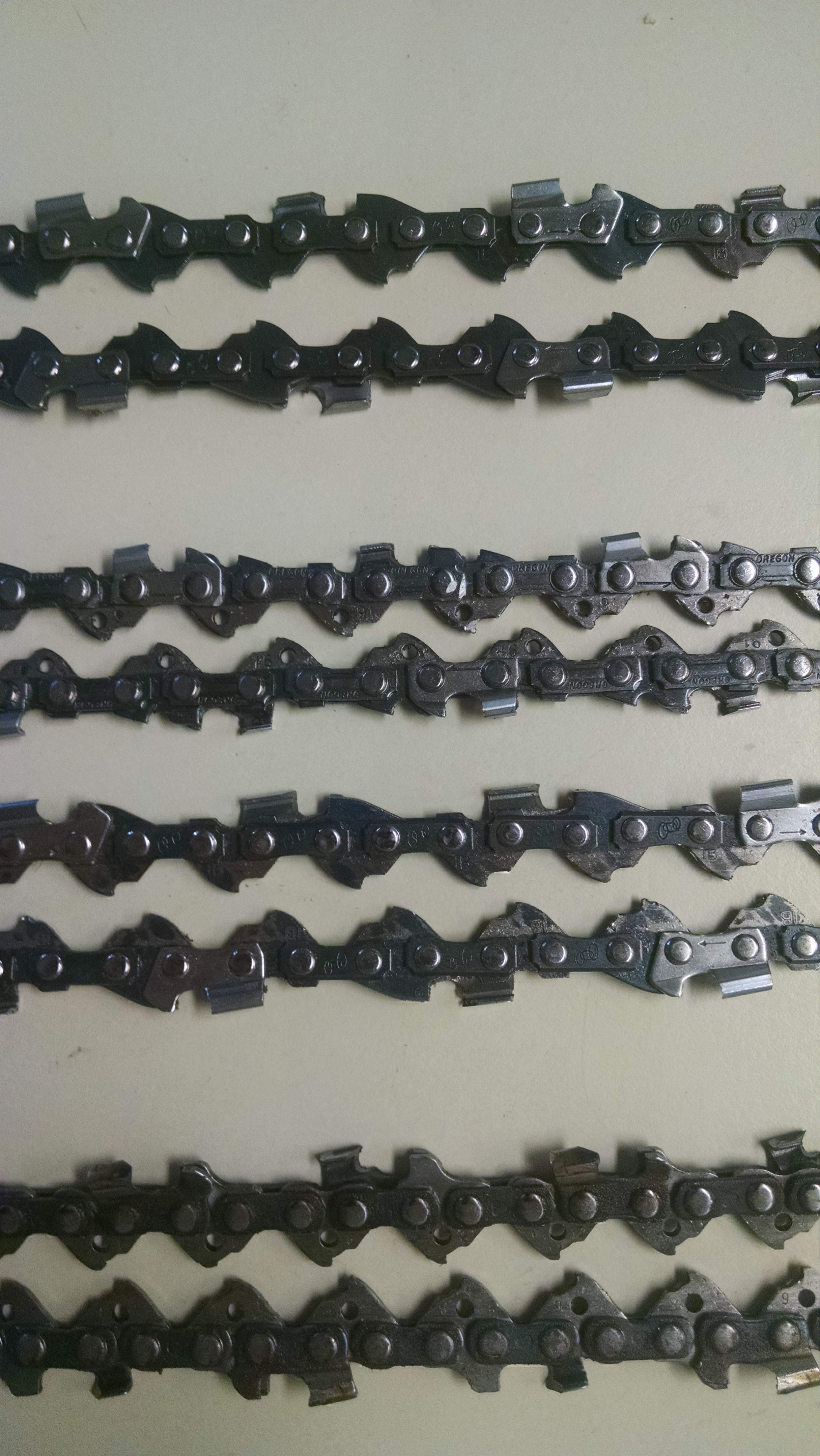

I found the paper...
It says it fits Echo 18" CS400, but the two chains from the box are bigger looking than the original Oregon chain.
In the 4 chain pic, top is still brand new, 2nd is Oregon, 3rd is the other one from the 2-pck, the bottom is off my Stihl 18" MS261 18"and it is longer/bigger...
Hmmm... I'm still confused.
David
