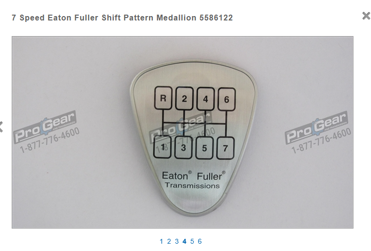

This pattern the pattern?
Above is the shift pattern for the twin countershaft heavy duty Eaton/Fuller. It requires double clutching until you get familiar enough with it to shift without clutch.
Below looks like the Spicer “EZ shift” 7 speed I had in my 94 International. This was not a twin countershaft and did not require double clutching. You shifted it like an ordinary pickup truck manual transmission.

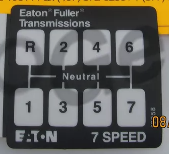

No....this pattern:
Thats a different pattern than the “straight 7”.
That has a electric shifted lo-hole switch. Never saw one.
