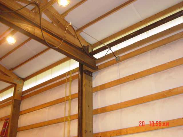

I have six posts, the four corner posts are 4-inch sch 80 pipe. The two center posts are 8 x 8 x 1/2-inch wall square tube. All setting on 12 x 12 x 1-inch plates anchored into 12-inch thick slab. I only have $3,000.00 total in that crane, including hoist, and winch for travel. Most of the steel came off construction projects. I'm lucky I must know 50 PEs that I've worked with over the years. I designed my crane, but with the help of Auto-Cad drawings and e-mail the head of the engineering department of the construction company I worked for approved every detail.

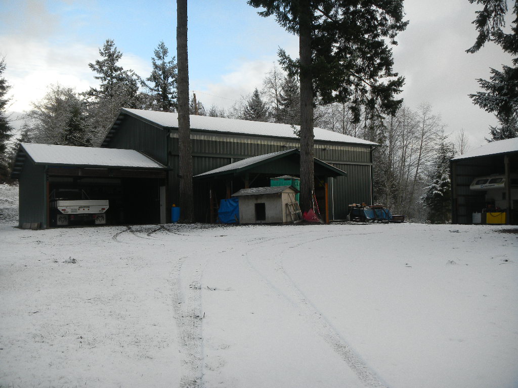

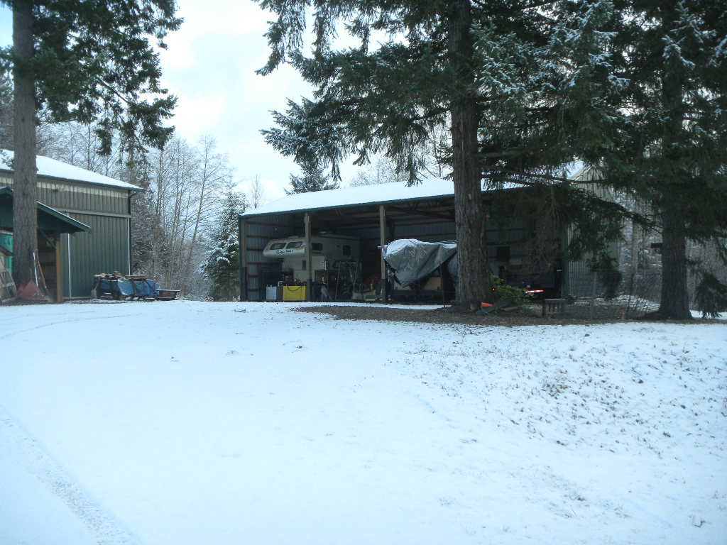

I could care less about his opinion, besides he's not a PE, he says he has an engineering degree, but never offers to help anybody. In fact he's not a professional weldor, he plays in his buddy's shop.
No my hobby shop is at my home. I'm not a professional weldor either. Use to be, but not any longer.
OH yeah??? He told me he was a PE with 30 or 40 years experience in the building trades. And yes I noticed how he didn't like to offer up any meaningful help to anyone but I just chalked that up to his desire for the self preservation of his profession. :laughing:
That's a fine looking hobby shop you have going there, must be nice. Hopefully one day I'll have my small one up and running. Right now I have all this neat stuff sitting outside with no way to use it but one day if the good Lord be willing I'll get it up to where I can work and play.
