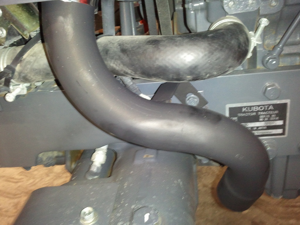

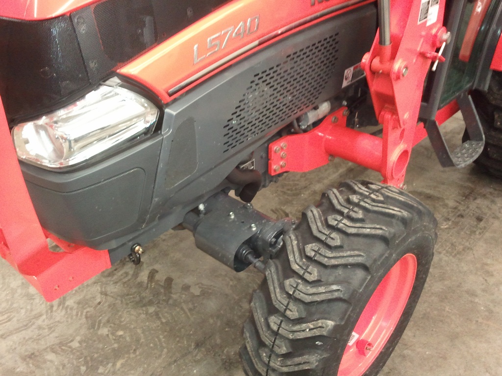

When I went to the shop yesterday, I had every intention of fabricating an exhaust stack for the L5740 like 4shorts. The guy is an inspiration. But as I pondered with my parts and pieces I began to realize that 1: I'm not really sure if I want a stack 2: I'm not really sure that I want to put that much effort into something that I'm not sure that I want in the first place.
So, I switched gears and decided to K.I.S.S. (keep it simple stupid) and while I was at it, I wanted to make it cheap, and with basic tools. Not all of us have a pipe bender, band saw, belt disc sander and a tig welder. And not all of us are close to a muffler shop. And some of us like to tinker and do things ourselves. This was relatively easy if you just take your time.
Tools used:
Cut off wheel or hacksaw
File
Air grinder
Marker
Wire welder
I have a grand total of $18.50 in this mod.
2 x 2" 90 deg elbows = $5

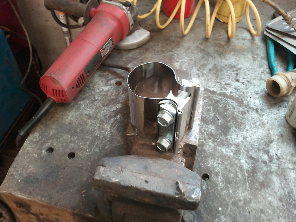

1 x 2" exhaust band clamp =$3.50
1 x can of high temp paint = $10.00

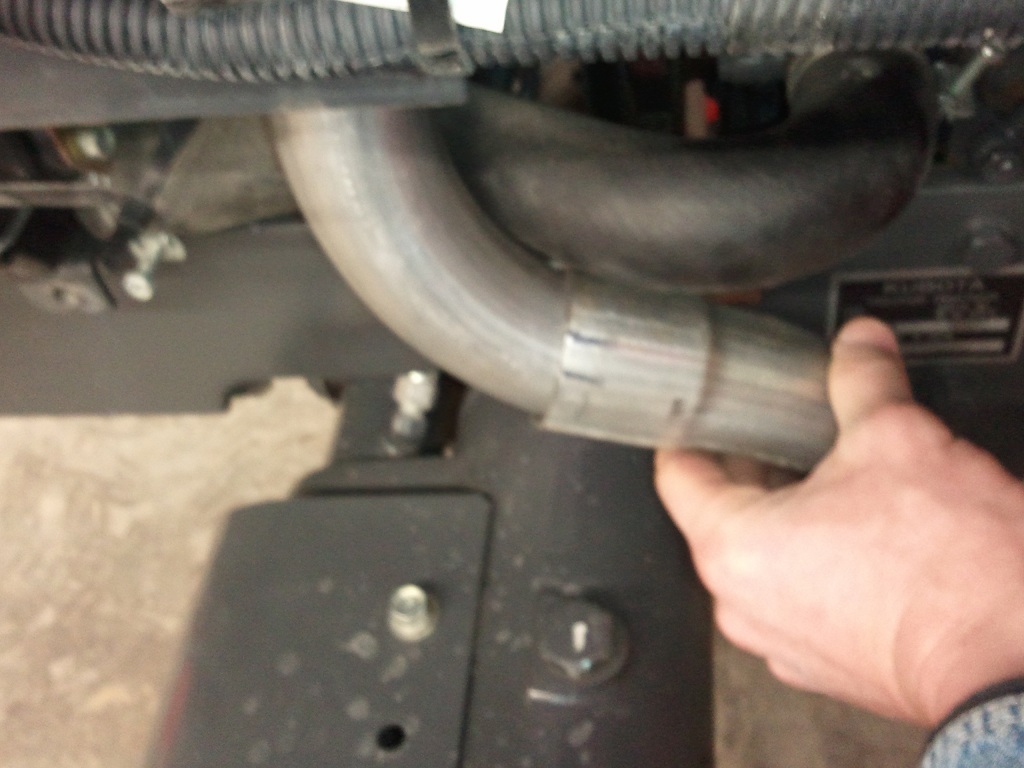

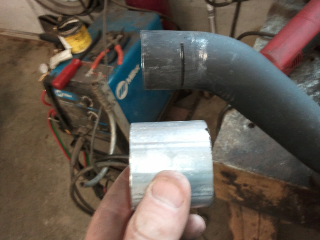

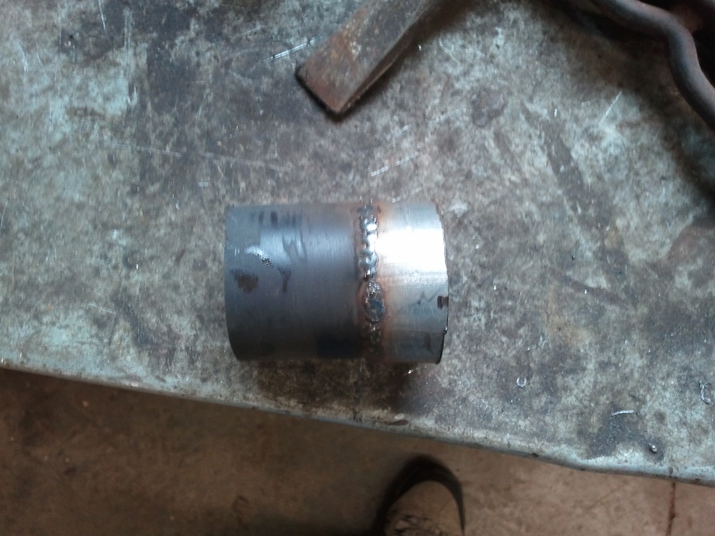

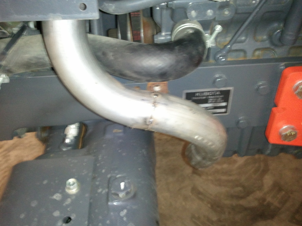

I started by marking the exhaust at the bottom of the panel so I knew how much room I had to hide my joint. Then removed the exhaust and used one of the elbows to mark where I needed to make the cut. Once the cut was made I loosely reinstalled the exhaust so I could start figuring out my pieces.

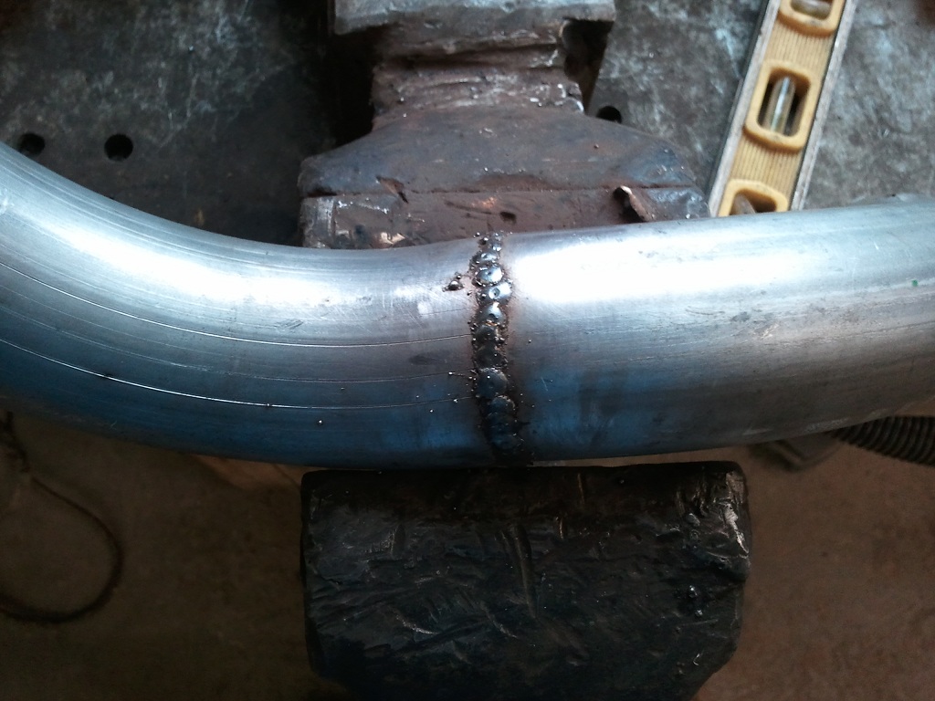

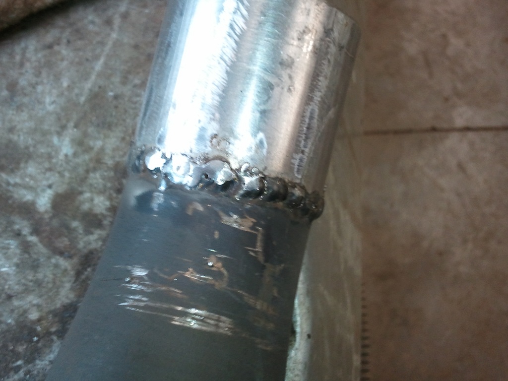

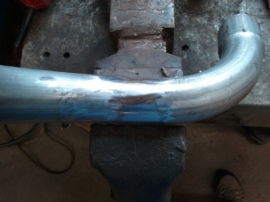

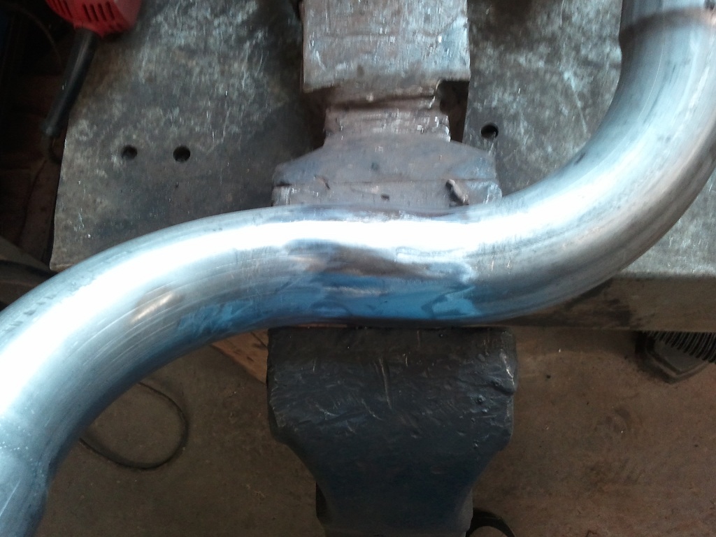

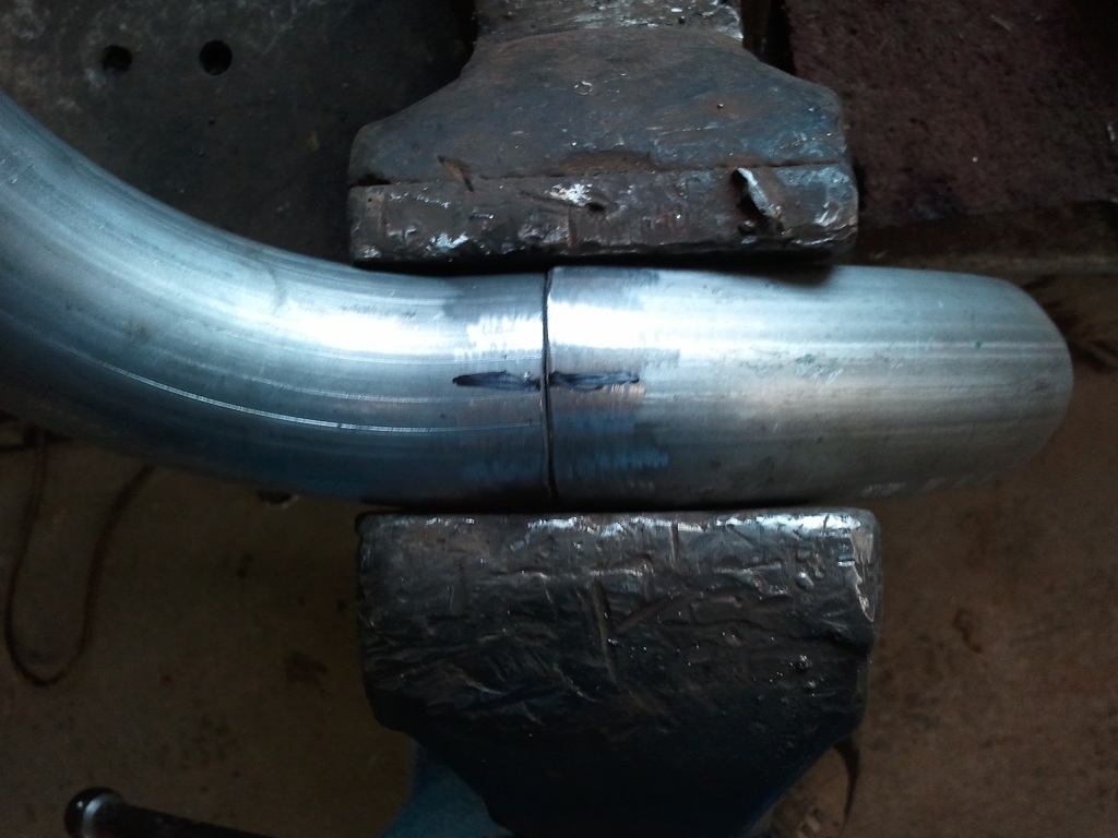

I decided that I wanted a cleaner look than the slip joint so I butt welded my pieces together once I figured where I wanted them. I suggest using a couple of pieces of scrap first to practice on and get you welder dialed in. Also make your joint as flush as possible with no gaps. This is where you want to take your time on the prep and weld. Tack, moving all around the pipe to control your heat so you don't burn through or distort until all of your tacks are joined.

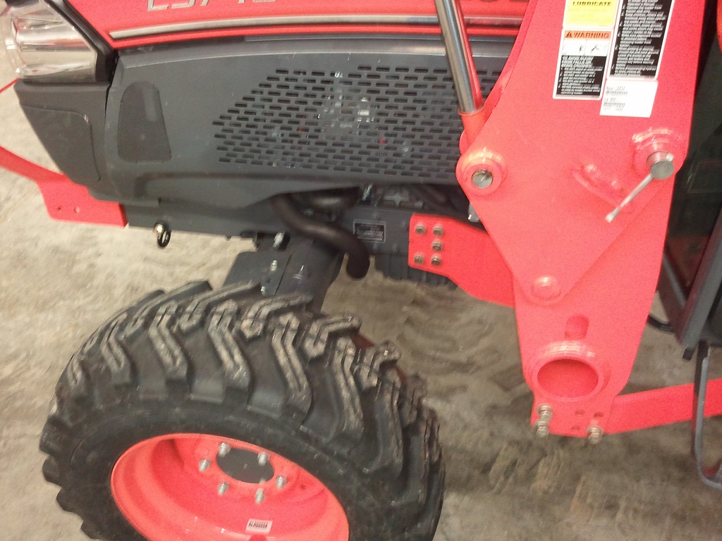

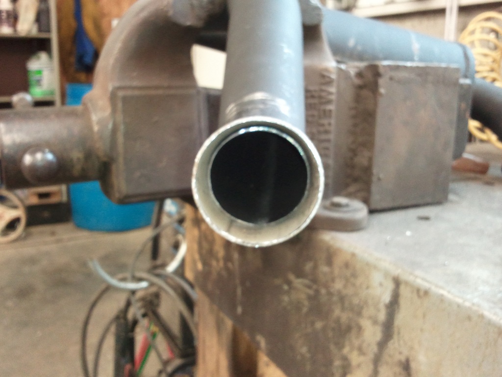

Then I ground the joint smooth and refitted to the factory exhaust. Now, 2" is just slightly bigger than the factory exhaust, so the the clamp won't seal if you don't weld on an adapter. i.e. a piece of the 2" that I cut off an elbow. Just like before I tacked the adapter on with one exception, the 2" will slip over the factory piece making it easier to weld.

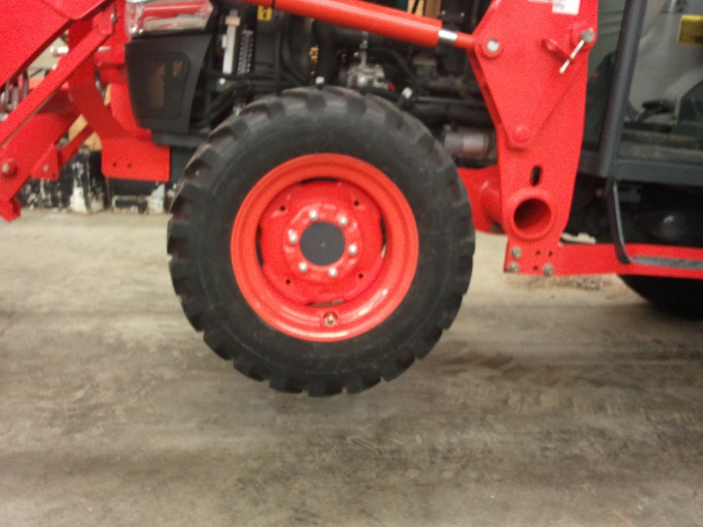

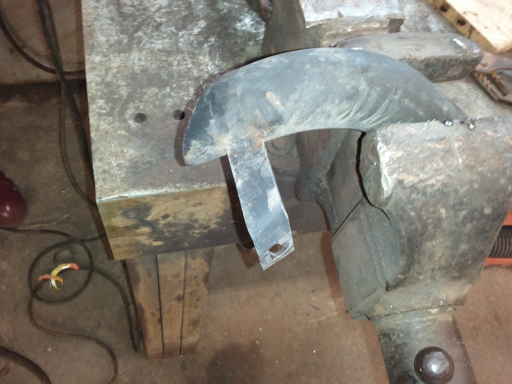

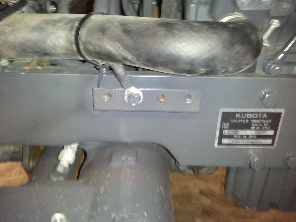

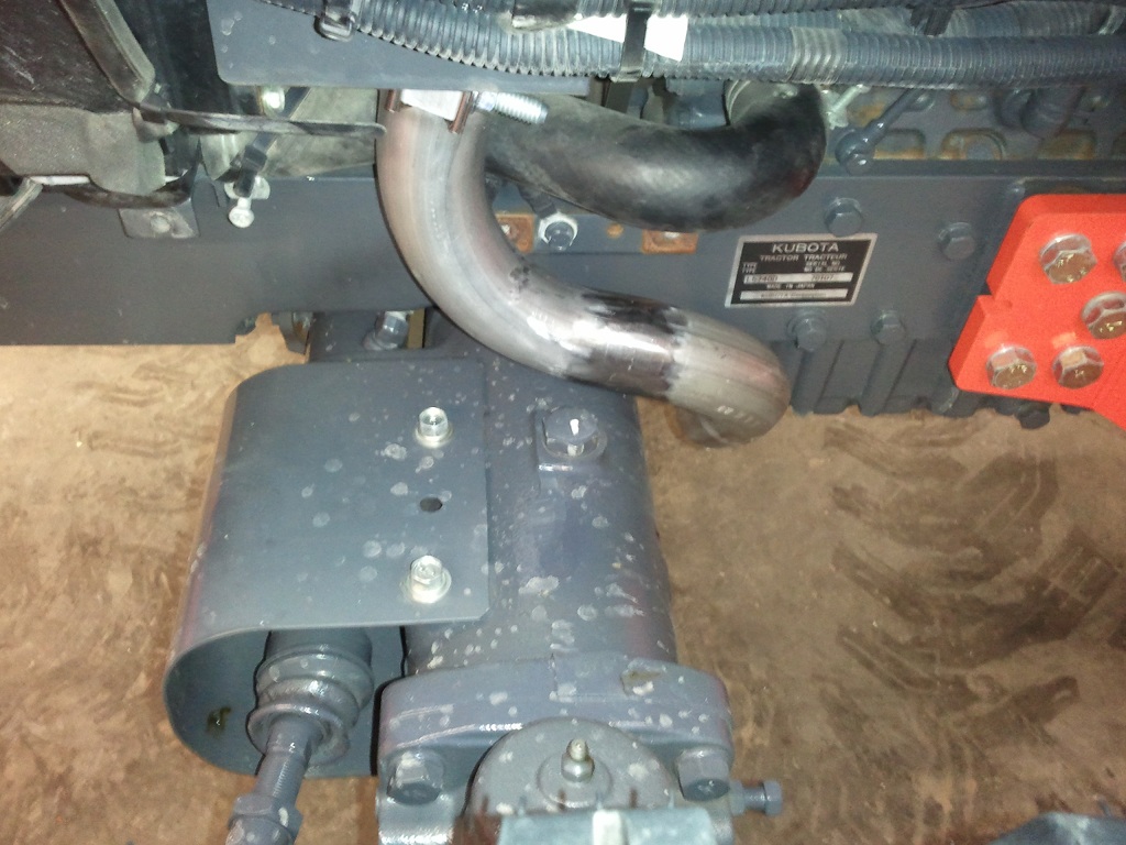

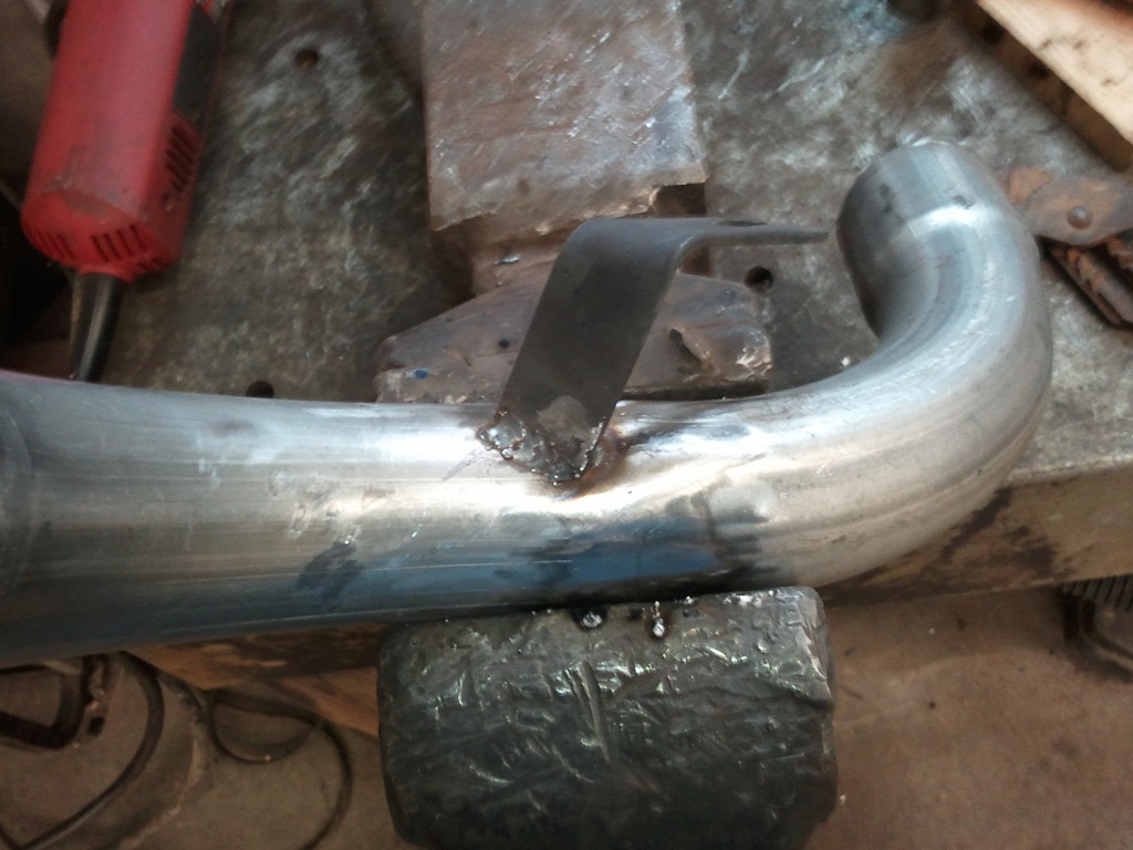

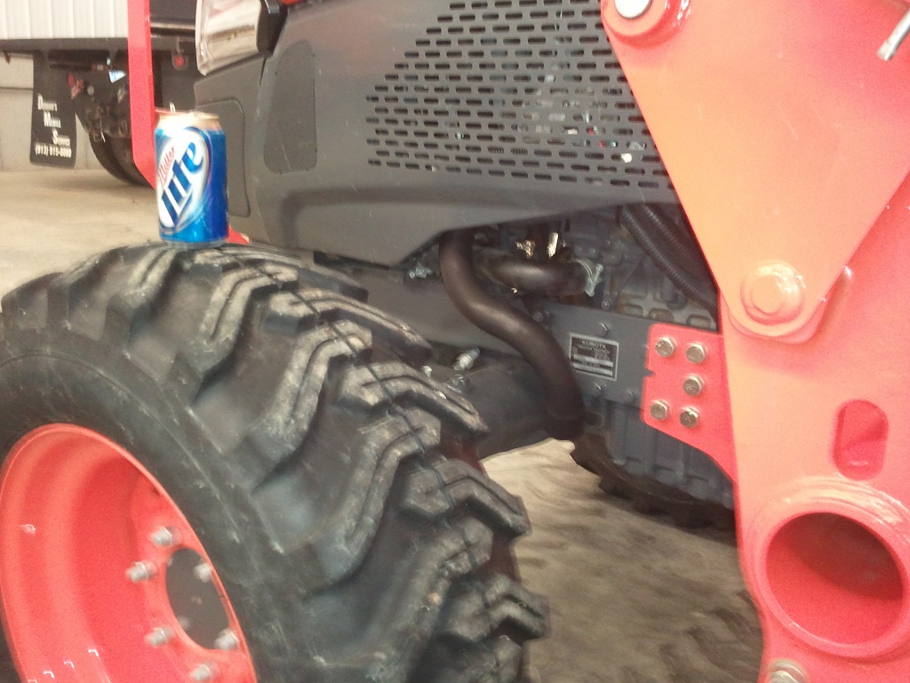

I re-purposed the factory mount by cutting it off the stock exhaust and welding it to my new piece. Finally I painted my new piece and while I was at it and had a $10 can of paint, touched up the factory piece, muffler and all. I had to remove the little shield for the lower radiator hose. I figured if something poked through the exhaust and got to the rad hose, I probably had bigger problems. When I removed the shield, there was a little rust between it and the frame, so I touched that up as well with a little Kubota dark grey. My goal of getting the soot off the FEL was met as well as, showing that with a little time and some simple tools, you can make a functional modification without breaking the bank.

Had to make sure the axle would clear when articulated up on that side.

Last step. Have a cold one and be proud of your work.:thumbsup:

   / Easy, low buck, exhaust mod to eliminate soot on FEL #3
I have always wondered how well those tractors with the exhaust coming out the side worked. Let us know if you get diesel exhaust fumes in your cab from the discharge being below and if front of the operator platform, I thought that might be a problem.
A lot of other TBN'rs have made a similar mod with no fumes in the cab. 4shorts originally did something similar on his L5240 except he ran it in front of the axle. Now he made the stack on the L5740, primarily for aesthetics. So we'll see. I can remove it in 2 min. if it doesn't work out, and do something different. I'll be sure to keep everyone posted. :thumbsup:

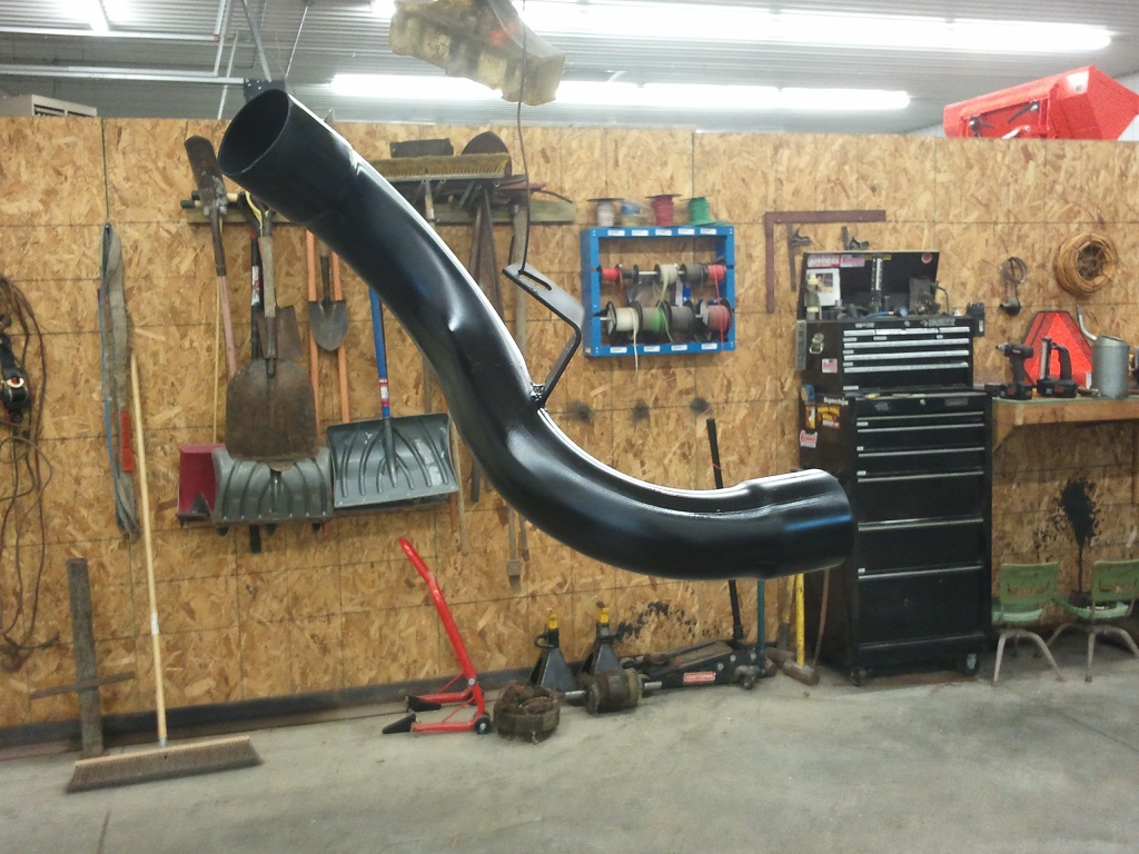

Yep that's close to the way I did it on my 4240 and as I mentioned in the original thread it was my intention to do the stack but went with the extension at that time due to the work it would take to do a stack conversion but after a winter using it I realized it still wasn't what I needed. It really wasnt for just the aesthetics. It was because the extension I did just didn't please me.
The extension kept the soot off the FEL OK but when the door was opened I could smell the exhaust so that's why when I got the 5740 I said it was getting the stack. It did take two full days to do it and it took some planning and a pile of tooling but after trying both ways I'm glad I did the stack conversion.
Here's my original threads for the extension and the stack conversion. Nice job you've done there. Hope it works out for your needs.

I never smelled anything until the door opened. The problem is that you and I have the 3rd function set up on the right side of the tractors so that door don't get used at all (not by me anyway) so when ever I'd open the left door to get out or to talk to a customer I'd smell that exhaust. Now to tell the truth it wasn't to the point where it happened all the time but my point is that it did happen and it happened often.
When the 5740 arrived I told myself I'm not taking anymore short cuts with the exhaust and went on to do it the way I intended to do it on the 4240 and the only regret I have is not doing it on the 4240. I really didn't add the stack for looks. I was even pondering putting the exhaust out the back but then I figured I'd get soot on the blower :mad:.
The stack conversion is the second best mod on the tractor. It's practical, I don't even notice the stack in it's location and it's safe, I don't smell any fumes and I like it that way :D
Well, so far, I have tried to "smoke myself out" by having the cab door open and bumping the throttle inside the shop. I didn't smell anything until I got out and walked to the front of the tractor. I then turned on my 72" exhaust fan and cleared out the shop.:D The fan wants suck the garage doors in if you don't open some of them. :thumbsup:
