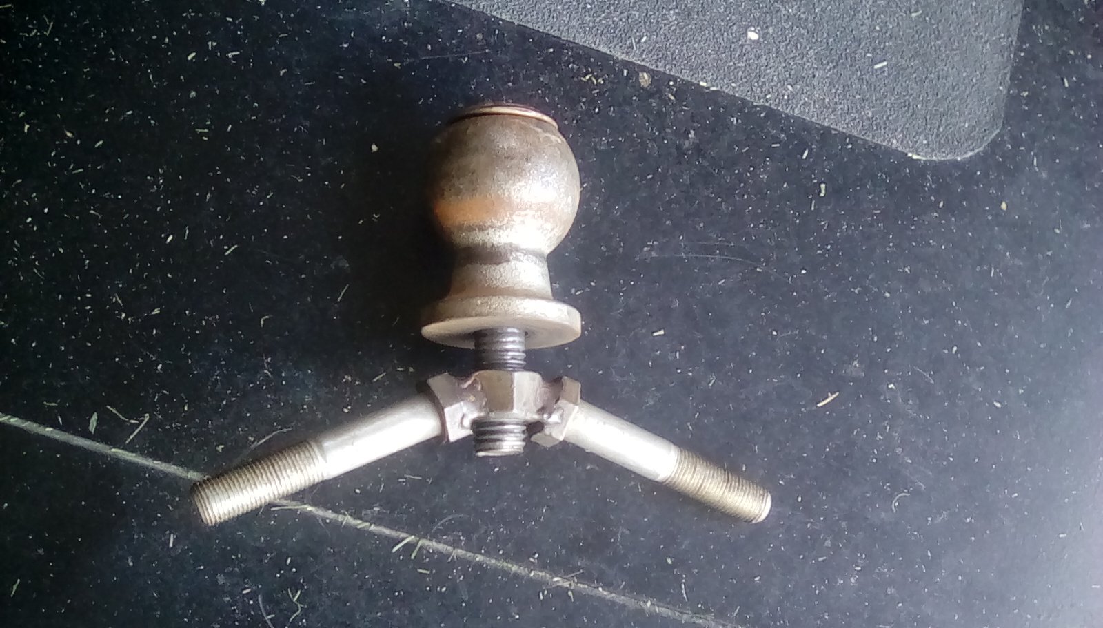

I have a TC45 w 2-5/16 hitch on my drawbar.
I want to also be able to pull my splitter which has a smaller ball. I need an inexpensive way to switch hitch balls back and forth that preferably does not involve busting the hitch ball nut with an impact every time.

I did something like this.
Only to to used around the woods or yard.. NOT HIGHWAY...
I'm going to get scolded how unsafe it is but works for me..

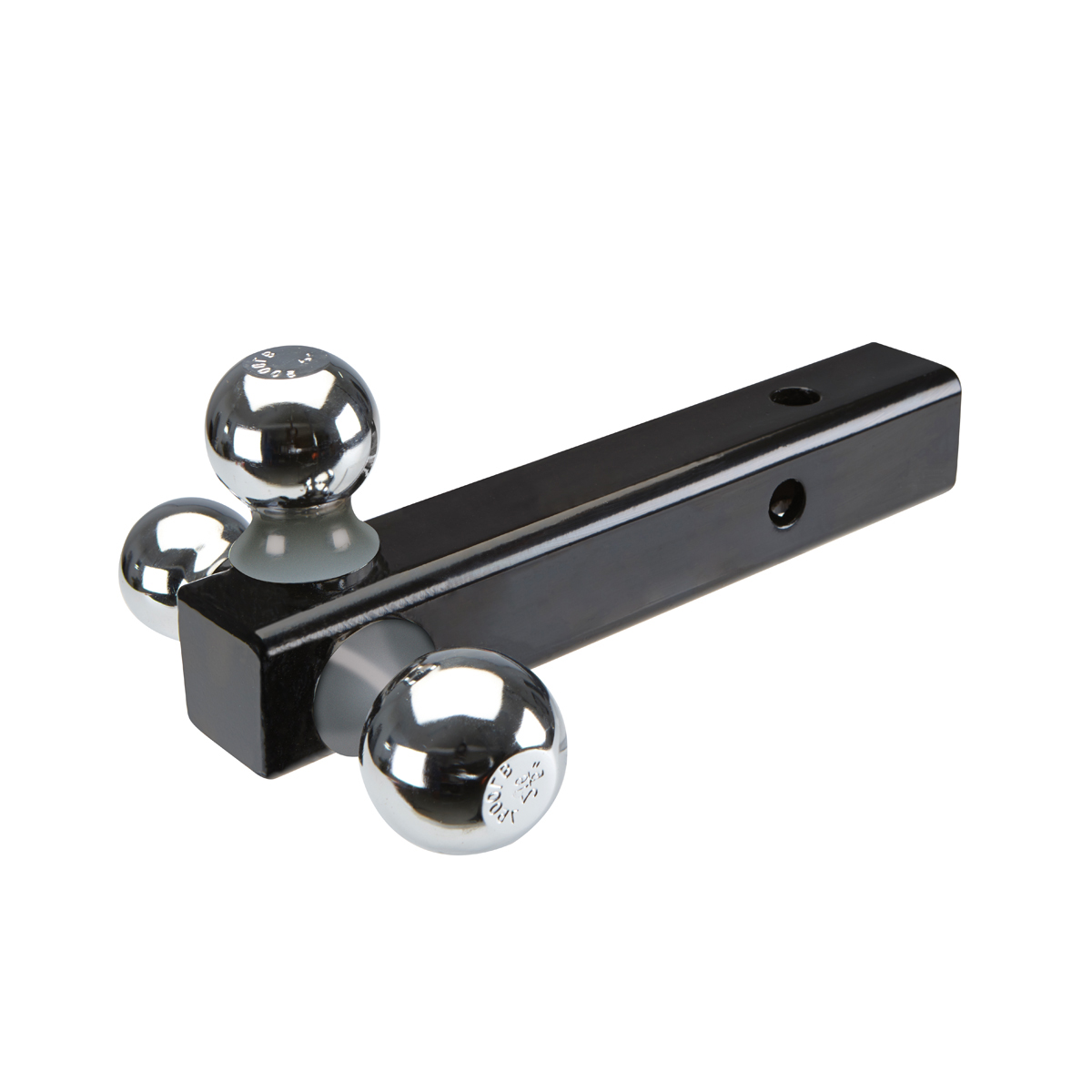

I'd figure out how to pin a triple ball hitch to your drawbar. Maybe get one of theses and add a hole on the two axis to match your drawbar holes.

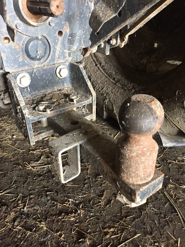

I had a similar type of hitch I welded a short receiver tube to the bar stock to enable using different hitches.

Get a hitch receiver frame for your 3-point hitch. It is loads easier to use than dealing with the fixed drawbar and has a standard receiver tube that you can use to swap out draw bars or rotate a 3-ball setup. Once you get used to hitching up this way (back up to trailer and lift the 3-pt from your seat) you’ll never go back to the old way.
You're not supposed to pull trailers from the 3pt hitch. You're supposed to pull trailers from the drawbar. Yeah, I know most people don't and never have a problem. Just sayin.

^^ I had to go that route. The trailer ball mount was far too low and there was no way to raise it or add a receiver hitch without getting in the way of the PTO and other things. I tried several different ways and nothing worked.
I don't try to pull big trailers though, just the splitter and a small utility trailer.
The OP is interested in pulling a woodsplitter,, not a Fruehauf 53 foot reefer full of ribeyes ,,,
Heck, he could almost hold the hitch in his hands to move the splitter,, the 3 point should be fine,,,
