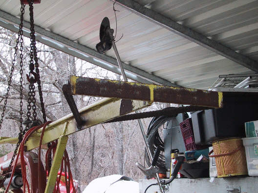

That's a good looking gate. I didn't know that you were an artist too. It looks like you built a good attachment for the PHD. One thing I found out was that over time all that weight swinging around on the end of the arm will fatigue the metal and it will eventually bend unless you reinforce it. Tonight I will post a picture of the final state of mine with the extra bracing that I added after it bent. It would have been much easier to brace it before it bent.

I was only able to get one picture today because my camera battery died and the spare was dead too. This is the bracing I added for the weight hanger. My weights slip on from the top so this works for me but with your style weights, this obviously won't work. Where the paint is missing is where the arm bent. I have to admit that this bend was caused by a stuborn oak tree that did not move out of my way. The real stress is at the other end of the arm. You can barely see the triangular bracing I added there. That end bent while I was digging a hole.

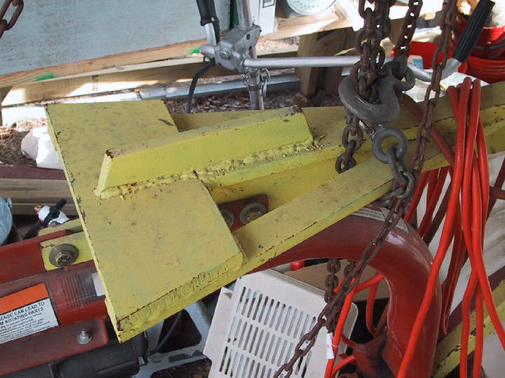

Harv, I have attached the picture of the other end of my attachment showing the bracing I had to add after the bar fatigued and bent. That's 3/4" steel. I originally welded on the 3/4" bar on the top of the lever arm but it bent behind where this bar stopped so I added the triangular brace.

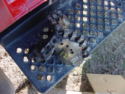

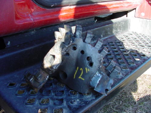

Here's a photo of the DP twelve inch auger head.

Another.
I'll make an auger for it tonight probably. I'll be able to see how it goes tomorrow when I hopefully start drilling about two hundred holes.
It looks like it won't need much down pressure and you almost hurt inside for all the utilities down the road that will feel it's touch. /forums/images/graemlins/confused.gif
