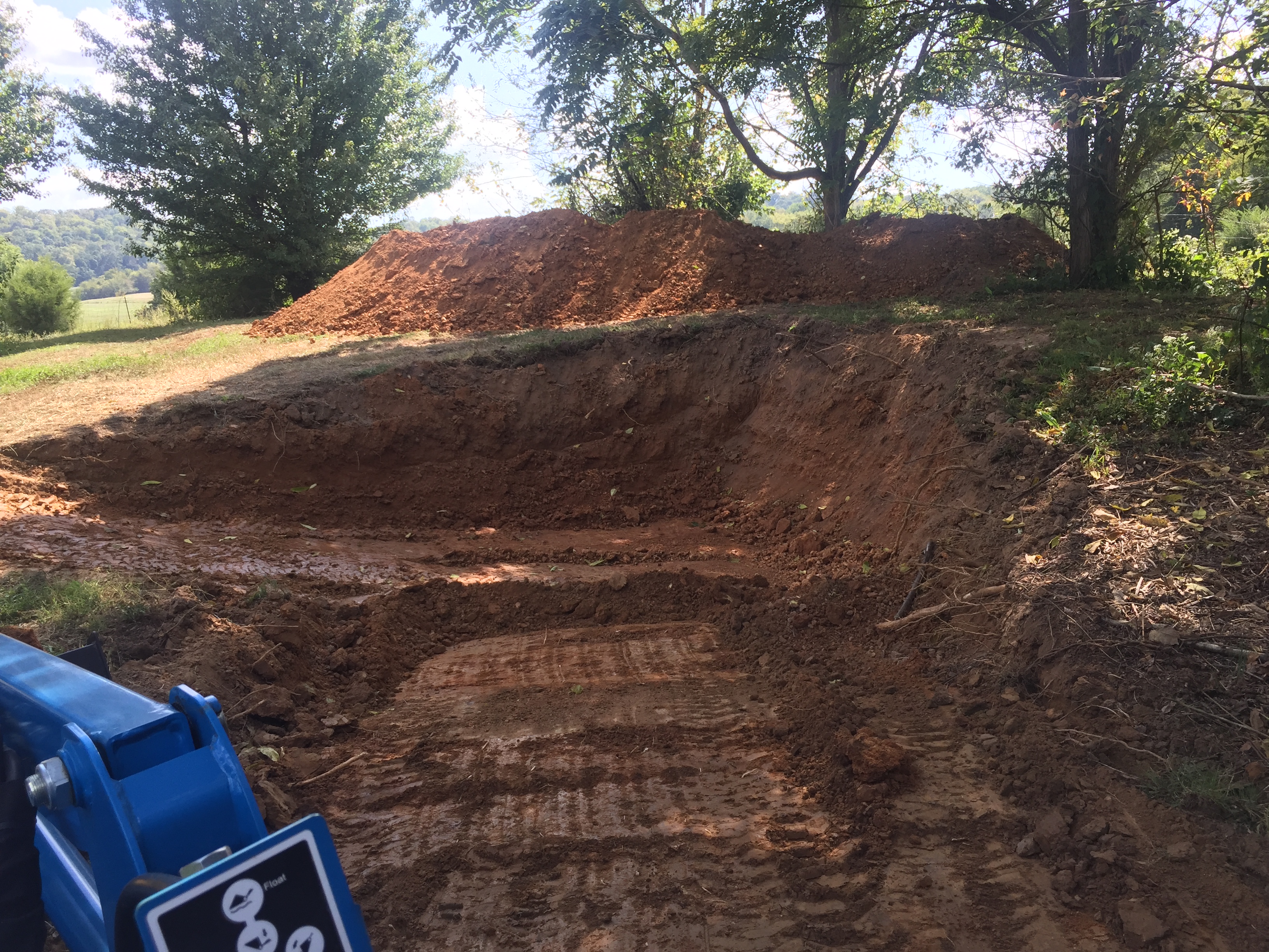

I have an boom/auger I use quite often, I think off hand it's a 6".
I have buried it to the gearbox before by accident and it was a booger to get out " was thinking a reversible pto would have been nice ".
I use it often, a backhoe would be nice to have on occasion.
I been using the bucket instead!
