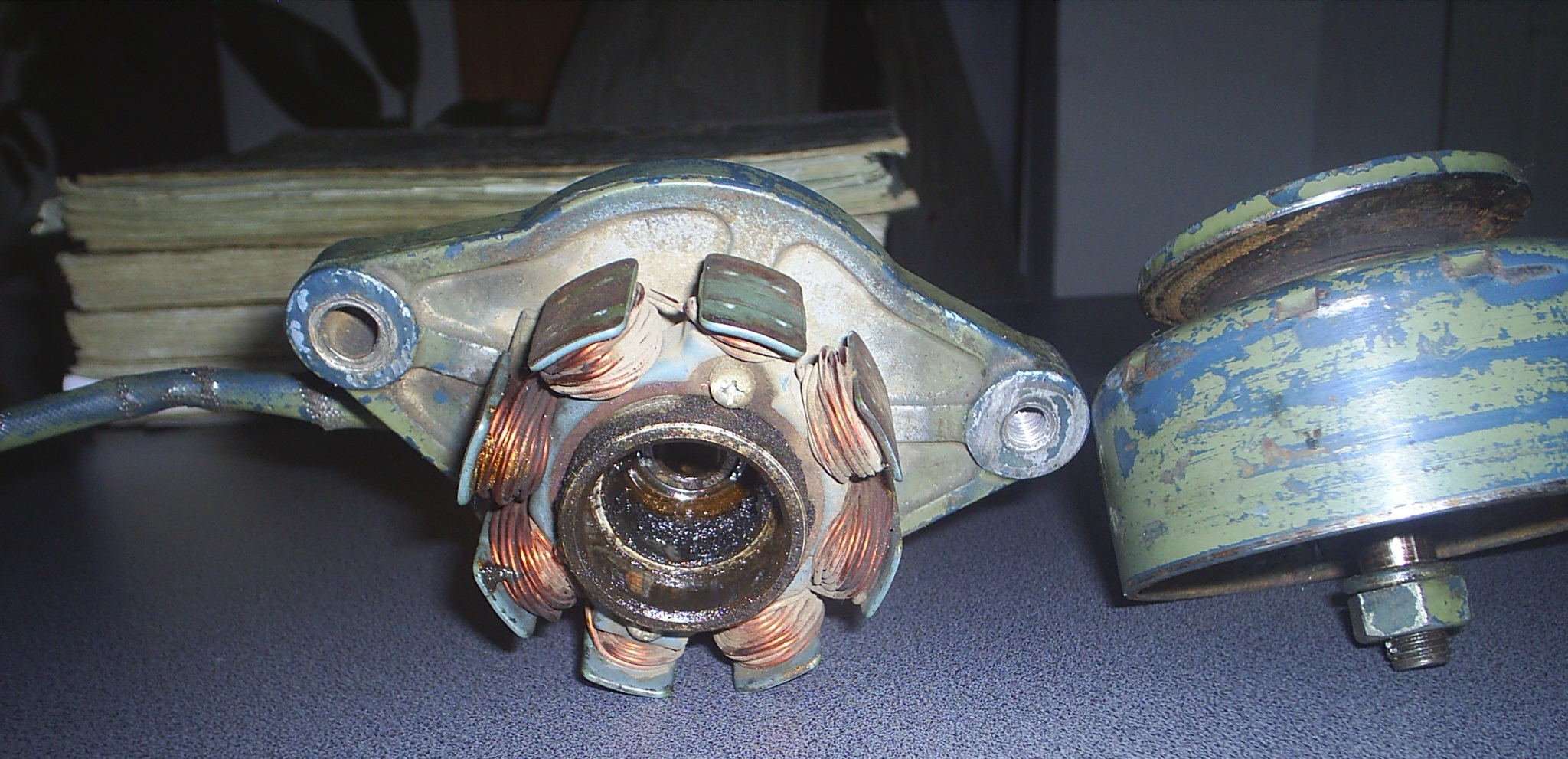

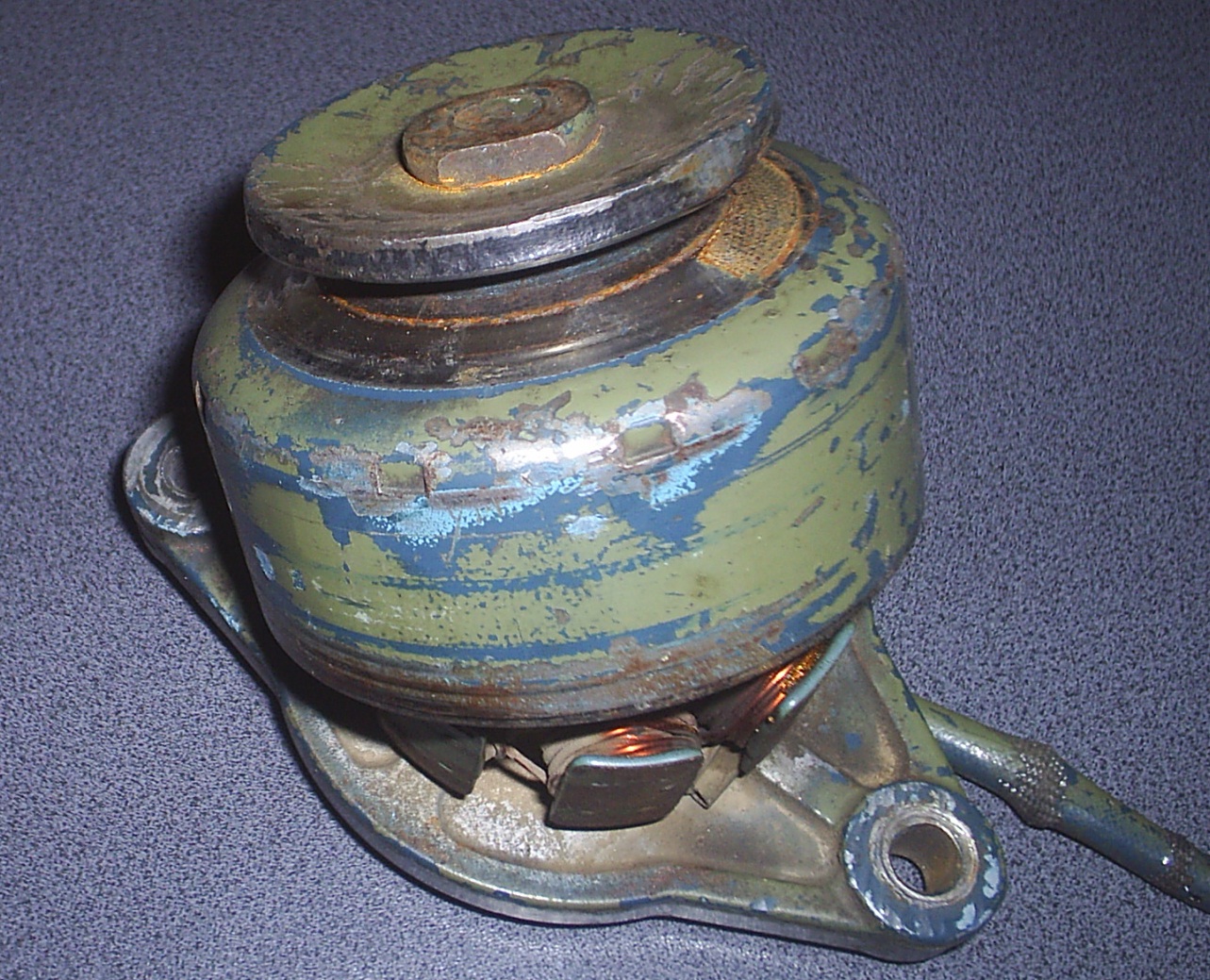

I have a Kubota B1600DT (16 HP-pto output power, 20 HP-engine output
drive: 4WD, 3 cylinder, engine model: D950, in fact 927 cc, the latest year o manufacture 1982). The ball bearing ,-see attachment- inside the alternator ("dynamo"-in part manual book) body is broken and destroyed the permanent magnet. I've replaced the bearing, but I don't have a solution for the magnet. In fact this part is called "FLYWHEEL DYNAMO" -the rotor in fact- and has on interior side the permanent magnet (see pictures attached). Has anybody an idea how to replace this magnet inside the rotor ?. From my knowlwdge this electric generator give out 12V, and 18 Amp.
Thanks !

Thank You Jim. The dynamo don't charge the battery. It is dead. As you can see in the pictures attached the magnet is destroyed. Please give me that older threads/links, or some an alternative solution... :thumbsup:
