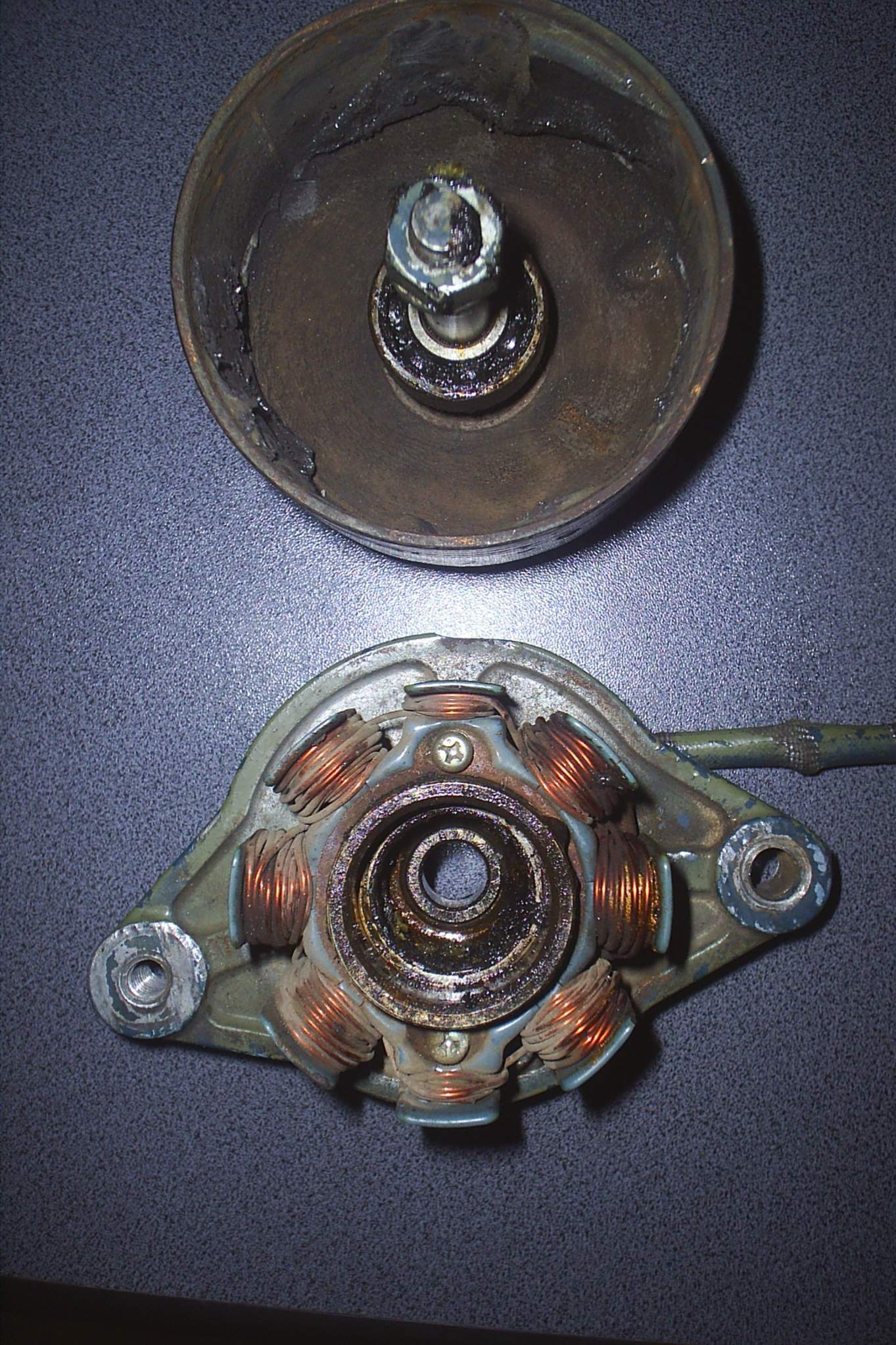

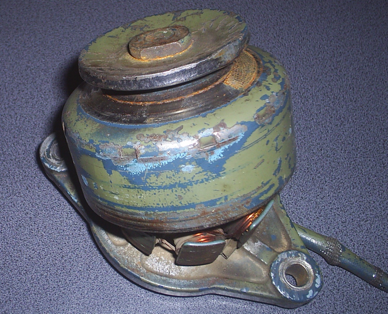

Bob, my '99 B2710 manual says it's a "AC dynamo and a regulator."
And George, I'm not much of an electrician, but my manual says, "This dynamo produces higher voltage in slow speed rotation, and charges electric current to the battery during engine idling."

Bird,
I think the term "Dynamo" is an old term for generator, be it an ac or dc. Since the popularity of the alternator in cars, tractors etc. The dc generator has become just generator and the ac generator with output integrated rectifiers for a dc output is called alternator. My tractor is three phase, ac generator with full wave rectified outputs.(alternator)
The primary advantage of the alternator is the construction of the rotor. An alternator of the same capacity is significantly smaller and cheaper to build than the equivalent dc generator.
