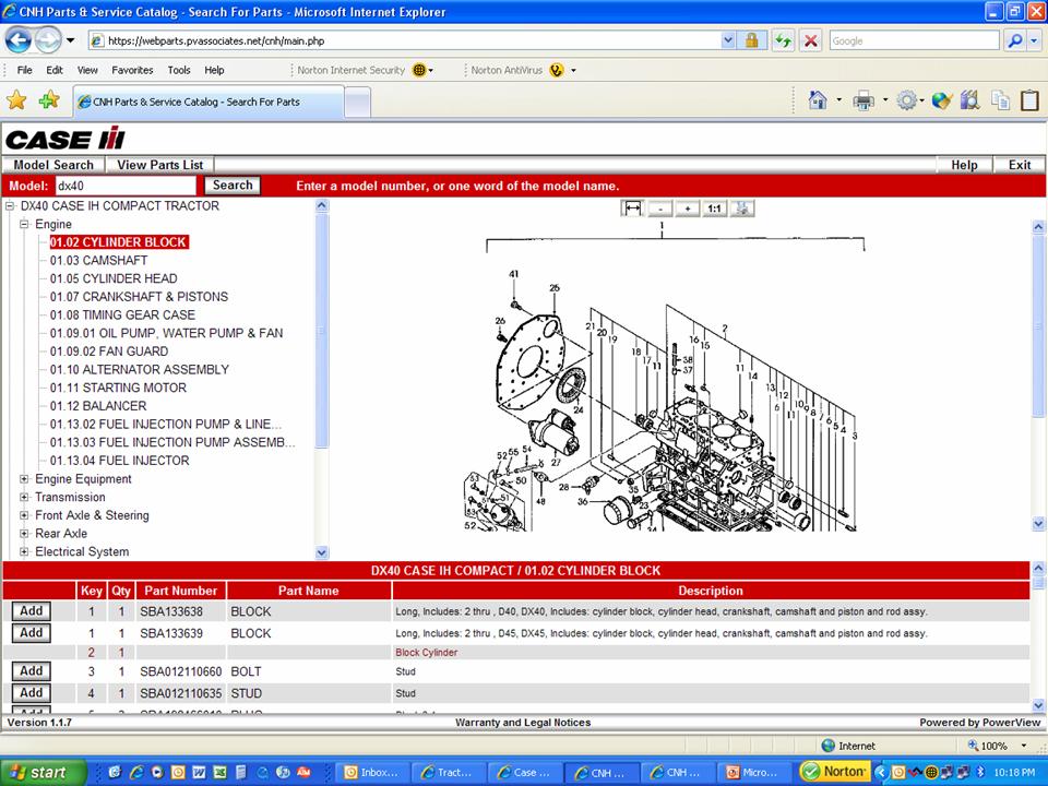

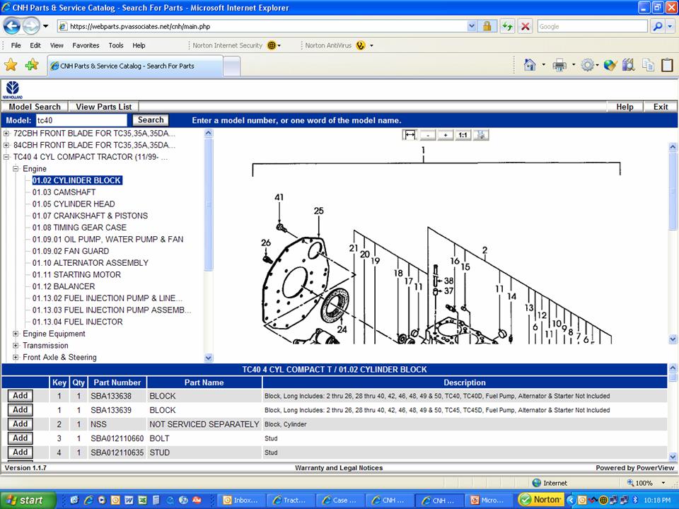

I just purchased a used TC40D a week ago. I have a Case IH dealer in town. Closest NH dealer about 30 miles away. Can I use a lot of the same parts? I noticed a lot of things very similiar on the two. It looks like only the color is different and some cosmetic things. :confused:
   / DX40 & TC40? How much are they alike? #2
They are the same. Check out their spec sheets on either website (they are the same too:D ).
   / DX40 & TC40? How much are they alike? #3
They look the same in the parts section on the web. See the attached snapshots of the parts pages from CASE & NH. ;)
