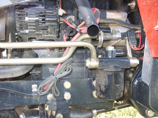

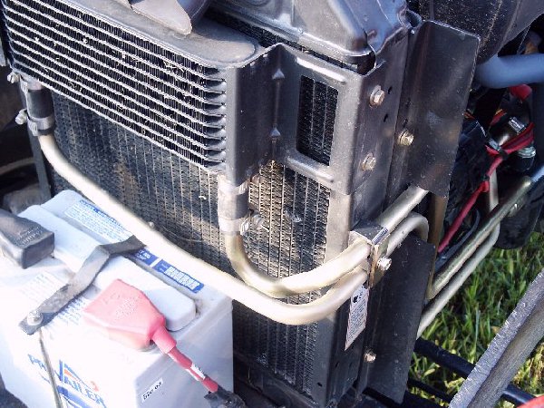

Here's a couple of pics of the new cooler lines that were installed. The elbow is eliminated so hopefully no more problems there! I didn't get the paperwork yet from the dealer, so I can't tell you any part numbers - they just dropped it off back at my house when they were done.
Front view.

   / DX 33 Blew an oil cooler line!! #13
Side view.

   / DX 33 Blew an oil cooler line!! #14
That looks like it should hold. Was that a dealer fix or a factory retro fit for existing tractors? How many hrs on your DX33 now? And by the way, did you ever have the hyd fluid filter seal blow in cold weather?
   / DX 33 Blew an oil cooler line!! #15
It was a factory fix. It's got just over 100 hours on the clock. I haven't used it much in the cold weather, but I haven't noticed any leaking or seaping around the filter.
