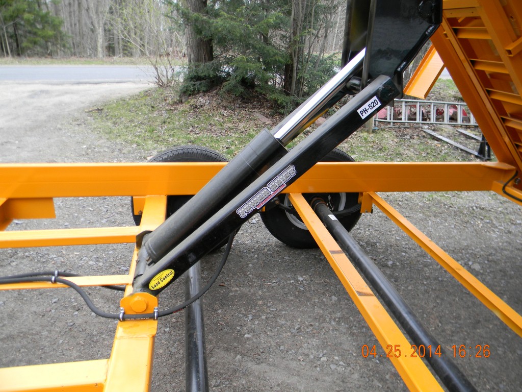

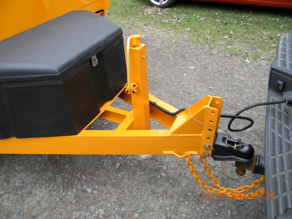

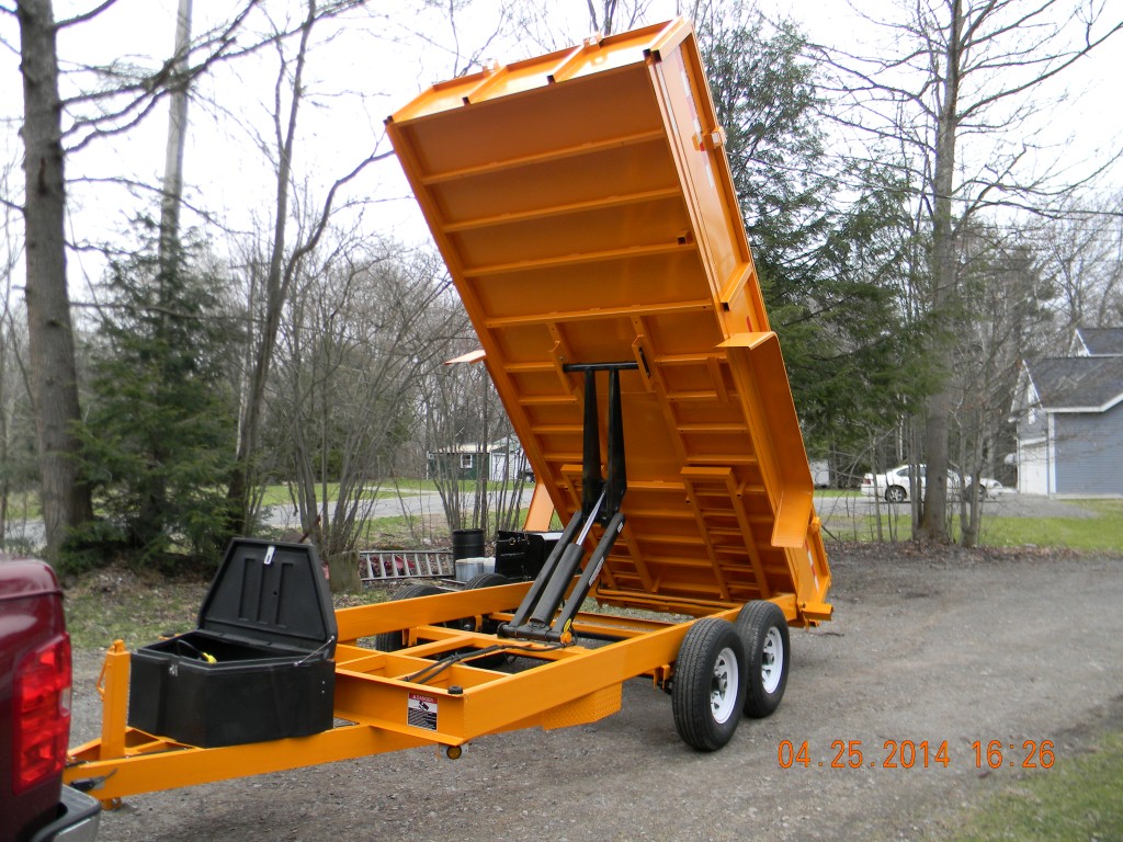

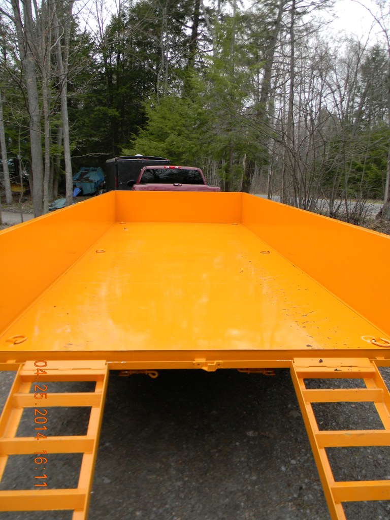

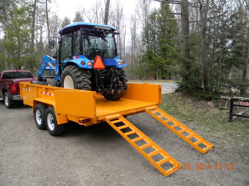

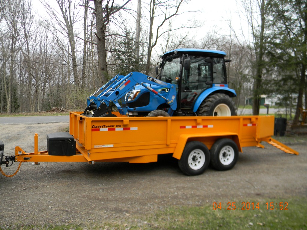

I have a dump trailer with the barn doors and ramps. It works fine. the dump body has welded in D-rings for tie down points. You just need to measure how long your tractor is with loader and box blade to know what length trailer to get.

   / Dumping Trailer for Towing B2320DT
Nice !!!! I love it. I want !!
What brand is that?
The barn doors are awesome. I wondered how that would get resolved duh.
   / Dumping Trailer for Towing B2320DT #5
What brand is that?
My trailer was built by Cross Country Mfg. here in NY. It's 16' x 80" wide. Has 6 D-rings welded in for tie downs. Barn doors with ramps. Load cap. is 10K. Once the doors are open the ramps have a lip to sit on. Here;s a few more shots.

Is it easy to remove ramps for dumping? Oh wait I just noticed the ramps tuck under.
