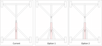

Rusty, I'm wondering if these "long sills" you refer to are actually the same as my "lower frame"? In the below pic, you can see that I have the 2x4 tube as main and side rails of the bed AND 2 lengths that remain horizontal with the wagon frame -- these are what I was calling my "lower frame". If I'm interpreting you right, I'd simply be doubling these up.

That if you took out the center portion of your reach at the end where the base of the cylinder is and replaced it with either:
1. A piece on each side moved outboard far enough that the cylinder can fit inbetween going back to the intersection of the reach and the C channels that come up from the axle.
2. A piece on each side moved outboard 6" that goes straight back to the C channels that go from the axle to the reach.
Here is a drawing showing the current setup and the above options.
That would let you move the base of the cylinder down enough that it can have more lifting force and would also give you a place to tie some reinforcement into if desired.
