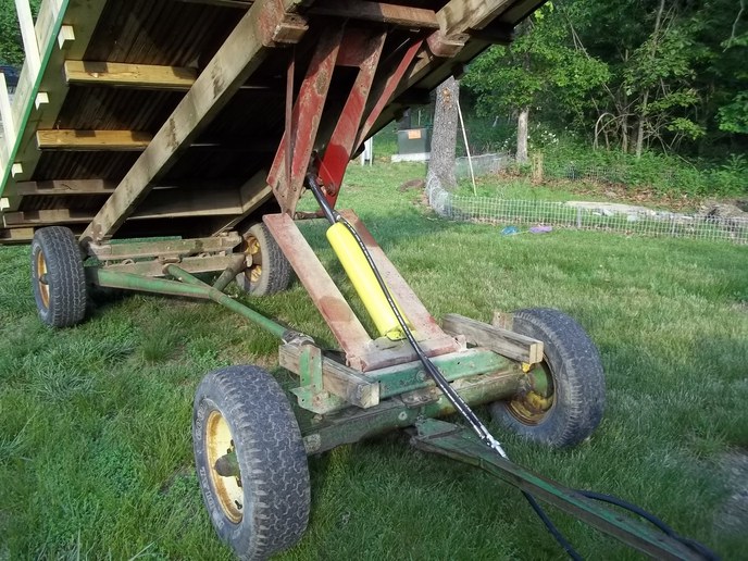

As built:
As per my understanding of rswyan's (and others') suggestion:
Omitted from the drawing for clarity is that there is also 12" of rear overhang past the hinge and 21" of front overhang past the base cyl mount. Since these affect both designs equally, I left them out of the drawings. 4" bore cyl with 30" stoke running a guess of 2200 psi as that is my understanding of the factory setting of the relief valve on my tractor

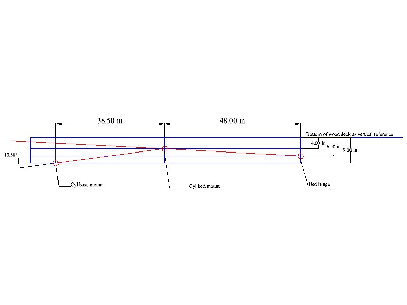

The cold finally let up a bit and made it up to -8 today so I took the time to get some measurements and plug them into CAD to get the cyl angle. My 10 deg guess was pretty frickin close. Cad says 10.38 deg at rest. So using the link from Surplus Center forces go something like this:
Current:
10.38 deg = 4981 lbs of lift 4' from the box pivot
Lift whole thing 4": 13.39 deg = 6398 lbs of lift
Lift whole thing 6": 19.44 deg = 9201 lbs of lift - really don't want to raise it this much
If I were to reverse the mounts as rswyan suggests:
At existing height: 5.74 deg = 2765 lbs of lift 8' from the box pivot
Lift whole thing 4": 11.5 deg = 5512 lbs of lift
With factoring in the mechanical advantage of the lever of the box (if I"m calculating right), the second way would give me an extra 549 lbs of lift BUT also an extra 2216 lbs of horizontal push now trying to push the box off the front of the frame rather than the back. I'm not sure this is an improvement. Now if I were to reverse the cyl AND lift everything 4" I could gain 4626 lbs of effective lift for a total of 11024 lbs by comparison. This is obviously a big improvement but has the challenge of the cyl base mount being in the middle of the reach which is it's weakest point rather than now with it on the front frame. Anyone know how much force is required to bend a 3" pipe pushing in the middle of a 8' lenght?
If I got this right, I'm either going to weld it solid to the wagon frame at it's current height or raise it 4" and weld it solid. If that doesn't work, I'll incorporate a scissor lift once I look at the geometry a bit more.
In these calculations I made an error as to the length of the lever and the ratio between them. The second option should have had a factor of 1.8:1 not 2:1 for calculating equivalent lift. Lever length for the first (as built)option is 48" while the (my understood) proposal has a length of 86.5"
So to re-calculate the proposed layout:
5.74 deg = 2765 lbs of lift @ 1.8 lengths of the original lever (86.5 vs 48) = 4977 which is pretty much exactly what I have now. 2765 lbs of lift on a 86.5" lever is the same as the 4981 lift on the 48" lever. Please correct me if I'm wrong.

Something still seems wrong with orienting the cyl this way to me. Aside from a couple people here, I've never seen one like this. Why are they not a more common design?
Company Normand - Farm Dump Trailers
I did the same thing as these guys. I'm no engineer but it seems that you would need less push force the farther you move forward but it comes at adding cylinder length. My methology (brain says this should work) says that less force equals smaller cylinder size. I used the link someone posted here earlier to calculate forces needed. I worked out how far down I could go to the bottom cylinder mount and went from there to calculate length and cylinder size. Their pictures are not very big but you can see how the cylinders are mounted.

Interesting. I've only ever seen a Normand with the vertical front mount cyl.
There's no question that lifting at the front will take less force than lifting in the middle. The difference is if the design will provide the additional force or not. Within the constraints of my build, I don't have enough height to get enough effective angle to make it worth the redesign.
It probably works in yours because you planned it that way from the start. Still seems backwards to me but apparently it works
Once I figure out how to best get my lower frame rails anchored I will be able to properly evaluate if my setup actually works since it was the anchoring that was the weak link that failed. I don't even know for sure if I have enough lift or not. If then find my current setup doesn't work, I'll likely rebuild with a telescopic cyl mounted vertically at the front like a dump truck

I'll try to clarify...see next post. I'll have to condense my CAD drawings and hen-scratching to something more post-friendly but the results are in post #39

At a 90 deg lift, I could get by with a 2" or 2.5" bore cyl giving 6900 or 10800 lbs respectively of lift to get in the same effective lift area as with the 4" cyl mounted on the angle. Upside to this design is horizontal forces are eliminated but would require a TALL tower at the front of the wagon to mount the cyl, even with using a telescopic cyl.
I only posted the picture to illustrate the point being pushed/acted upon (the front), not necessarily the type of cylinder or it's orientation.

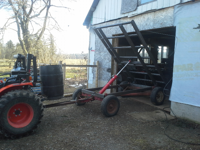

... Once I figure out how to best get my lower frame rails anchored I will be able to properly evaluate if my setup actually works since it was the anchoring that was the weak link that failed. I don't even know for sure if I have enough lift or not. If then find my current setup doesn't work, I'll likely rebuild with a telescopic cyl mounted vertically at the front like a dump truck
It will "work" ... until you really load it up ... and then you'll run short on "steam" to push it up.
The reason I say that is I have 4 x 8 cart and you have a 6 x 10 ...
I'm using a 4" cylinder @ around 2000 psi ... at a roughly similar initial angle. (think mine might be 12 degrees but I would have to check it)
When I have mine fully loaded (probably overloaded by 1000 lbs - 5K in the bed) it will barely raise ...
You have 28 sq. ft. more floor area than I do ... 60 sq. ft. vs 32 sq. ft. - that's almost double.
If you want to be able to fully utilize all that additional floor area and be able to dump a heavy load, you're going to have to get the mechanical aspects (mainly leverage, initial angle, and mechanism) correct to do it.

Frankly, with the mechanical disadvantages of having the lift cylinder under the bed as compared to a telescopic cylinder lifting directly at the front, I'm amazed any dump box dumps!
The telescopic cylinder at the front has it's greatest lift force when the bed is down. Cylinder under the bed has it's least lifting force when the bed is down. It's just backwards. Unless of course there is some fancy linkage beyond my ability to design.
But hey, they work, and that's all that matters, eh?
Eh? You must have some good Canadian blood in you! :thumbsup: :laughing:
You are exactly right on the forces but with the cyl under the bed it's the most compact design and a standard cyl can be used rather than a telescopic at double the price. As someone mentioned earlier, brute force can overcome this as long as the components can take it -- which is where mine failed. I sheered off my stop blocks and was pushing it off the back of the wagon rather than lifting it.
