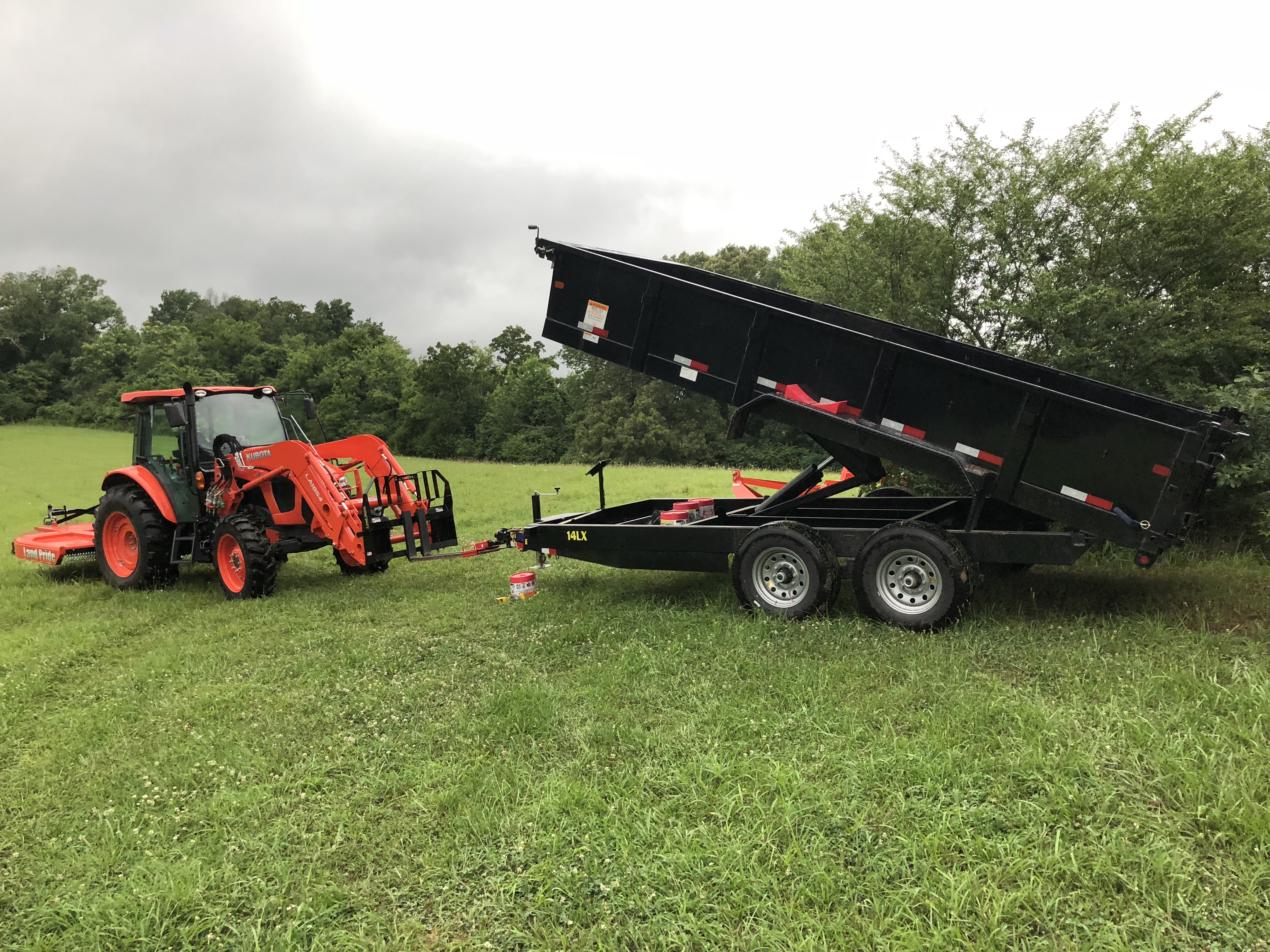

Gosh, I love this thing. Never realized how much I'd use it. I love that the hydraulics are self-contained...and that the deep cycle battery has a mini solar array to keep it charged. I ordered this one with a bluetooth controller, so I can dump it from inside the cab (like this picture). What an amazing, helpful invention. This is a 16' Big Tex with upgraded wheels/tires.

I like the idea of bluetooth - wouldn't mind adding that to ours so I could dump from the truck without the cable (would be a lot better for tailgating gravel in and not worrying about the cable for the controller catching something...
   / Dump Trailer
I'll bet you could add it. Mine was an option.
   / Dump Trailer #4
Ill have to check into that! Nice trailer!
   / Dump Trailer #5
+1 !!
I have the 12' model without the Bluetooth. I would have liked the 16' but I use mine on the road. Trailers over 12000# GVW (except some boat and travel trailers) require a CDL in my state. I agree, it's a very handy piece of equipment. Mine is equipped with ramps so I can haul my tractors when necessary. I may add the bluetooth feature at some point.
