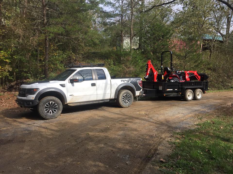

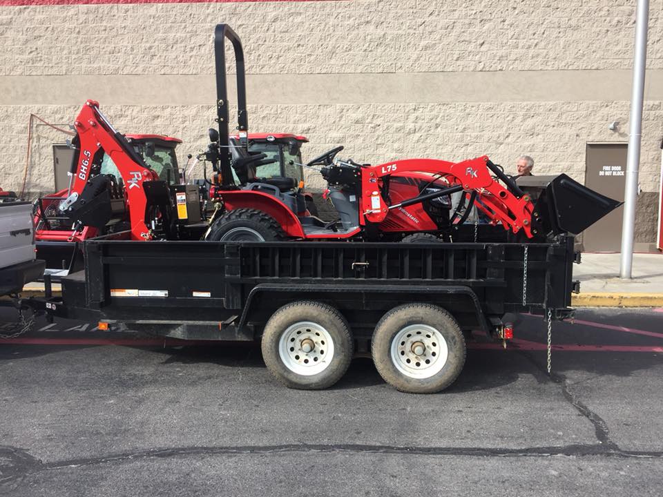

picked up my RK24 today here are a couple pics in the 6x12 dump. the hoe is right up to the front of the trailer and the loader had to rest on the tailgate45005203_10161158090695512_62116926591074304_n.jpg44956553_10161159347240512_4453960465537564672_n.jpg

The backhoe needs to be secured to the trailer. Usually a strap. It can’t hang freely.
This is the first I have heard that the backhoe needs to be strapped down. The rk24 has a couple pins that secure the backhoe when not in use, does the backhow still need to be strapped?
