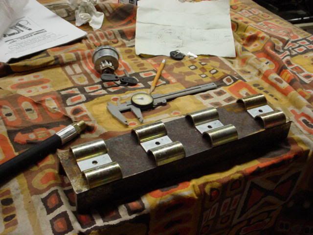

The hydraulic hoses can now be attached to the tong. I needed to make the clamps. I scrounged around the shop and remembered I have a bunch of steel bushings. So I cut four of them in half (long ways)

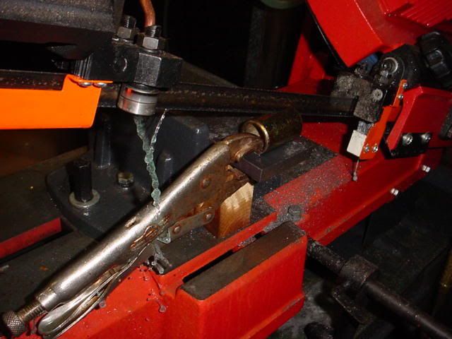

This first pic is cutting the bushings in half. I have cut pipe before but not like shown in the picture. I didn't want my fingers any where near the blade so I came up with this crazy idea:
Here they are all cut in half along with the center piece with mounting hole drilled and ready to weld together:
Hi Larry. Your library of projects here is becoming legend. Your story telling grows in encapturement also. Its always fun to read the replies for your work. There are always the "Doubting Thomases" or the "I know a better way people". I guess they have forgotten to show us their builds that are the "correct" way. But those of us who know you and the many others who are just honest realize that you think from many angles when you do your projects and they just seem to work. I did want to thank you again for the CAD help on my project. I also wanted to ask, when you were cutting these bushings for the hydraulic hose holders, did you turn them over half way through as to not hit your vise grips with the bandsaw blade. Once again, thanks for your help. Gene

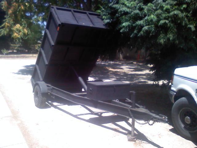

My wife and I took the new trailer up our hill and loaded it up with about a 1/2 cord of cut firewood.
Well I could not help myself. This is the very first time we have used the new dump trailer. And I wanted to see if it would lift a real load. I didn't want to dump the wood just lift it a little to check it out. It lifted it like it was empty.
The video is about 1 meg in size so if you have dial-up it's gonna take a bit to view it.
The end (for now)

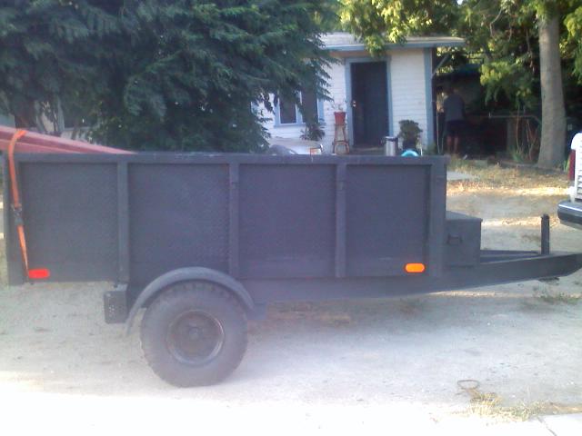

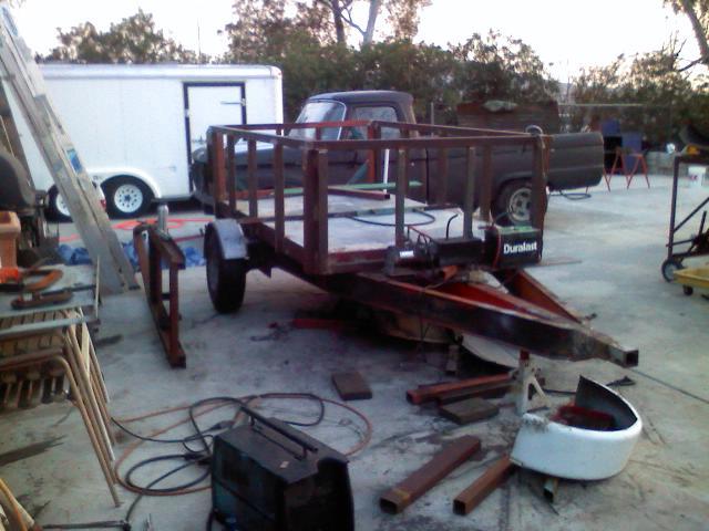

wow thats so cool i made one that looks alot like that one
heres some pics of mine

........Snip......Snip.......I did want to thank you again for the CAD help on my project. I also wanted to ask, when you were cutting these bushings for the hydraulic hose holders, did you turn them over half way through as to not hit your vise grips with the bandsaw blade. Once again, thanks for your help. Gene
Hi Gene,
Your very welcome for the CAD assistance on your project, it was fun for me and I know you appreciate it. Have you bent the flat bar for the new TPH arms on your press? Did I miss your posting one that project? If so could you provide a link?
About the vice grips in the band saw, I did in fact stop the saw and flip the bushings over to complete the cut. I've since figured a better way to make them, it's called "buy them already made" and forget trying to make everything myself! Sheesh I must have spent half a day making 10 dollars worth of hydraulic hose clamps, that was genius :rolleyes:. But then again I got more play time with the stuff collected over the years. :)
Hi GLH
I see this is your very first post,
Please let me say it's an honor and privilege to be the first to Welcome you to TBN!
WOW ! the similarities on our homemade dump trailers are striking. Just goes to show that brilliant minds really do think alike ;) When did you build that? You did a super job. I must say I'm humbled, your's is much better :) How does your tailgate work?
