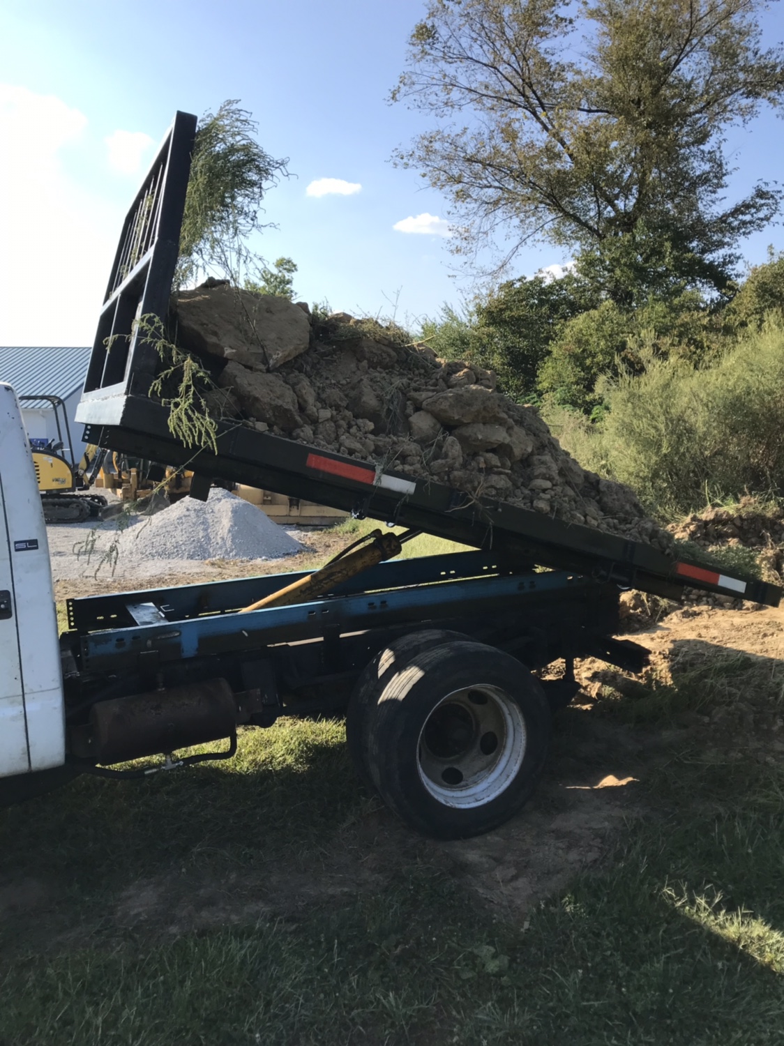

I have six dumps fully heaped with wet clay and not a problem or even a slow down.
I’m surprised a cylinder that small is capable of lifting the bed up and lifting high enough to dump. Care to post a picture? Here’s a dump I built with a much bigger cylinder and it has trouble dumping a big load. It’s a 4 or 4.5x45” a little shorter would actually be better. My other truck has a 5x30” cylinder. IMG_7479.JPG
