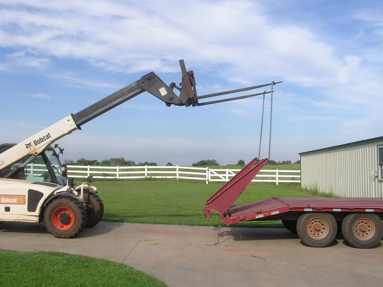

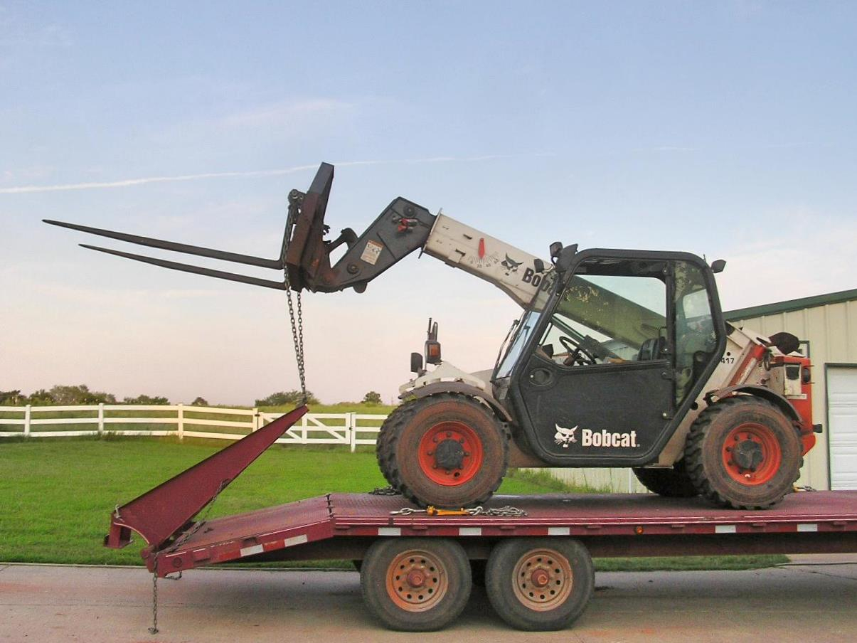

Well it sounds like I shouldn't have any trouble, do you load your skid steer backwards in the dump trailer or drive it in and back it off?
Note my Bobcat is a loader not a skid steer, it don't tip front or rear, very stable, so I drive it on forward. I do have counter weights on the rear, so backing it on is too heavy on the pin. This is with gooseneck 16' dumps. I think the ramps are good for 6k per axle. I have seen them bend with operators trying to load heavy backhoes. Most of the weight is on the rear axle. Dang things are heavy. I have a set of aluminum ramps for my car trailer but they are only rated 5k per axle, I am afraid to try it.

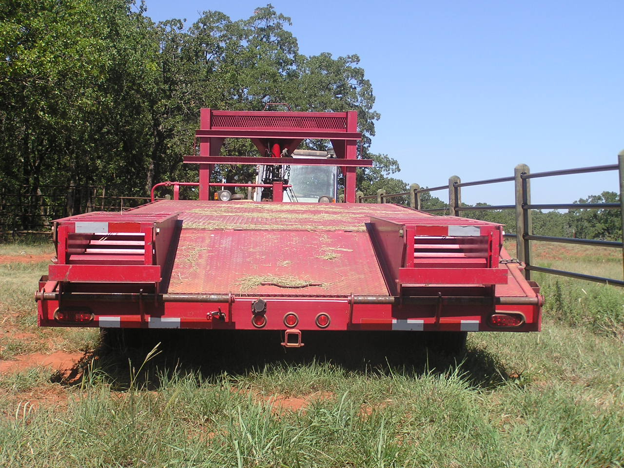

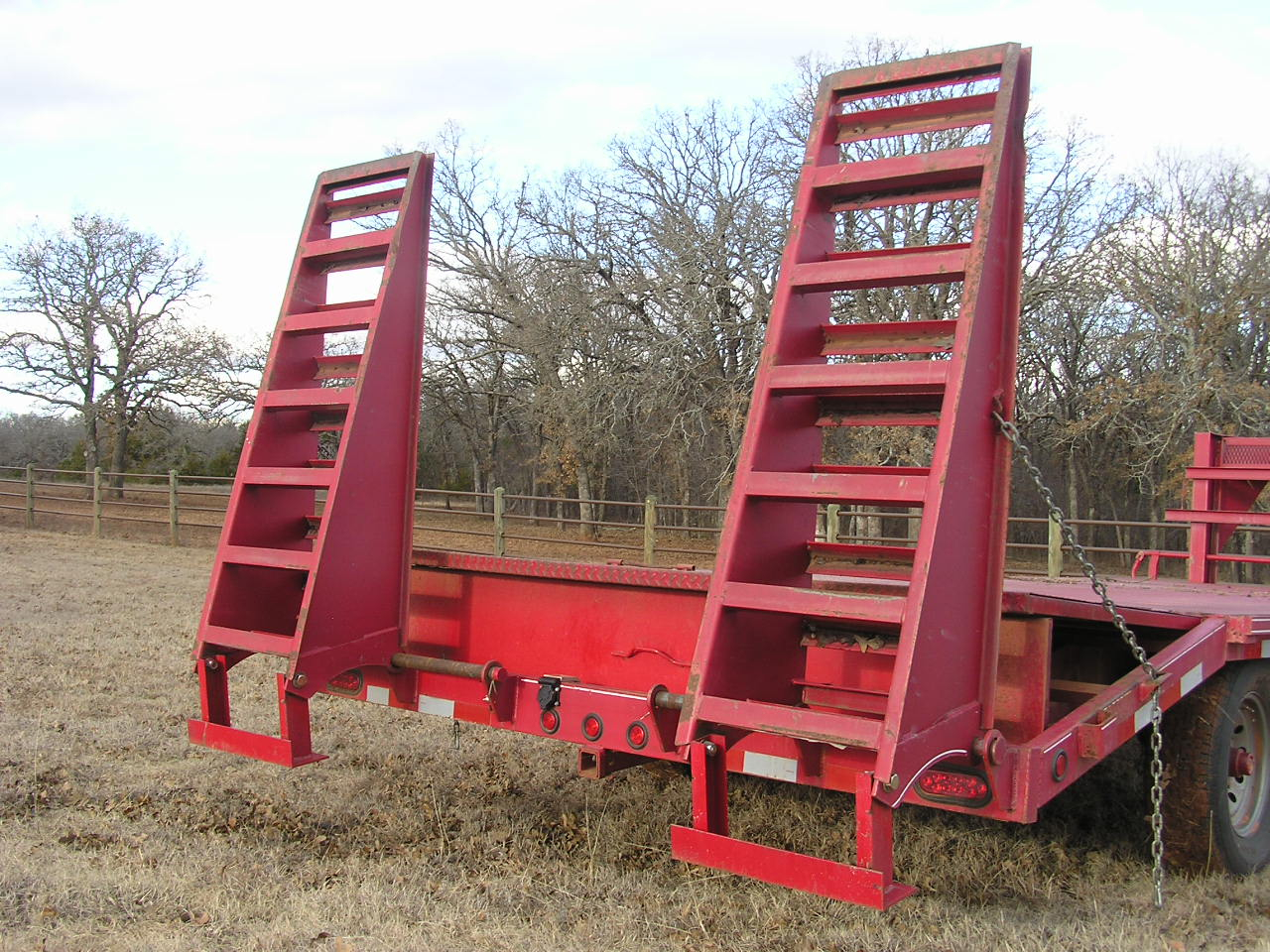

Don’t your ramps have spring on them?
No springs:
   / Dump trailer ramps strength for loading skid steer #19
I would seriously consider a short leg in the middle of the span on each side of each ramp, or a long one all the way across if it is a 1 piece tailgate. I hate bent ramps and tailgates! A leg halfway should be designed in length to be able to be sitting on ground when the springs start to compress on the rear axle. Should also take into account that not all land is flat. The red ramps Xfaxsman is showing is what you need to adapt your tailgate into without making them too heavy!
