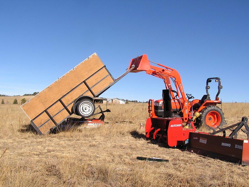

I am moving a lot of dirt and need a dump trailer. This didn't work for several reasons.
1 Not all of the dirt emptied out of the trailer.
2 The tongue didn't come down so I could hook up with dirt still in it.
3 Without anything hanging on the 3ph the back of the tractor was too light for digging out the dirt even with loaded tires. (Driving on 2 wheels is fun :eek: )
Be careful if you try this. There are a lot of ways this can go bad.

I had an old pickup bed that was made into a trailer. I tried the same thing you showed in the picture with the trailer full of old roofing shingles. It did not work because as the shingles came out they made a pile right behind the trailer that eventually got big enough to stop the lfow out of the bed. With this setup you cannot pull forward like you can with a dump trailer. When I lowed the trailer down and pulled it forward and tried again it eventually dumped all the shingles out of the trailer but took several tries.

That method works, but you have to line the bed of the trailer with sheetmetal. You can use 18 or 20 ga and just tack it down. Or you can put some 1/4" black iron pipe across the width (4-5 of them) and sheets of plywood on top. The load will slide out. Or you can buy one of the load handlers like you put on the tailgate of a truck. I think Harbor Freight sells them too.

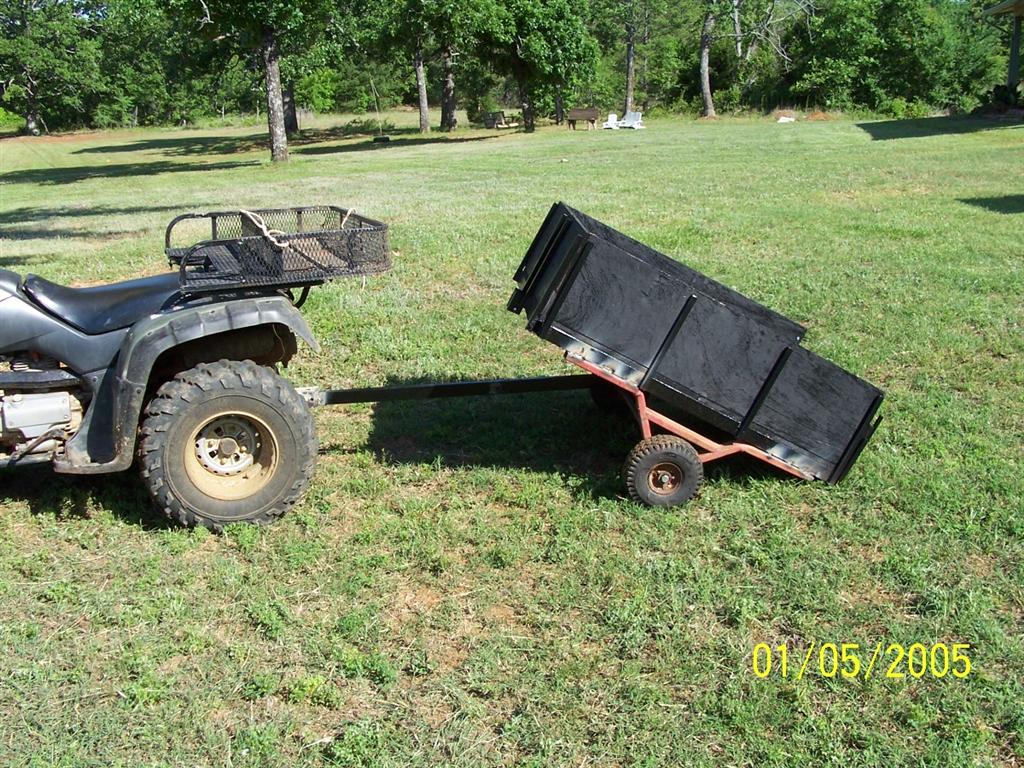

You might be able to convert that single tongue trailer to a dump trailer. However it looks like the wheels are centered on that trailer instead of the standard 60/40 setup. This is an ATV trailer I made but the principal is the same.

Why not add a set of 12" or so adjustable hight gauge wheels to each rear corner as close to the back corner as possible, that way when the trailer is lifted to max height then simply, (and SLOWLY) back away from the debris and the trailer will follow on the wheels. When trailer is in down position the rear wheels will not interfere with the normal motion of the trailer. Worth a try or at least look into. Of course some modifications to my idea may be warranted.

Looks like you still had 12 - 18" of height available from the loader curl. Next time put a plastic sheet in there before you add the dirt.

My first goal is to make moving dirt quicker. Using the tractor to "dump" the trailer takes time along with the hook and unhook (at both ends of the trip). Right now it is easier to just drive the bucket load over and dumpt it where needed. Sorry but this plan just isn't working.

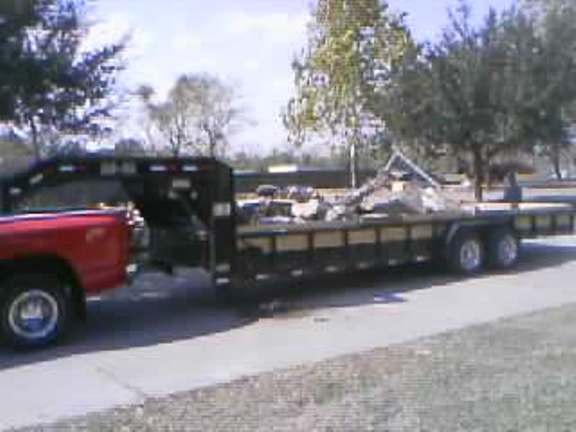

I had the same problem on a larger scale... I loaded ~10,000 pounds of concrete in my nice 24" gooseneck lowboy. I covered the floor with plywood and made side boards to protect the rails.
I hauled the cement to the dump location where my Brother in law was going to lift the front of the trailer with a cherry picker and all the concrete would slide out.... Well concrete does not slide well on plywood particularly when the rough side of concrete was face down.:eek: So he had to lift the entire trailer vertical up ~30' in the air. I was nervous to say the least.
