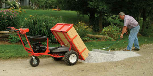

Or the low budget dump trailer:

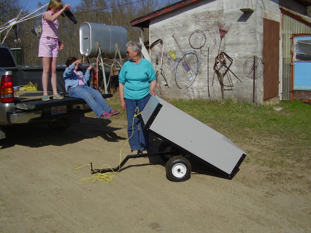

Like this? The load box is balanced over the rear axle, but the hitch pivots off the back rail of the box frame. Forward motion tends to pull the box down. Backwards motion tends to dump the box. Steeper dump angles would be achived by mounting the load box higher.

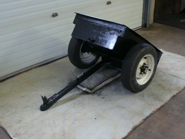

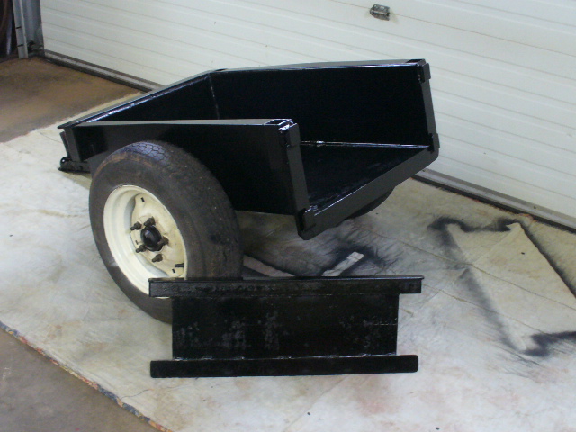

This is a little cart I made to sell.It worked alright but if you want it to dump completely you will want the axle more to the back so the tail doesn't touch the ground.P1010766.JPGP1010767.JPGP1010772.JPG
