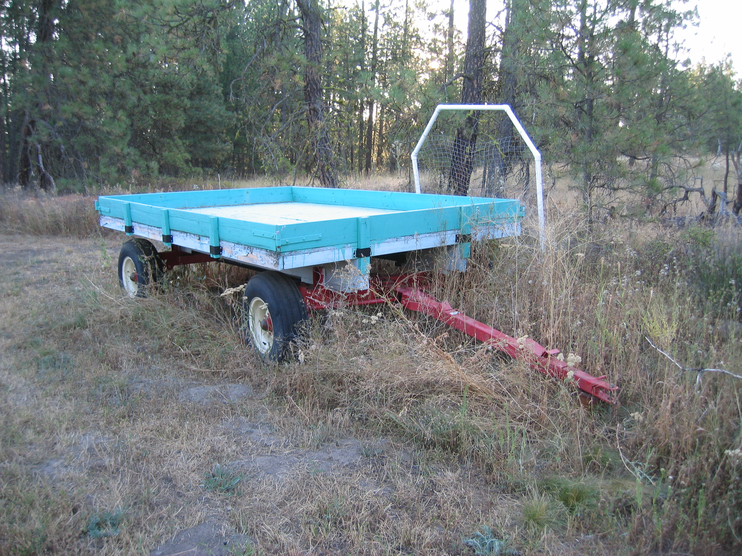

This isn't tractor-related, but it is rural, steel-based, dirty, and testosterone-fueled. The floor of my 93 F350 dump truck is rusted, and there are several holes / tears adjacent to the cross bunks. I don't use it enough to justify having a new steel floor installed ($2000 +), but I would like it repaired so that dirt and aggregate don't fall through, and pallets will slide without getting hung up on the welds protruding above floor level. Before adding a new floor of any kind, I would remove the existing one, probably cutting it away in sections and grinding down the bosses where it is welded to the bunks--LOTS of grinding! I would think 5/4 or 6/4 rough-sawn oak lumber of pallet grade would be adequate for a new floor, even able to withstand rocks dumped in as carefully as possible. Probably a good idea to use wear strips available from firms that supply bed kits for classic trucks. Any thoughts on this subject?

I made a farm trailer with Horst ten ton running gear. It is not dump. I priced sheet steel for the bed. Just too darn expensive. I used 5/4 T&G plywood. I haul gravel, large rocks and chunks of pine trunks. It's held up well for seven years now. I sand and repaint the plywood every year with water based paint.
