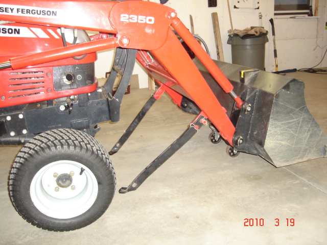

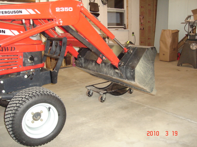

Daigle, my blower has electric controls (not sure how the manual controls are to disengage), to which I've added a flat-four trailer connector under the hood to ease that part of the hook-up/removal.
I don't think it takes me more than 6-7 minutes to drop the blower onto a flat wheel dolly, and perhaps the same to re-attach. The FEL (also on a flat wheel dolly) takes me about 8 minutes to hook up, maybe 5 minutes to remove. Piece o' cake!

These flat wheel dollies must be quite large to accommodate putting your fel on it. Any pictures of that dolly? Where do you get them or do you make them?

Axle, probably using the wrong word for these things; some years back I had a car in storage that I needed to be able to move sideways. These wheel dollies fit the bill nicely, though I've since gotten rid of the car. Tire sits in the depression and the swivel casters are also steel.
Believe I got them from Northern Tool, maybe 10-15 bucks apiece or so. Use them for the blower, front quick-hitch assembly, FEL bucket... pretty handy. If the wheel are kept oiled, they roll --in any direction-- easily and can support a good deal of weight without issue.
