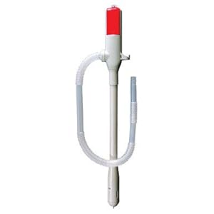

I set the jug on the tank with the flipped up seat and use a battery powered kerosene pump (don't do this with gas) take both caps off put put pump in jerry can and discharge in tank, flick switch its a little slow but at about $12.00 it really cheap!!!!! just like yours truly.
http://www.amazon.com/AMERICAN-SI75-Kerosene-Battery-Operated/dp/B002ZC1XBQ
