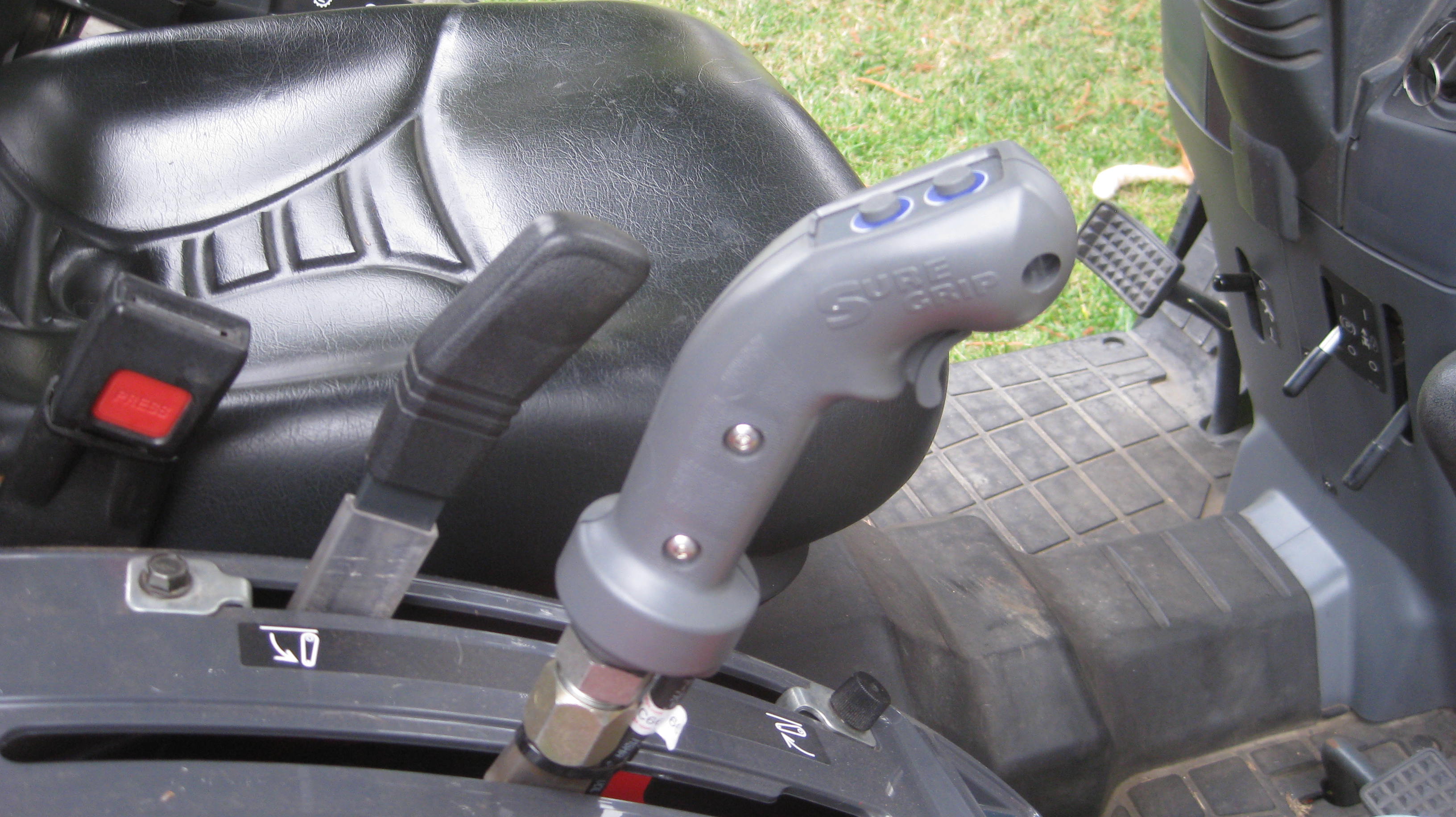

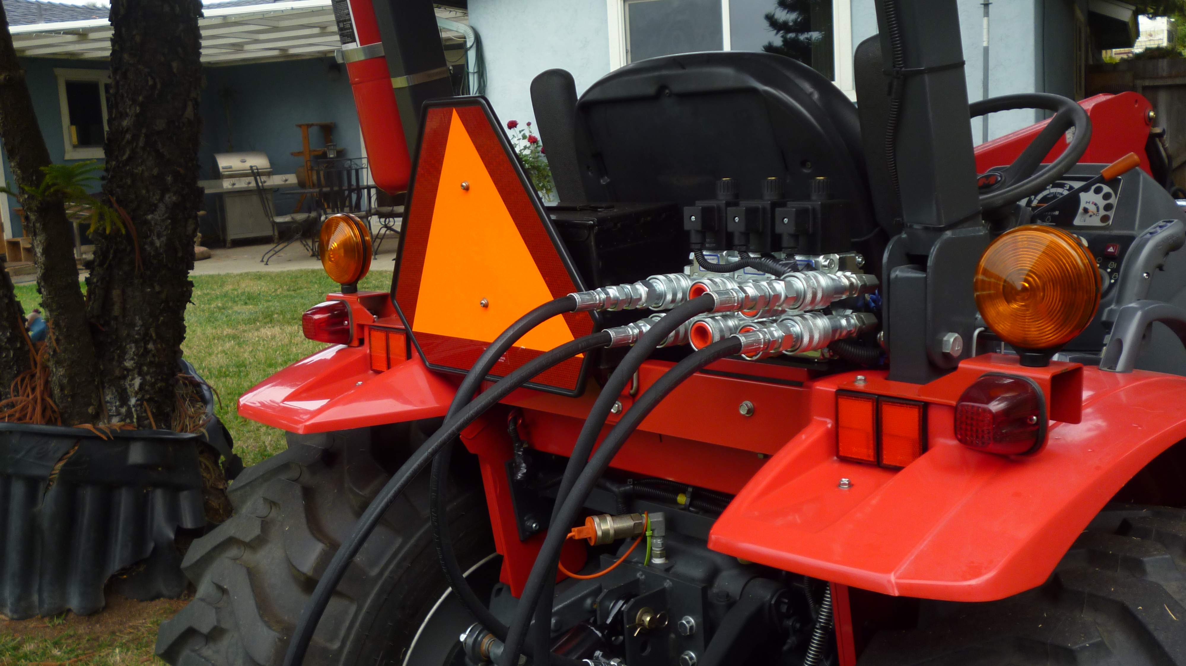

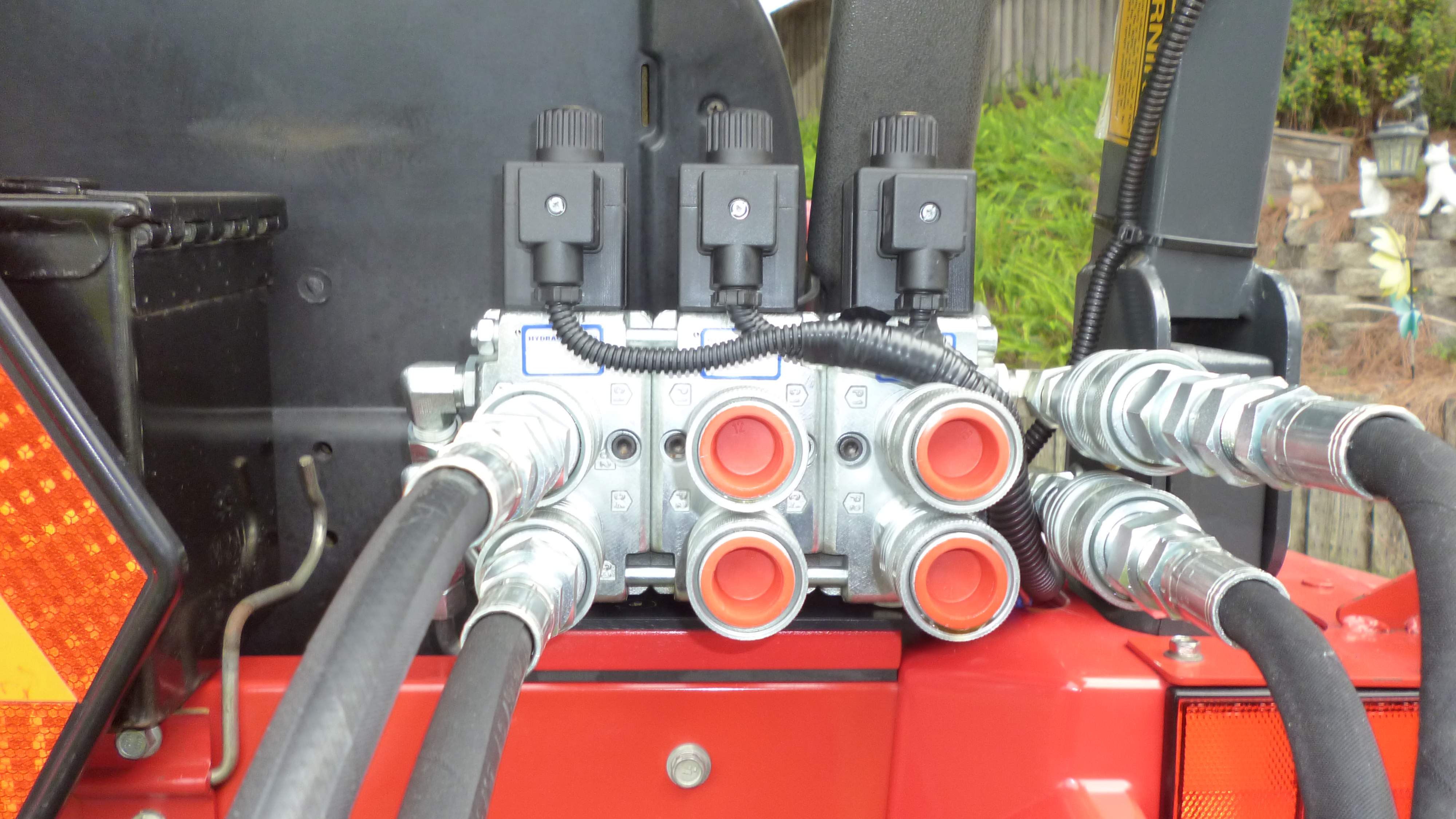

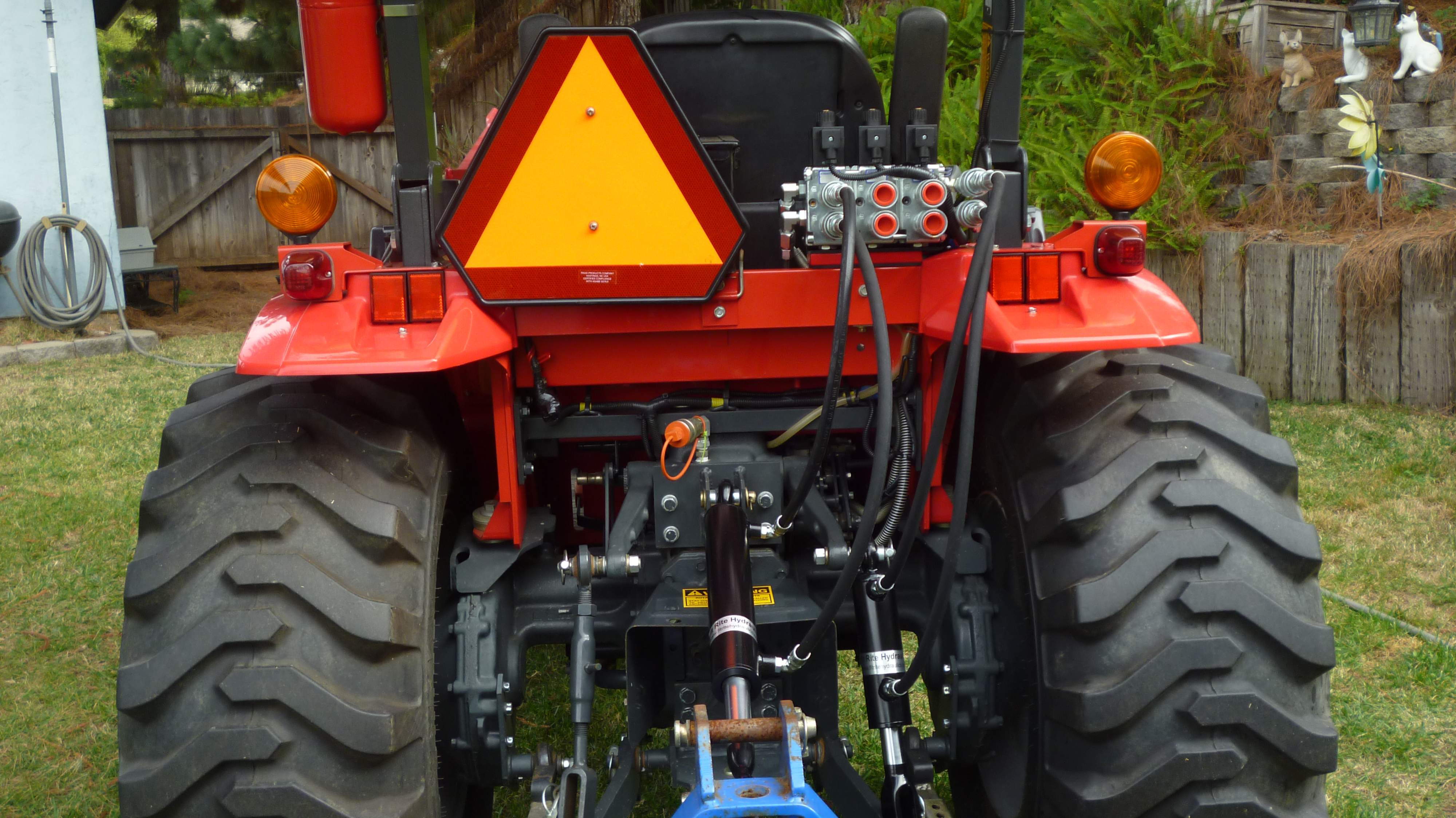

Do you just want to end up with 2 remotes, or do you want-need more than 2? :confused3: If only 2, you are best off just getting the OEM 2nd set. If you need more than 2, then an electric diverter setup is the way to go IMO. I have a Mahindra 3215 that I need 4 rear remotes on. There is only 1 remote available as an option :mad: and I got that when I purchased the tractor. I installed 3 diverter valves. Very clean and neat IMO. Here are a few pics. :cool:
