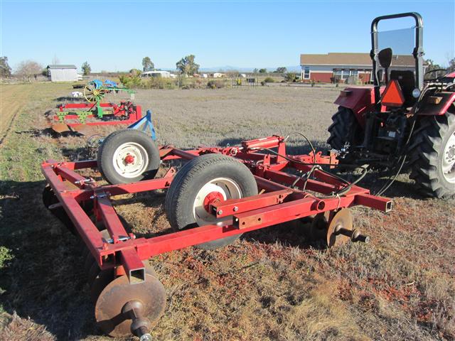

As k0ua said, the valves and quick disconnects with connecting hoses are pare of those factory remotes. What you need to supply are the hydraulic hoses between the quick disconnects and your implements. Tractor Supply or whatever is equivalent in your neighborhood has hose and fittings for the ends of the hoses. Surplus Center and Discount Hydraulic Hose are other sources for parts.

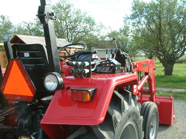

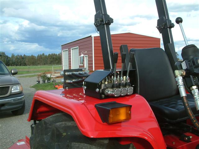

When I bought my 2008 Mahindra 5525 the dealer installed triple remotes--he came up with the design and layout.
This photo shows my wheel disc with the hoses connected between the 5525 and the hydraulic ram (cylinder) on the disc that's used to raise and lower the transport wheels.
