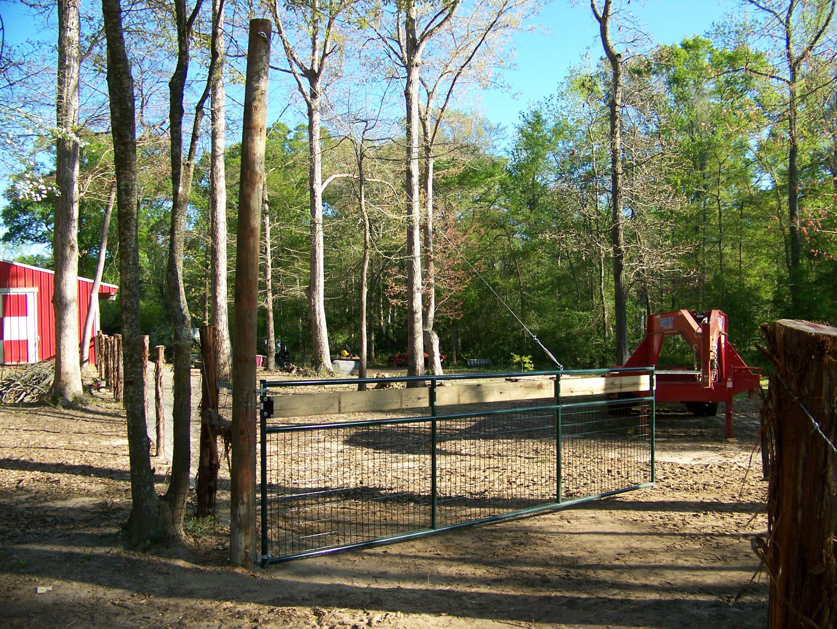

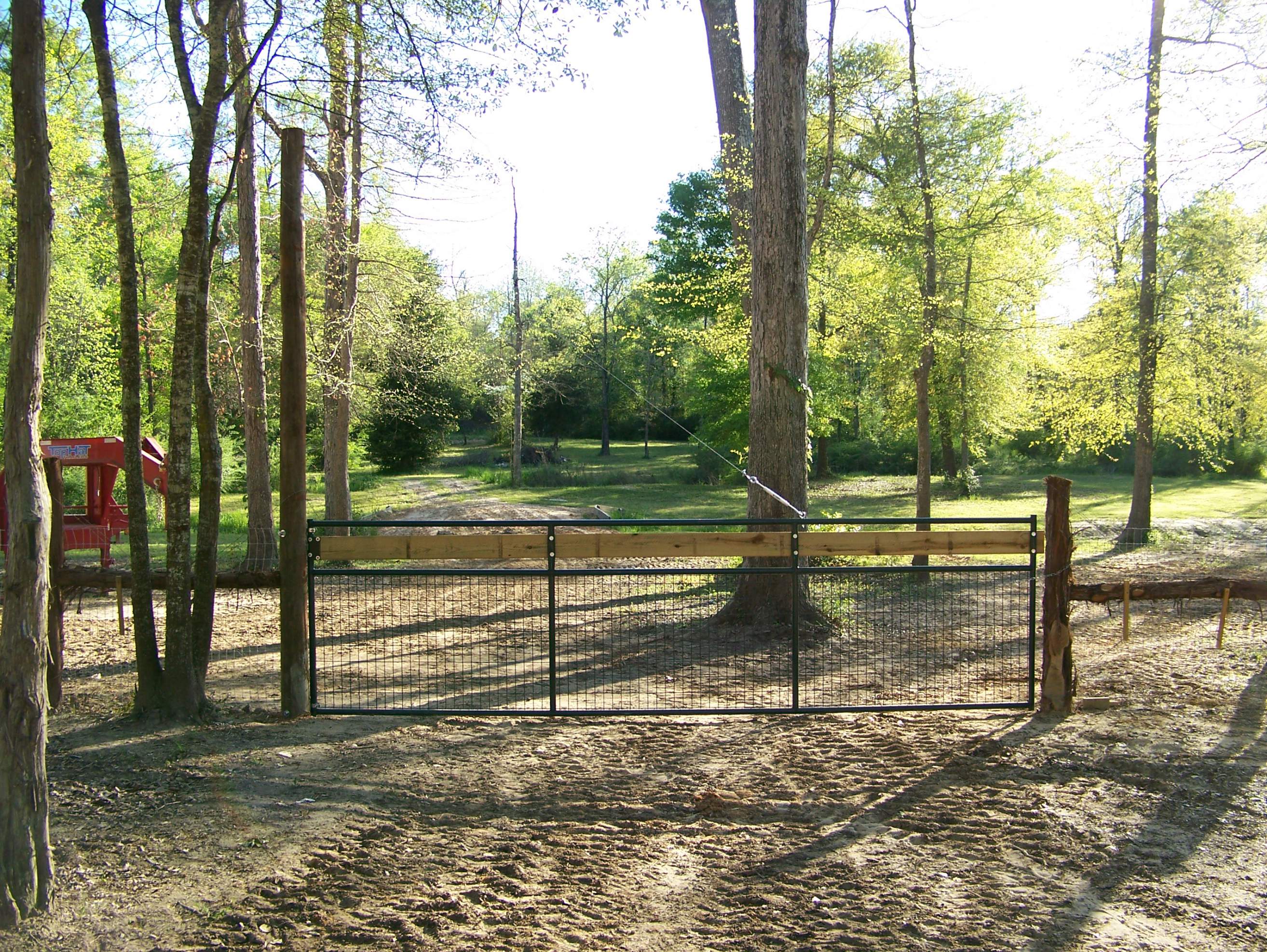

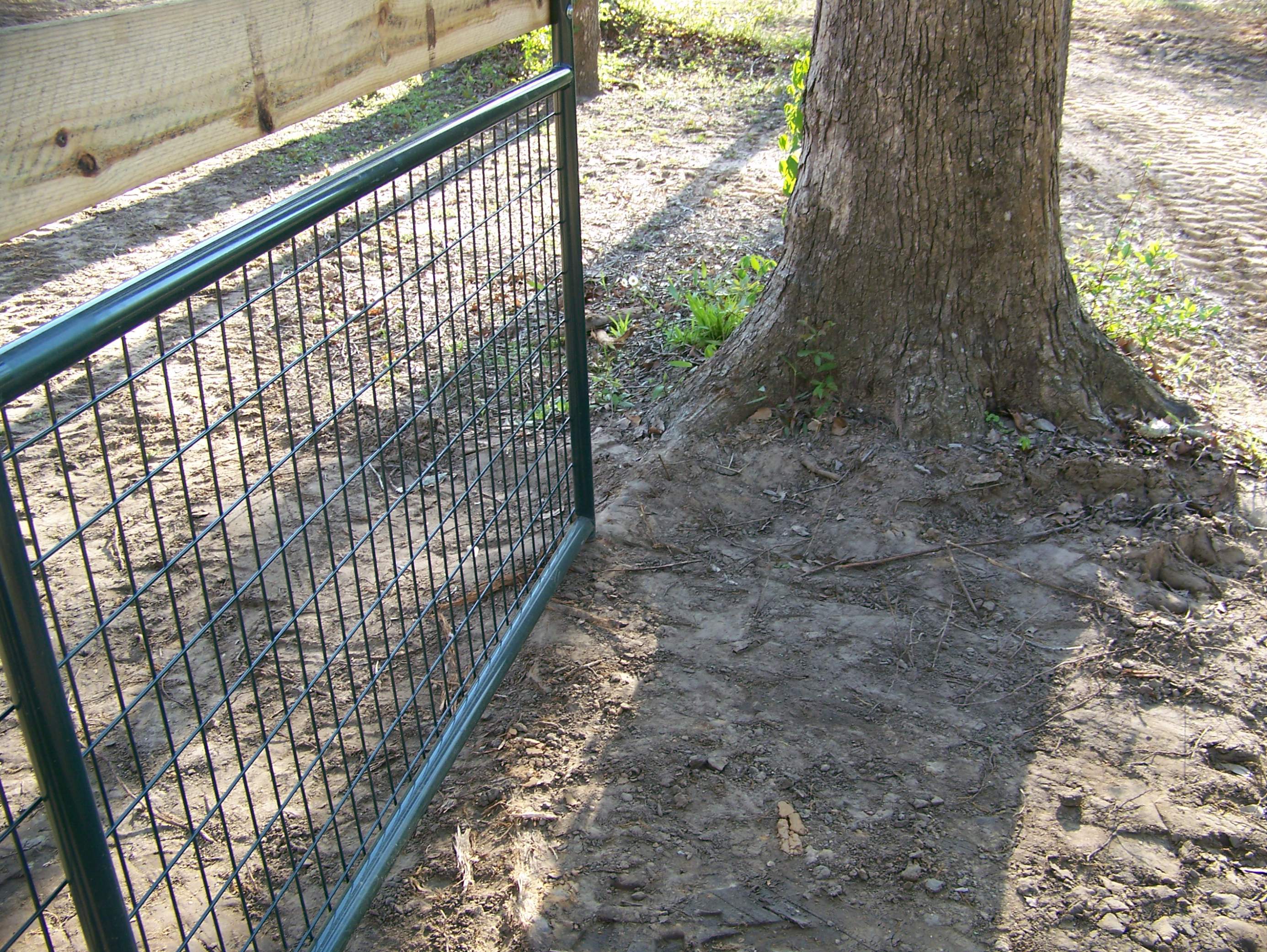

I finished the 16 foot equipment gate today. It was a pain getting everything just right, as I planned it to clear the huge oak tree nearby............but forgot about the huge root hanging in the way of the swinging gate. It didn't help that the pole was curved a little to the swing side. Major pain that was adjusting everything. I positioned the support cable angel pivot so the gate would hang near the ground when closed, yet swing up and over the root. Works great now. 3-28-15 Equipment Gate Finished and Closed.jpg3-28-15 Equipment Gate Finished.jpg3-28-15 Oak Tree Root.jpg

I finished the 16 foot equipment gate today. It was a pain getting everything just right, as I planned it to clear the huge oak tree nearby............but forgot about the huge root hanging in the way of the swinging gate. It didn't help that the pole was curved a little to the swing side. Major pain that was adjusting everything. I positioned the support cable angel pivot so the gate would hang near the ground when closed, yet swing up and over the root. Works great now. <img src="http://www.tractorbynet.com/forums/files/projects/418741-duck-dog-fencing-3-28-15-equipment-gate"/><img src="http://www.tractorbynet.com/forums/files/projects/418742-duck-dog-fencing-3-28-15-equipment-gate"/><img src="http://www.tractorbynet.com/forums/files/projects/418743-duck-dog-fencing-3-28-15-oak-tree"/>

Brandi - on the mailbox and lawnmower gates - if they start to sag on ya -- you may need an angle brace from the bottom hinge up to the opposite corner. I always put one on from the get go cause mine have always sagged after a time. Easier to put it one in the beginning.
   / Duck and Dog Fencing
#35
Mike,
I thought about that, but the 2x4 square non climb horse fence is stretched tight (banjo tight) and held on good with way too many horseshoe nails. It really makes the gates quite solid. 6 foot or so wide is all I would want to make one of these gates. I thought about a wooden 14 foot gate behind the barn, but I'll buy one with the welded wire already on it.
Shouldn't a brace go from the upper hinge down to the lower opposite corner?
Give Bernice a hug for me.
hugs, Brandi
   / Duck and Dog Fencing #36
Tension brace from upper hinge to bottom outboard end. Stiff "compression" brace can go the other way...

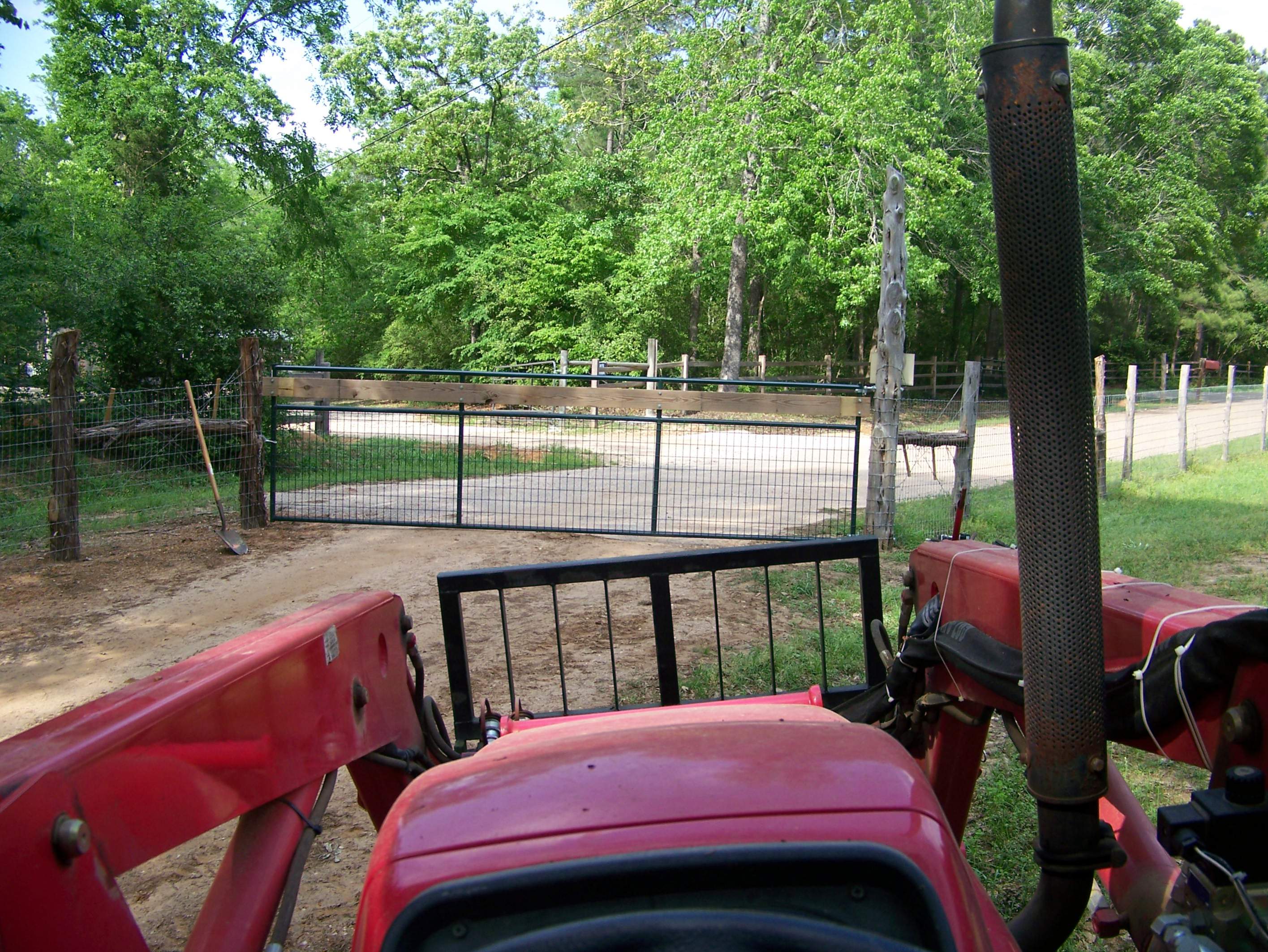

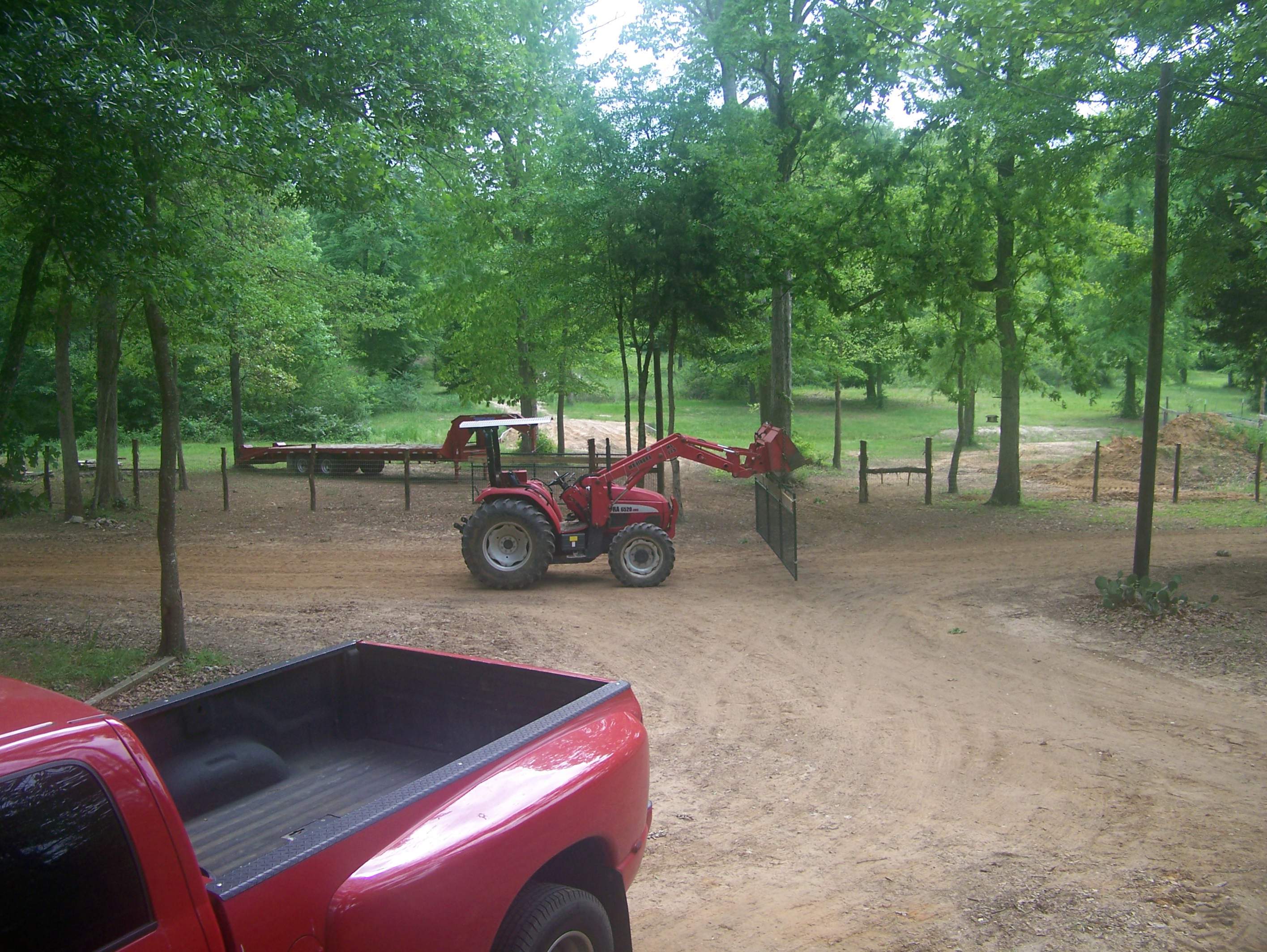

I got the driveway gate installed and the anti sag cable up. Now all that is left for cows and horses are fencing off the gully at each end. I have two ideas I am thinking about. Each one will be a major project. I also have to replace about 40 feet of fence the neighbors thought I would like when they removed it.

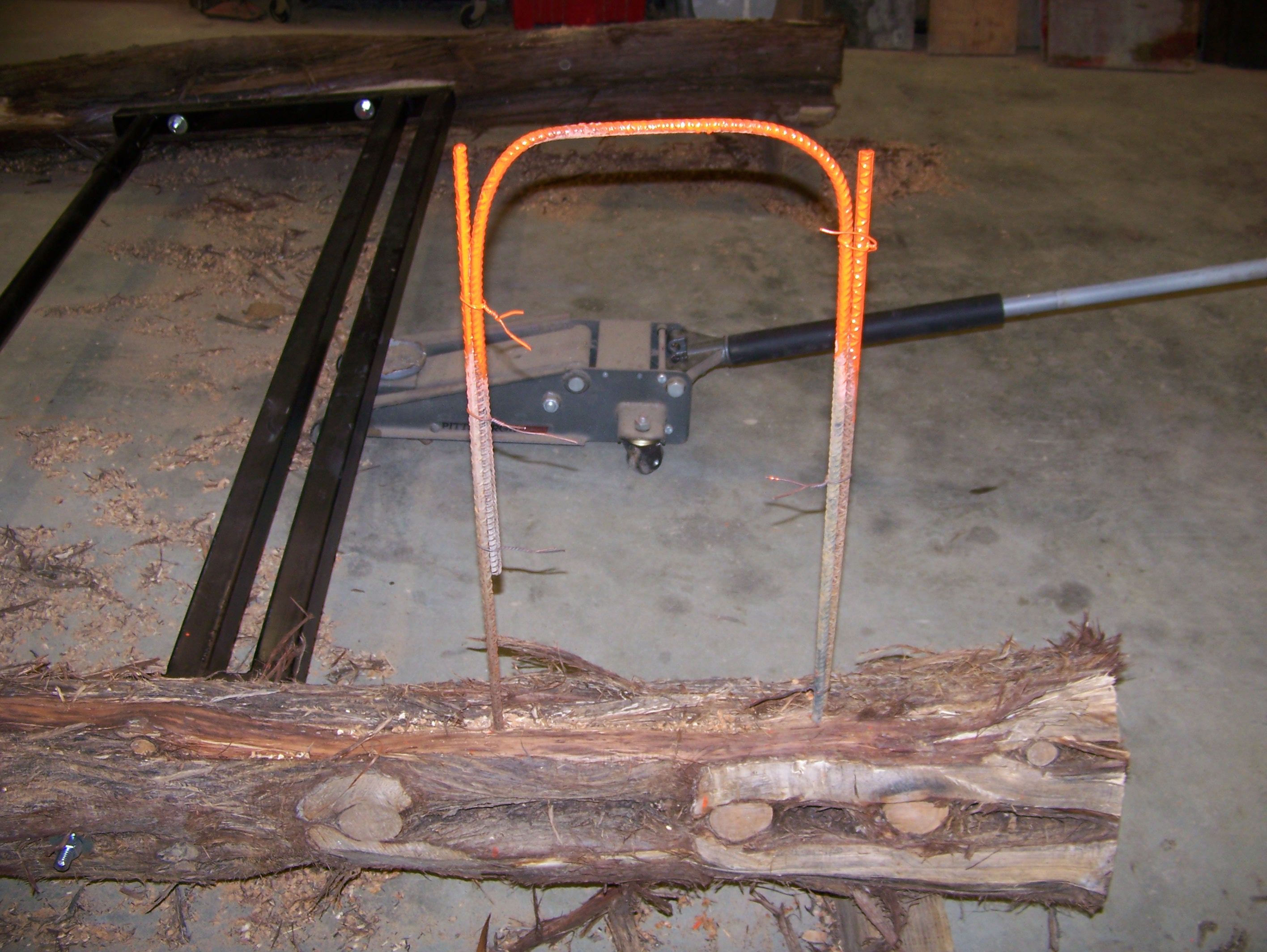

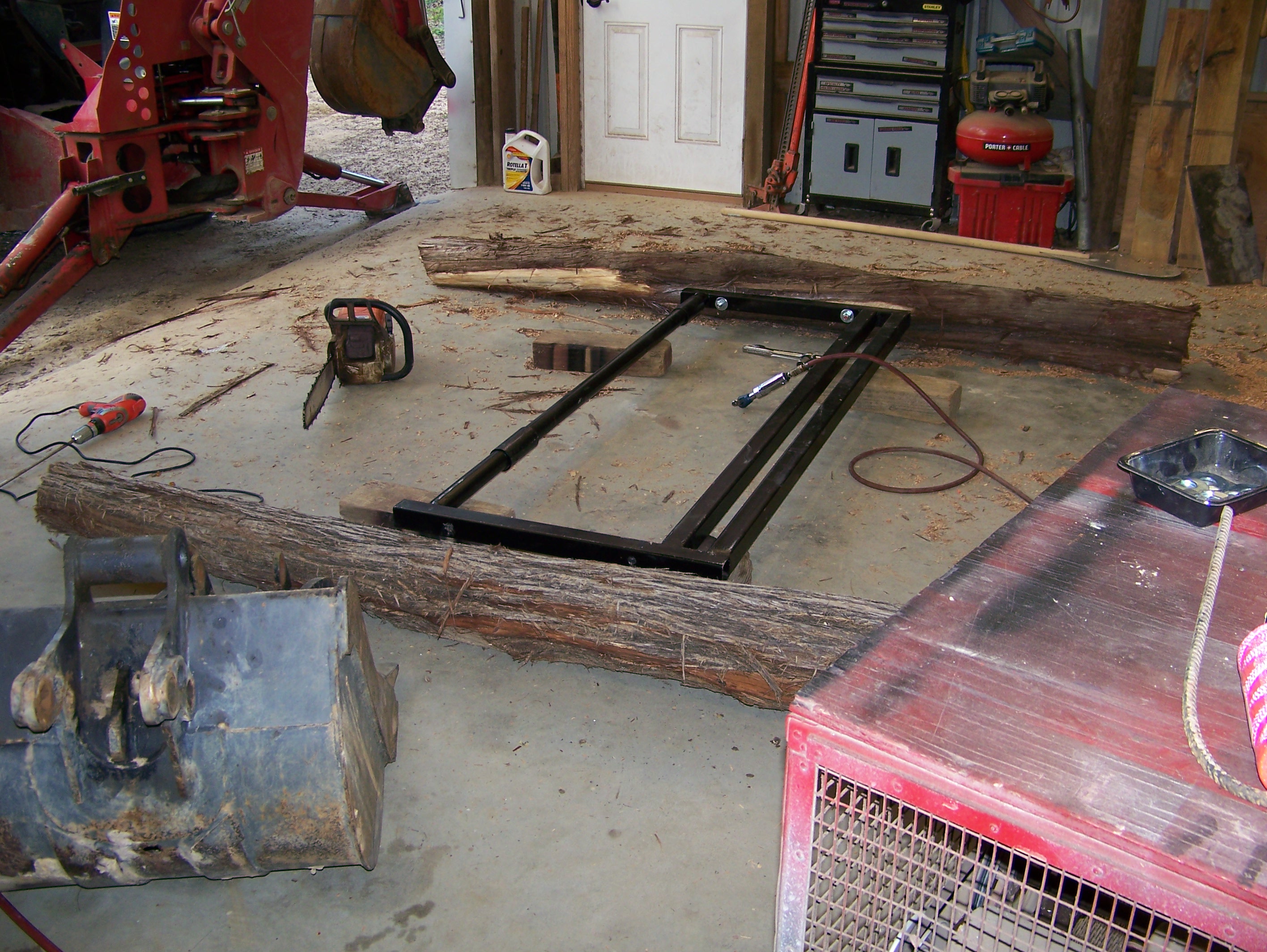

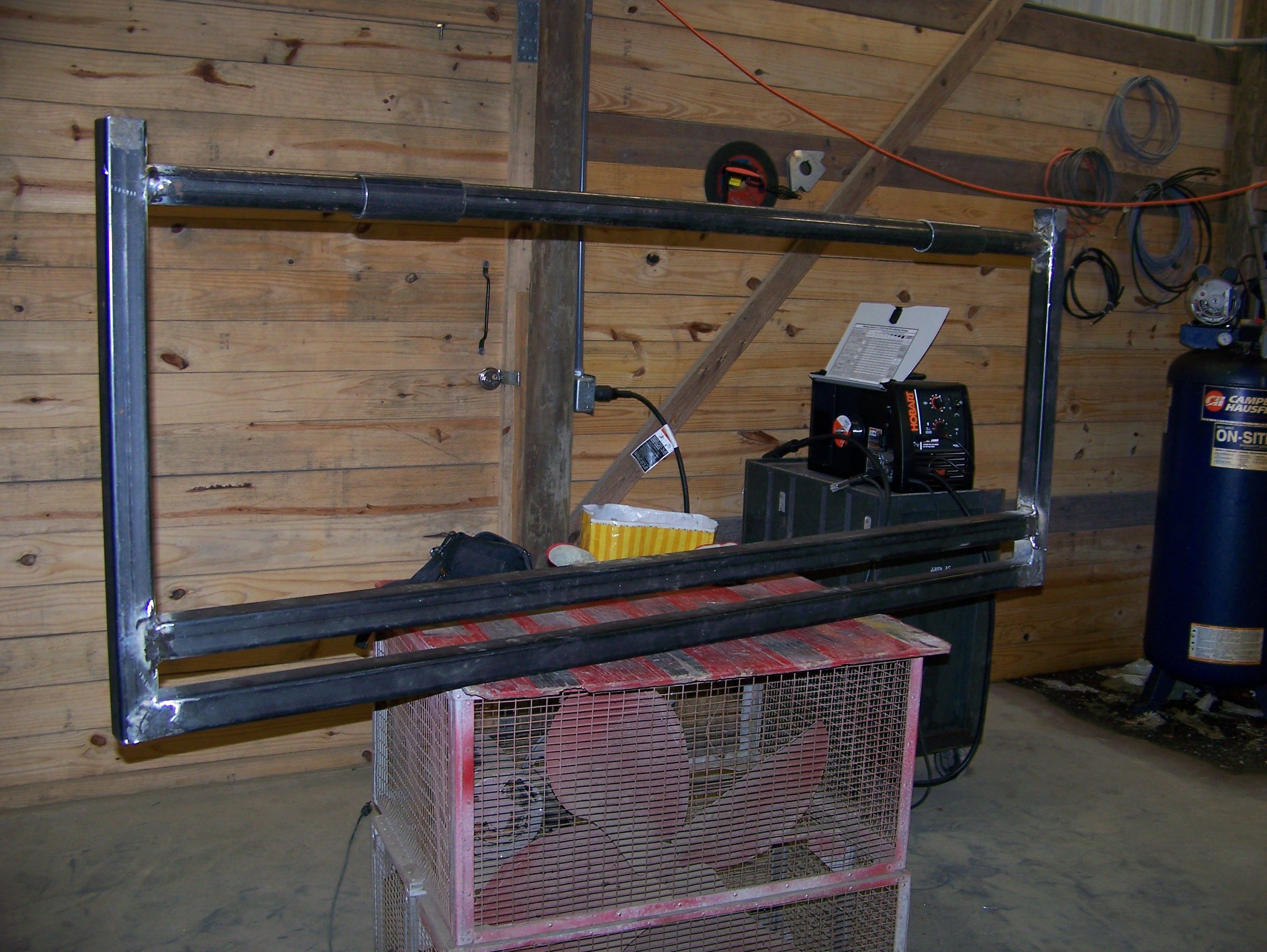

Since it is too wet to dig in the pond, I decided it was time to replace the neighbor's fence by the pond. This fence used 3 inch PVC pipe as posts. So first thing was to move the fence in sections on temporary steel posts. Then I started my first welding project with my new Hobart 210 MVP welder. I built a 2 inch square tube, 6 foot wide water gate. 1-29-17 Water Gate Gap Welded In Place.jpg When all is said and done, 1/4 inch steel plate will swing on it on 2 inch pipe hinges on 1.5 inch pipe. I thought bolting the 8 inch top cedar posts to the watergate in the barn would make everything easier. 2-10-17 Bolting Posts To Watergate.jpg Was I in store for a surprise. While in the barn, I drilled holes and installed 3/8 inch rebar sticking out 2 feet. 2-10-17 Watergate Post Rebar Detail.jpg The rebar will rest in a 12 inch wide trench on the downsteam side of the watergate.
