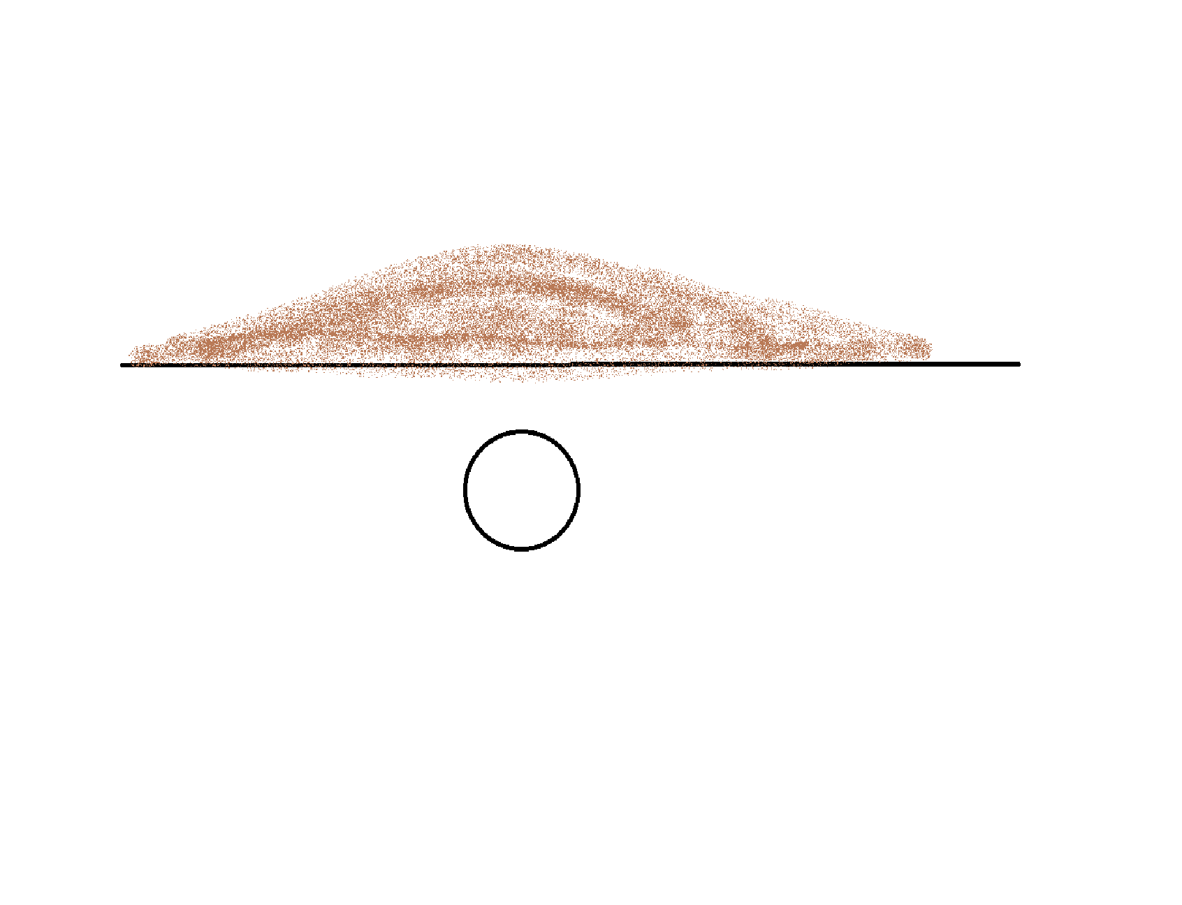

Put in HDPE. It will be good with your plans for normal driveway traffic. If you are worried about heavy traffic for a short time or one time drive then you could build up over the culvert with a "bump" to distribute some of the load and then after.
Either a bump or some planks. I crossed many 2-3 day old green sidewalks with both methods with some really big equipment. The greener the sidewalk the more fill or planks.
