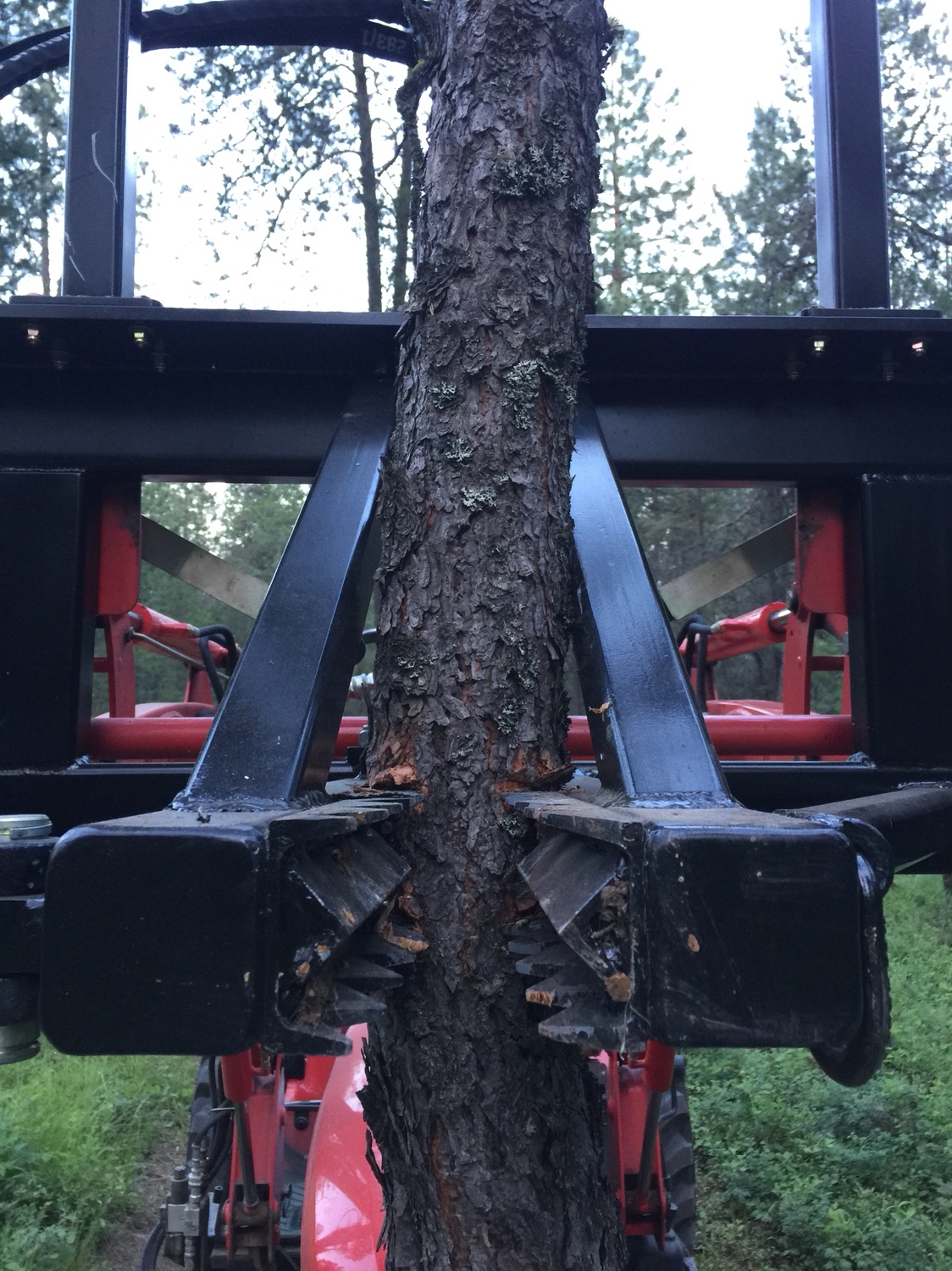

How about using a BB for ballast? Comes in real handy for smoothing an area after pulling a tree.
I agree with the idea of the double rows helping with tipping. I consciuosly pay attention to tall trees to make sure they are leaning away from me.
I think we talked about this. Be very cautious about pulling/prying on a tree while trying to move backward. Puts loads on the FEL and curl cylinders they are not built for.
When I like my puller on 3pt the best is when clearing a large area with only a few trees. Allows me to carry them away with the grapple.

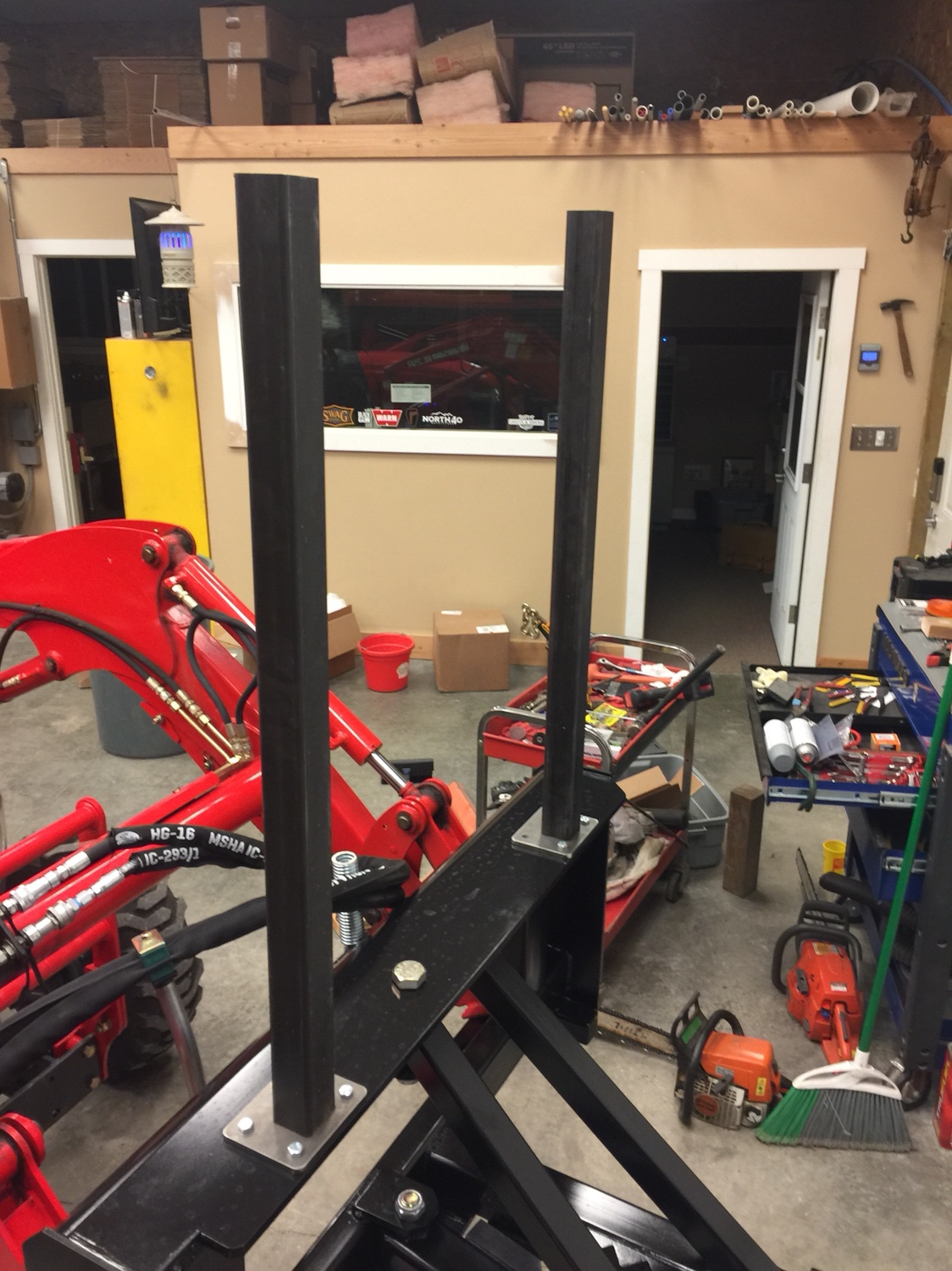

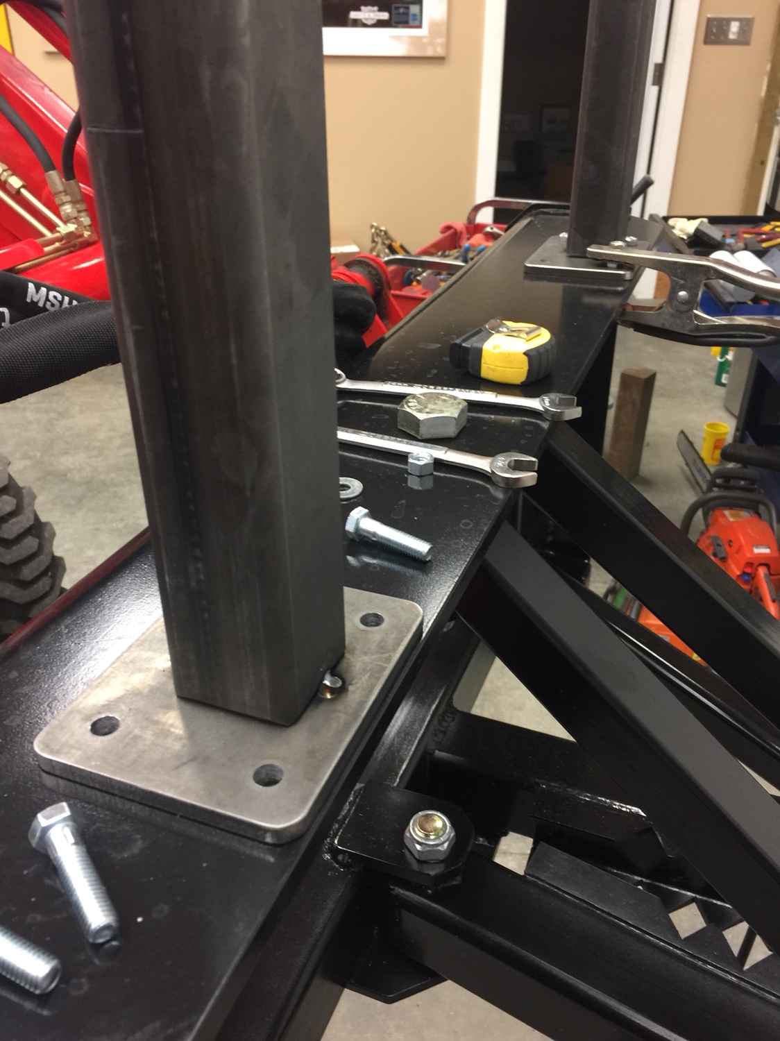

All done! It was a fun process. In the future if I build more implements, I’ll be a little more wiser but I can’t complain about this as I’ve thought out everything carefully.
Latest process on the build of the guard.
The finished product...

Looks good. :thumbsup:

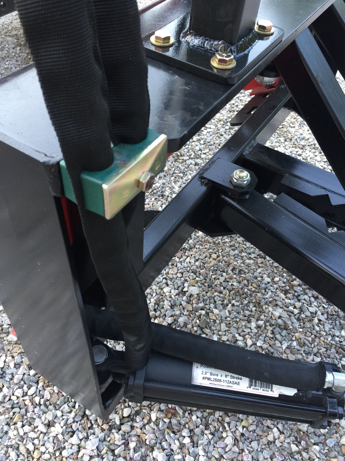

All done! It was a fun process. In the future if I build more implements, I値l be a little more wiser but I can稚 complain about this as I致e thought out everything carefully.

That is very nice. Clean looking.

It turned out well! Nice attention to detail
