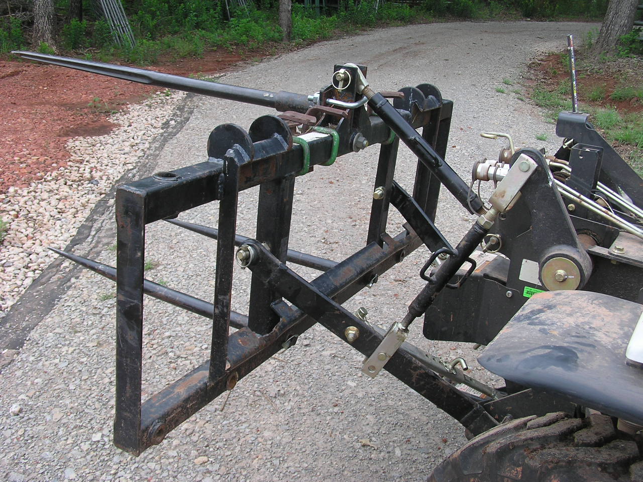

I built a land plane with SS on the back & 3pt on the front, but I'm guessing that you have only 1 "side" to work with.
That brings me to a 3pt to SS adapter I made.

Got a picture?
I've never seen a "dual" set up will take either one, doesn't mean it's not out there.:thumbsup:
That is rather clever. Doesn't it really suck using SS stuff backwards though?

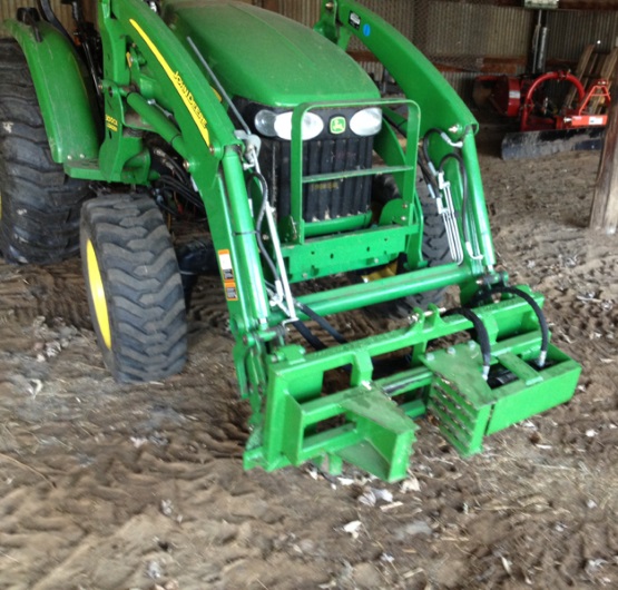

I modified my Land Pride forks to both fit my SSQA FEL and it's 3PH. It's not QA-compatible though, due tom having the 3PH lift arms clear the SSQA attachments on the tractor. :(
I modified the forks so I could carry an IBC full or nearly full of water.
Pics:
It still works on the front end, as you can see here with my IBC-cage work platform, installing shop lights in my shop.

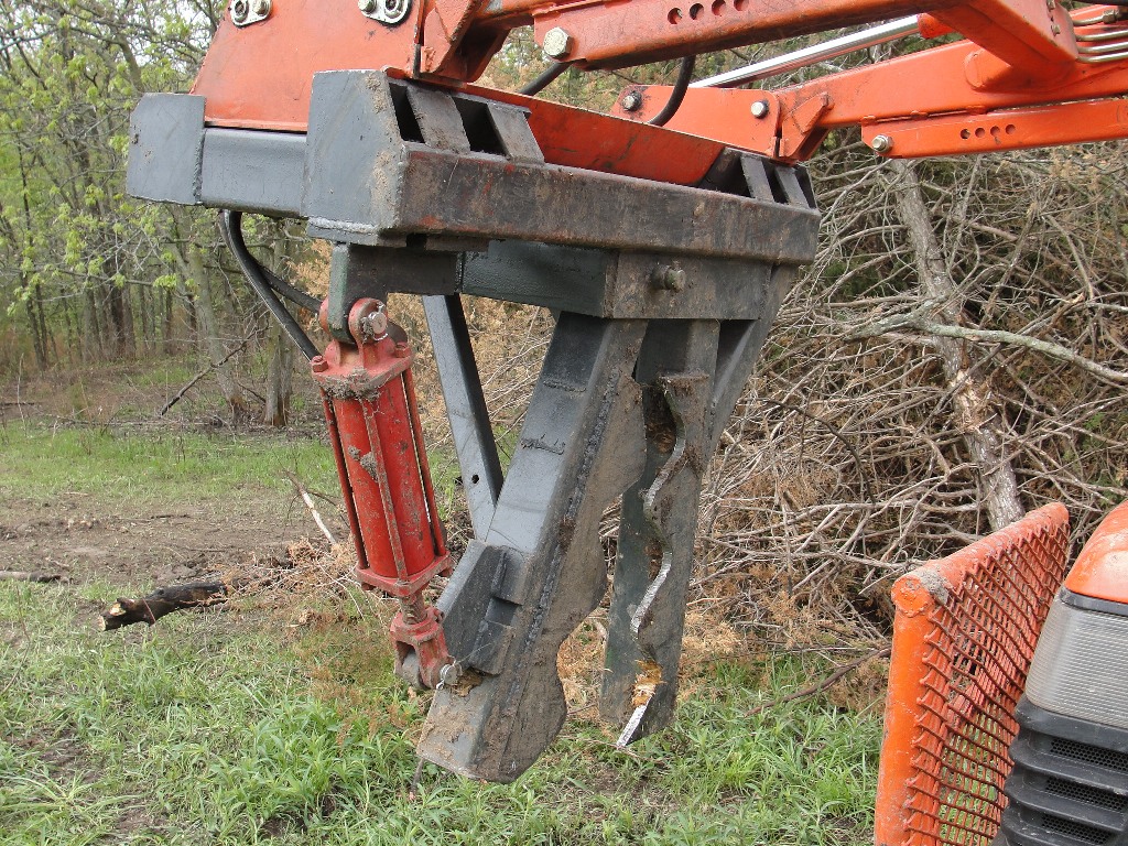

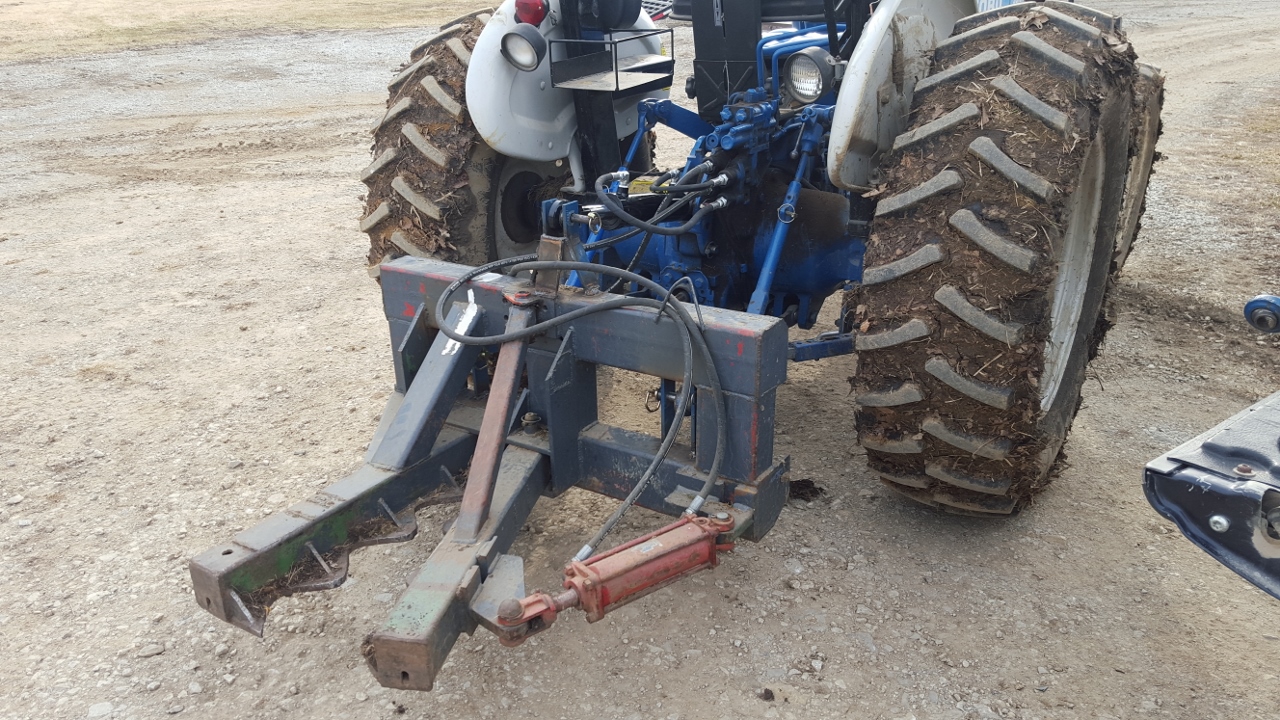

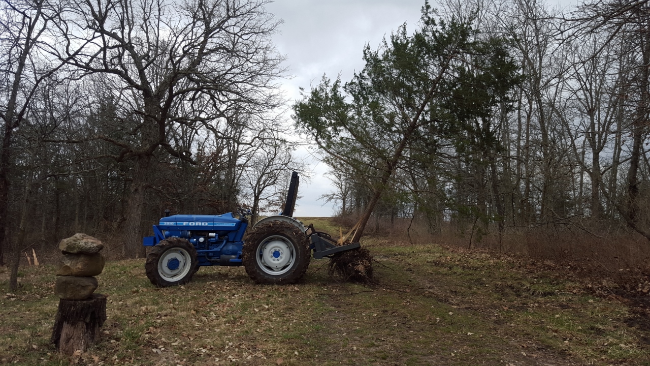

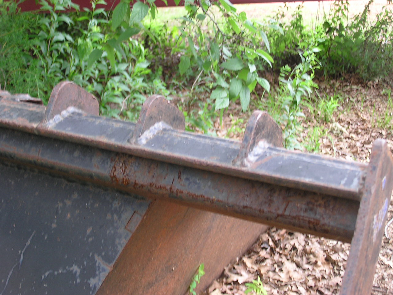

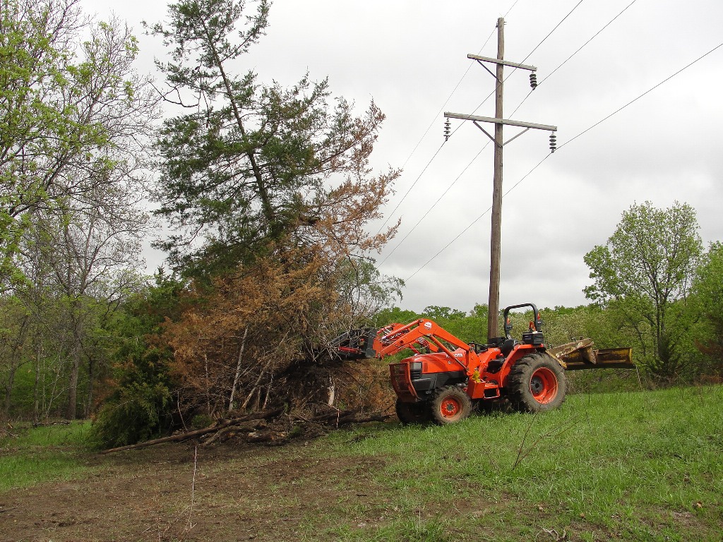

I built this tree puller to fit my SSQA FEL. Few years later I got a second tractor and wanted to use the puller on the 3pt. I added some simple tabs that aren't in the way of the SSQA. Works like a champ. To effectively use it on 3pt you need a hydraulic top link.
Sorry for the poor pics of design.
Could you clarify this? (It fits your SSQA FEL but it is not QA-compatible) thanks.

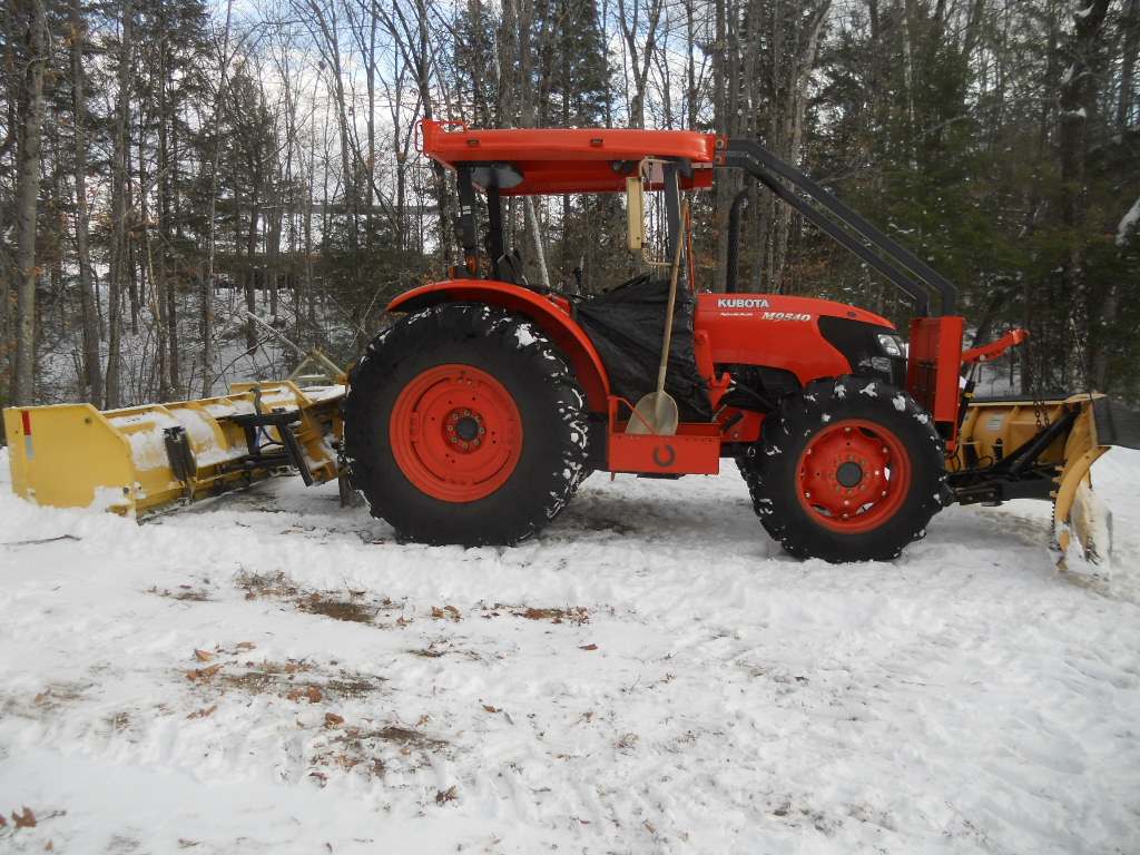

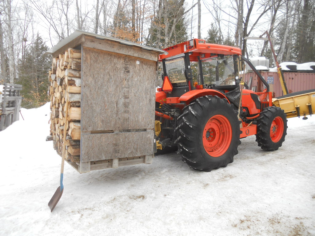

I built it for my JD that had their own style "quick hitch" that limits you to JD $tuff only. Traded that in for the Kubota with a ssqa, so it just was scrap metal to me at that point so I made it work on the 3 pt. It's handy for the forks when the loader is off for the winter (frame mounted snow plow), and I've played around with another plow on the back plowing each direction. Sometimes I'll put a bucket on to carry tools but I really don't use it much to be honest.

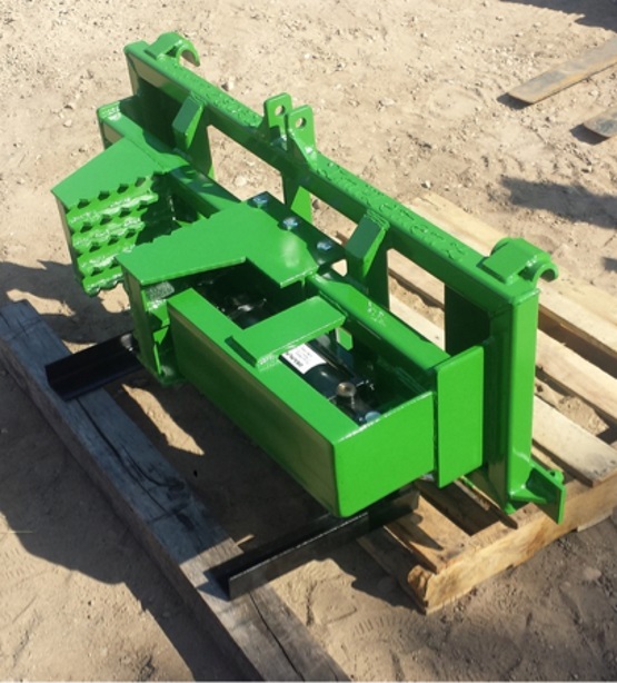

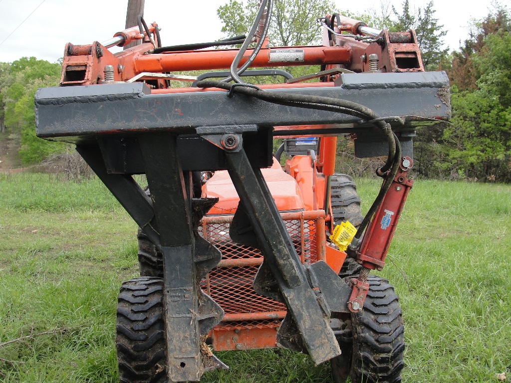

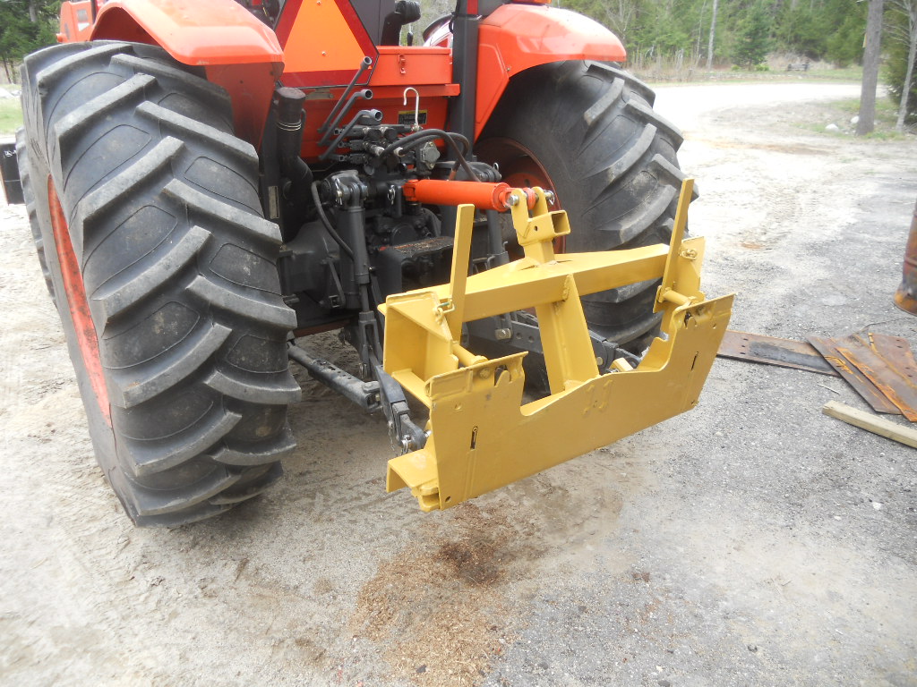

Call and ask if they will build you a plate for both ends: Buckthorn Puller - Custom built Skid Steer attachments to fit almost any need you may have.
Here is the puller they built for LouieJunior, notice the 3 point top link connector on the JD QA frame: http://www.tractorbynet.com/forums/attachments/318149-tree-puller-pleased-my-new.html#post3845905

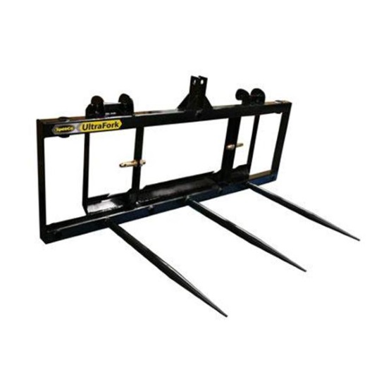

If you build one copy this design:
