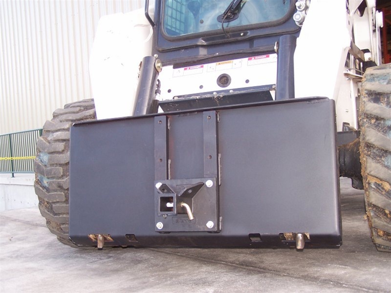

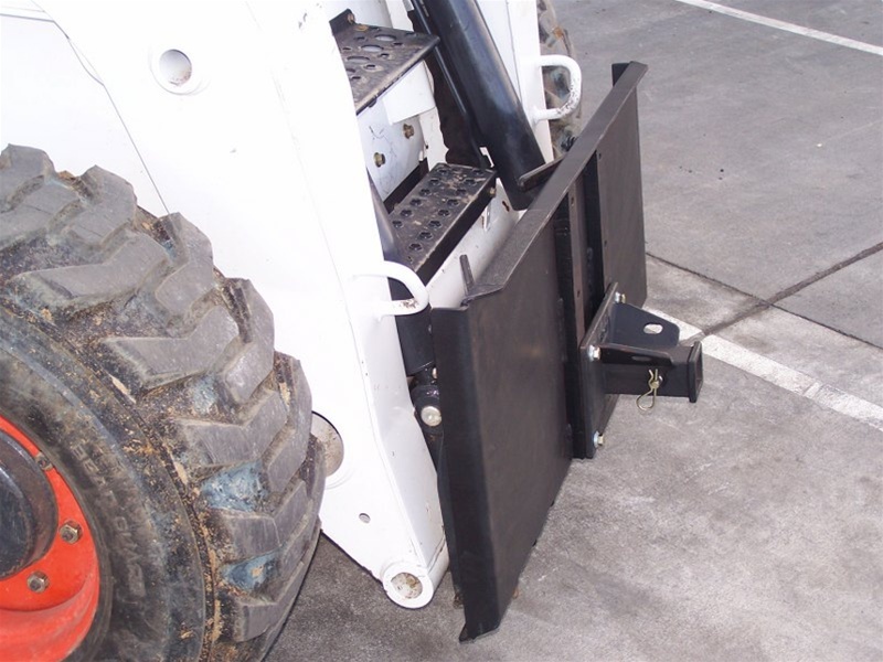

Terry was commenting on the price of the Cushion Coupler gooseneck hitch.

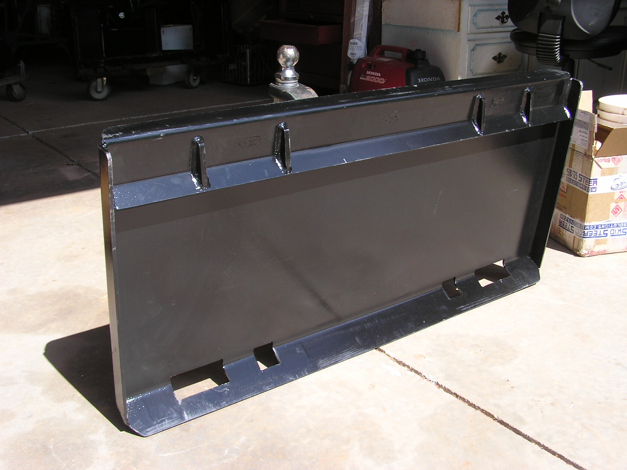

Skid Steer Solutions also makes a single receiver hitch on the strongest backplate that I have ever seen.
360_15__62886.1407974526.1280.1280.jpgHT_01_BP_3__06837.1407974551.1280.1280.jpg HT_01_BP_5__35973.1407974484.1280.1280.jpg
The hitch will bolt on the top set of threaded holes also.
View attachment 393188View attachment 393189 View attachment 393190
I've got an ETerra backhoe attachment for skid steers from Skid Steer Solutions and it seems pretty well built. $295 is a little (OK, a lot) more than I'm willing to pay for a SSQA hitch receiver when the setup I have works just fine for my occasional use. It also gives me an extra use for the fork carriage.
If I had a large lot and had to jockey several trailers around often I would consider the other unit for sure.

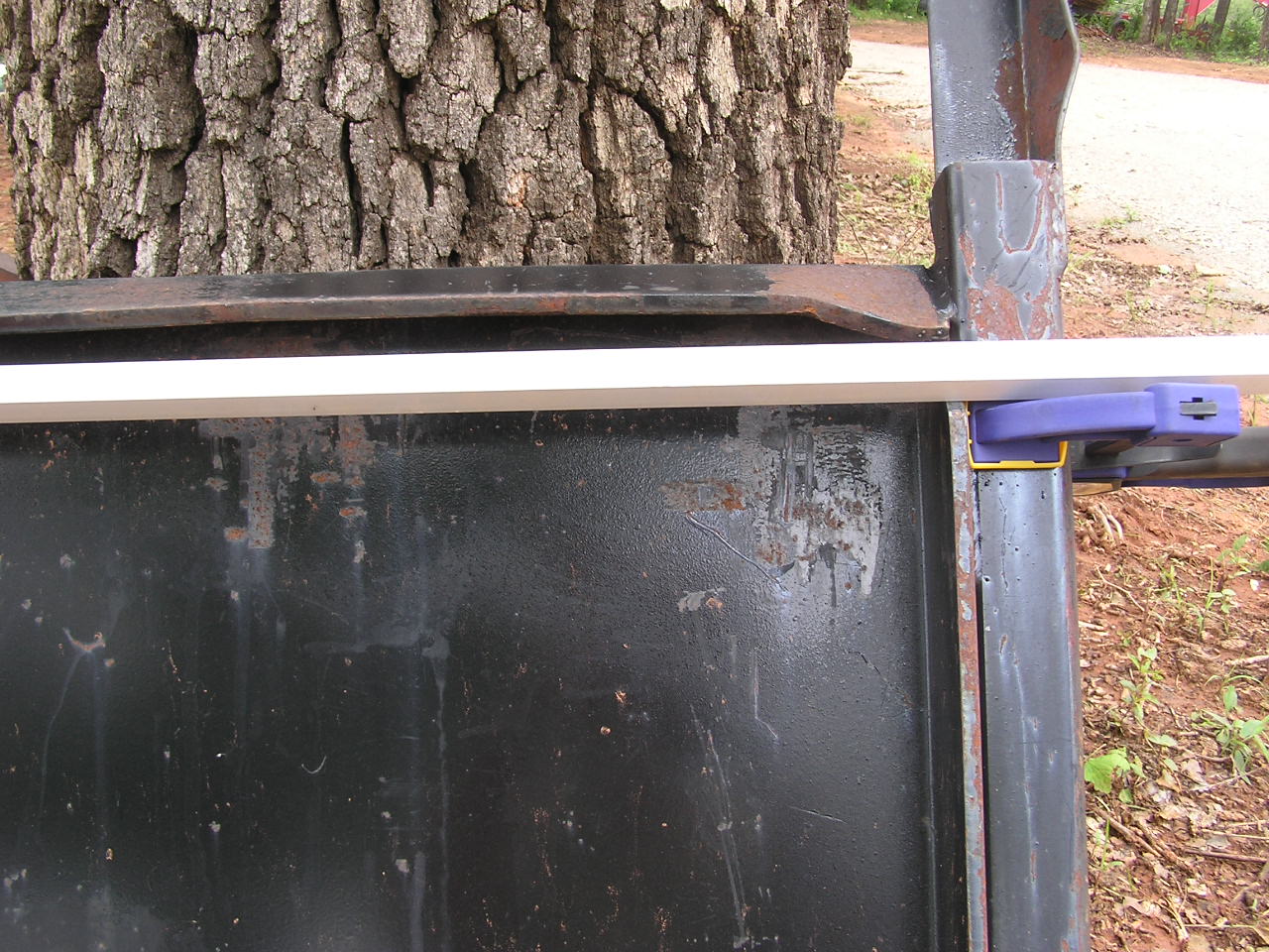

I haven't seen one with the gussets at the top.
<img src="http://www.tractorbynet.com/forums/files/attachments/393206-dual-hitch-receiver-mount-ssqa-p9190042-jpg"/> <img src="http://www.tractorbynet.com/forums/files/attachments/393205-dual-hitch-receiver-mount-ssqa-p9190038-jpg"/>

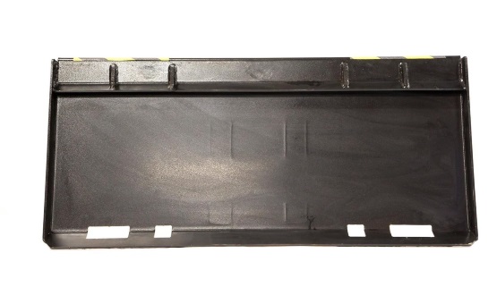

That is a nice feature and the plate is taller. I have my eyes on this beast if a plate. 1/2" thick
1/2" Attachment Mount Plate Skidsteer bobcat kubota (12 MP)

The one you linked to has a 3/8" top plate, but no gussets.

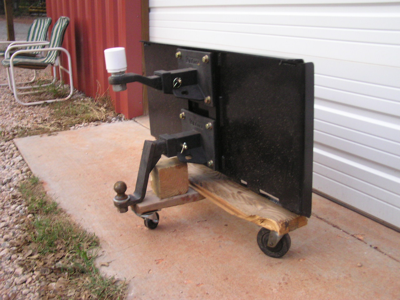

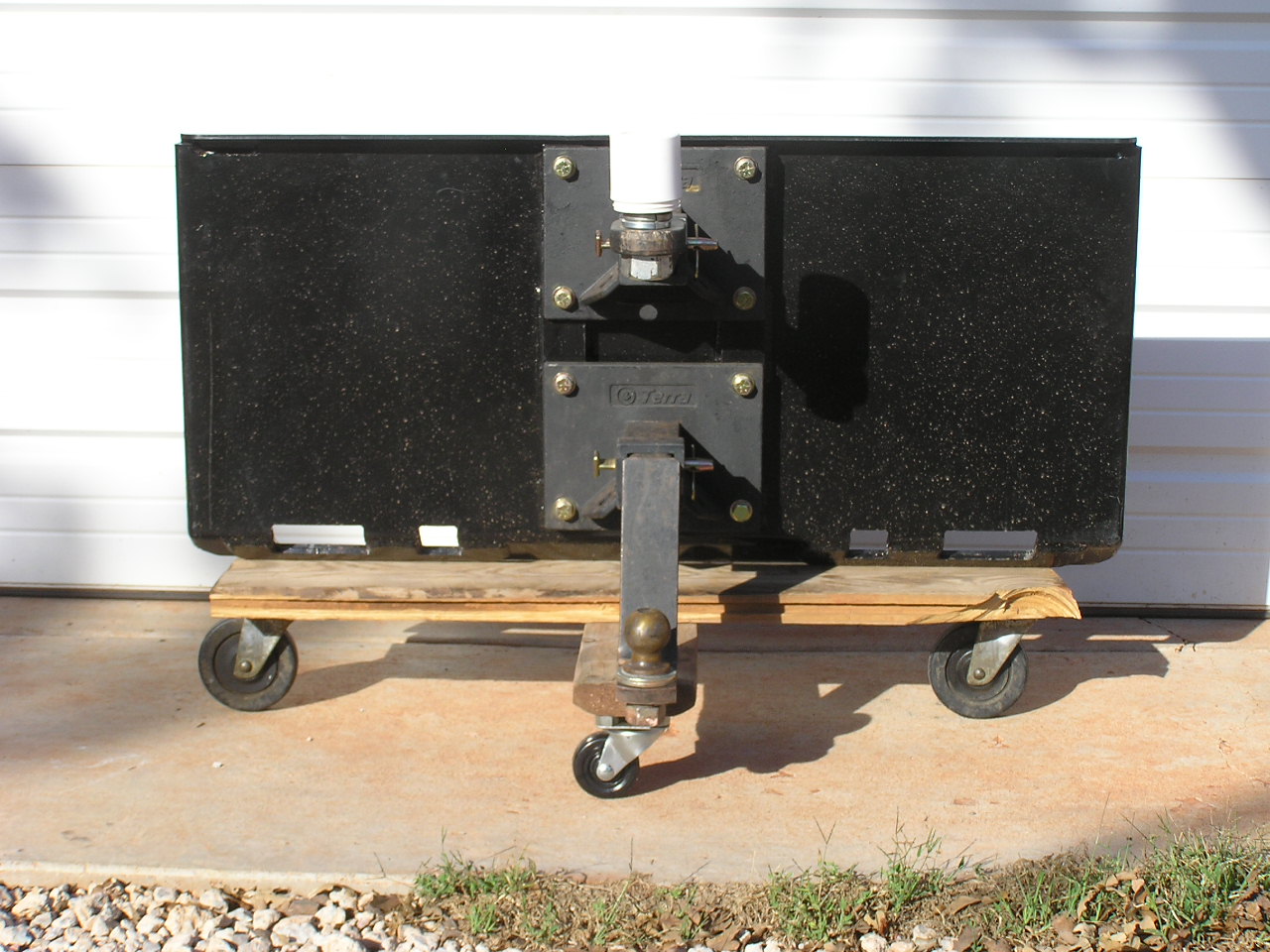

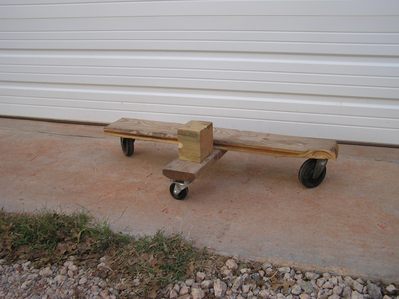

Made a dolly for the hitch.

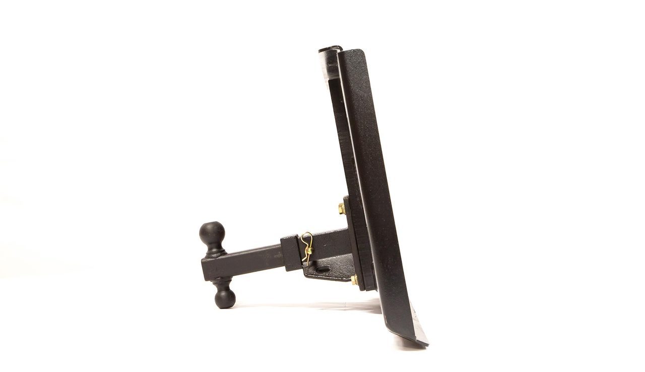

Update to this old thread, still using the Dual Receiver Hitch. New link: Eterra Hitch Dual Attachment for Skid Steer Loader | Skid Steer Solutions
Price has gone up but with the gussets, it is still the strongest one that I have seen:
Added to the dolly so it would work without the drop hitch in the bottom receiver:
And with the drop hitch in the bottom receiver:
