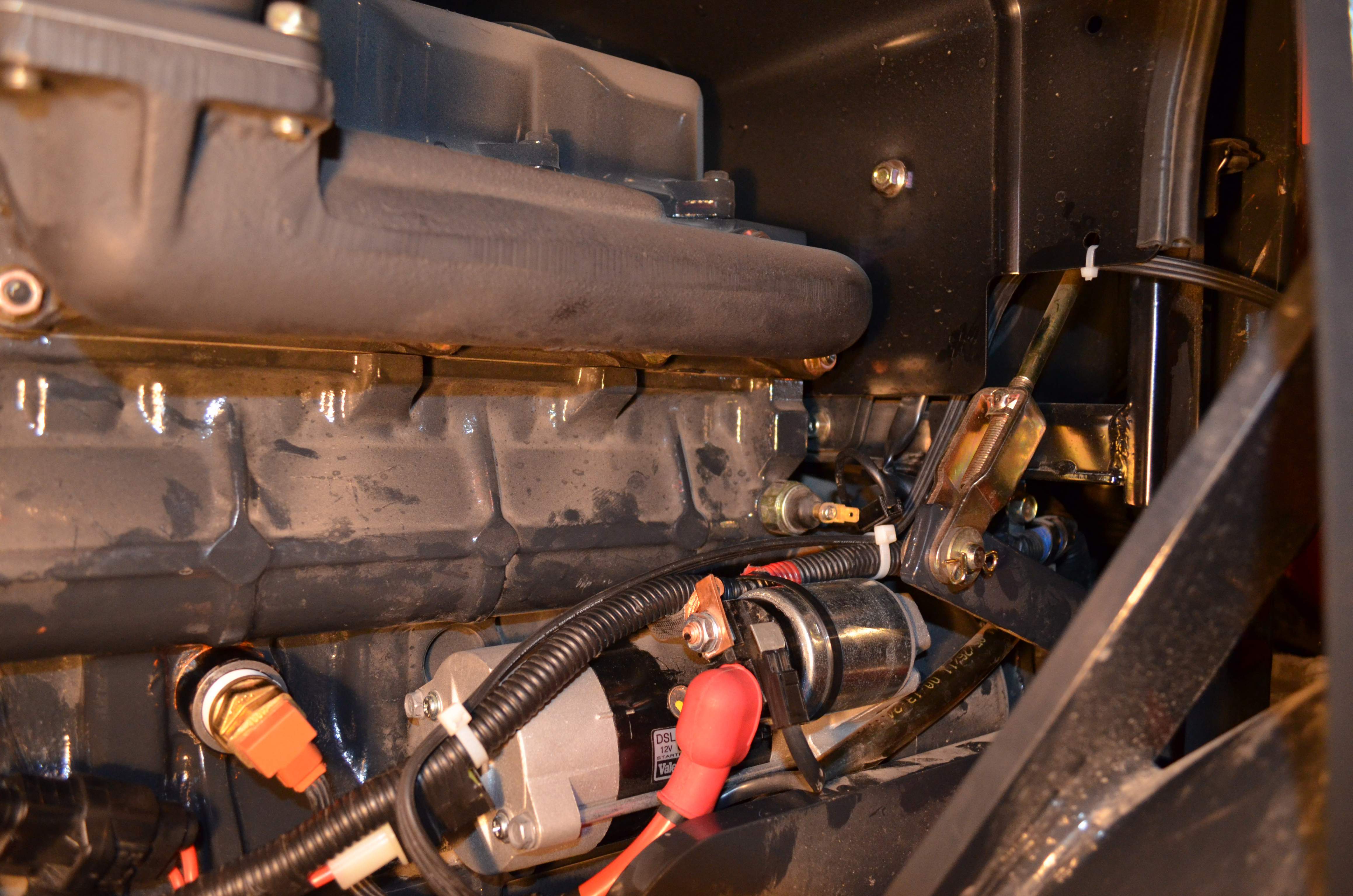

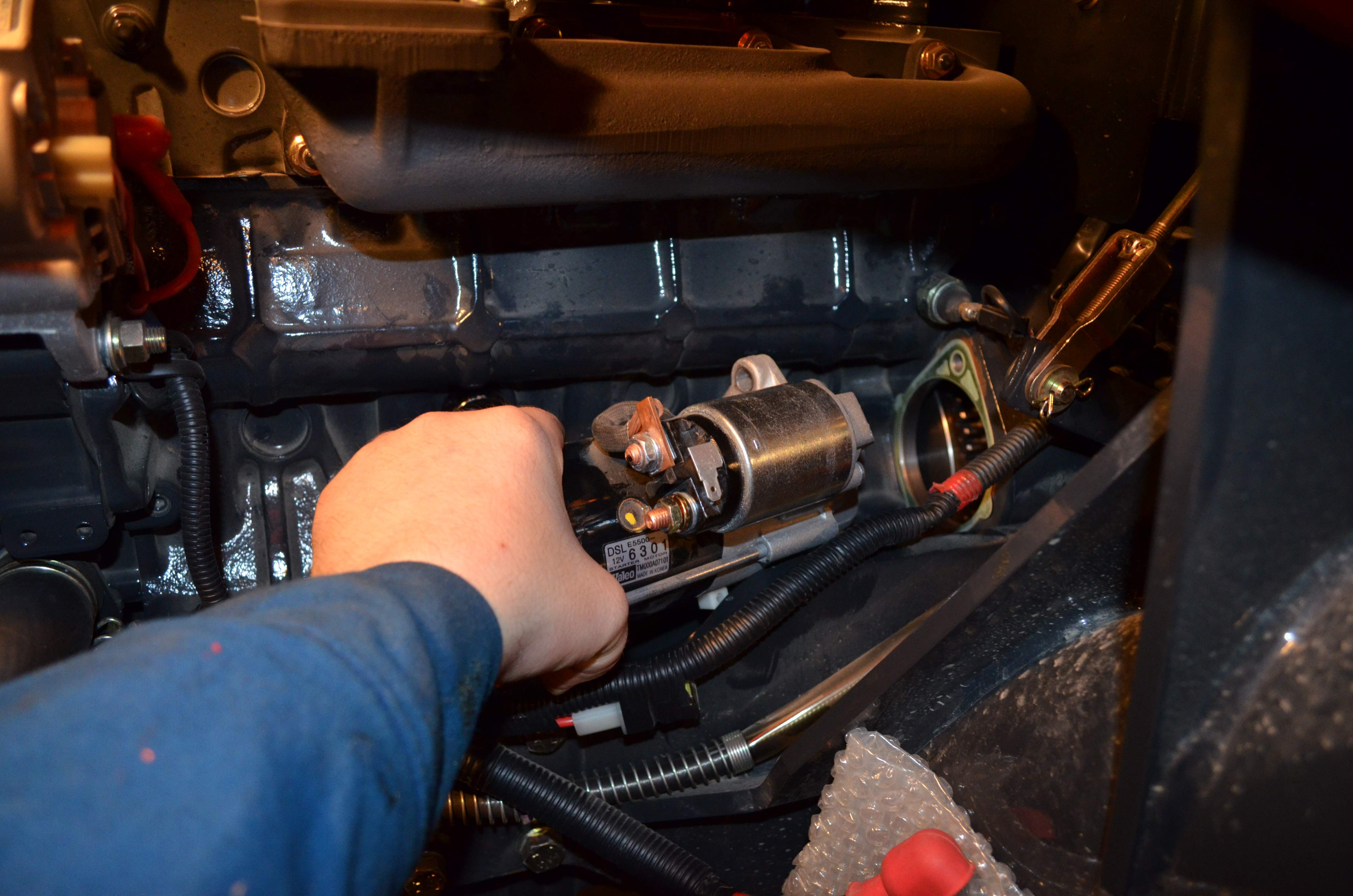

Hi!
I'm new to this Forum. I own a DS4110 since last May and very happy. I will buy a snow blower (I've bought a 75" Meteor, but I saw some bad review on it, hopefully mine will be fine) and I decide to install a block heater. I've reading on the subject and some people seems to have issues with theirs pooping out. Hopefully won't happen to me. Since there are no instructions provided with the block heater I will post what I did, and maybe will help.

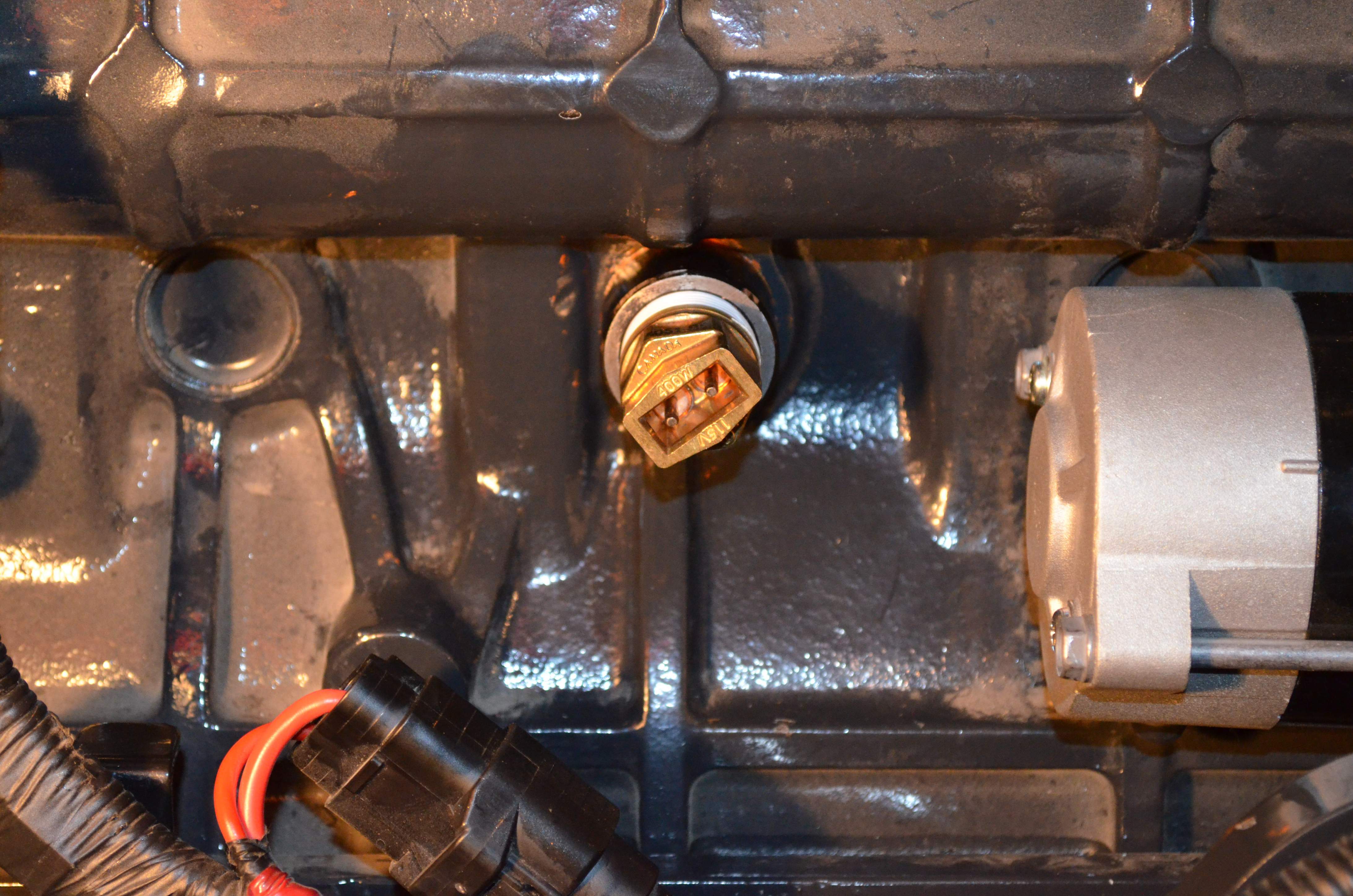

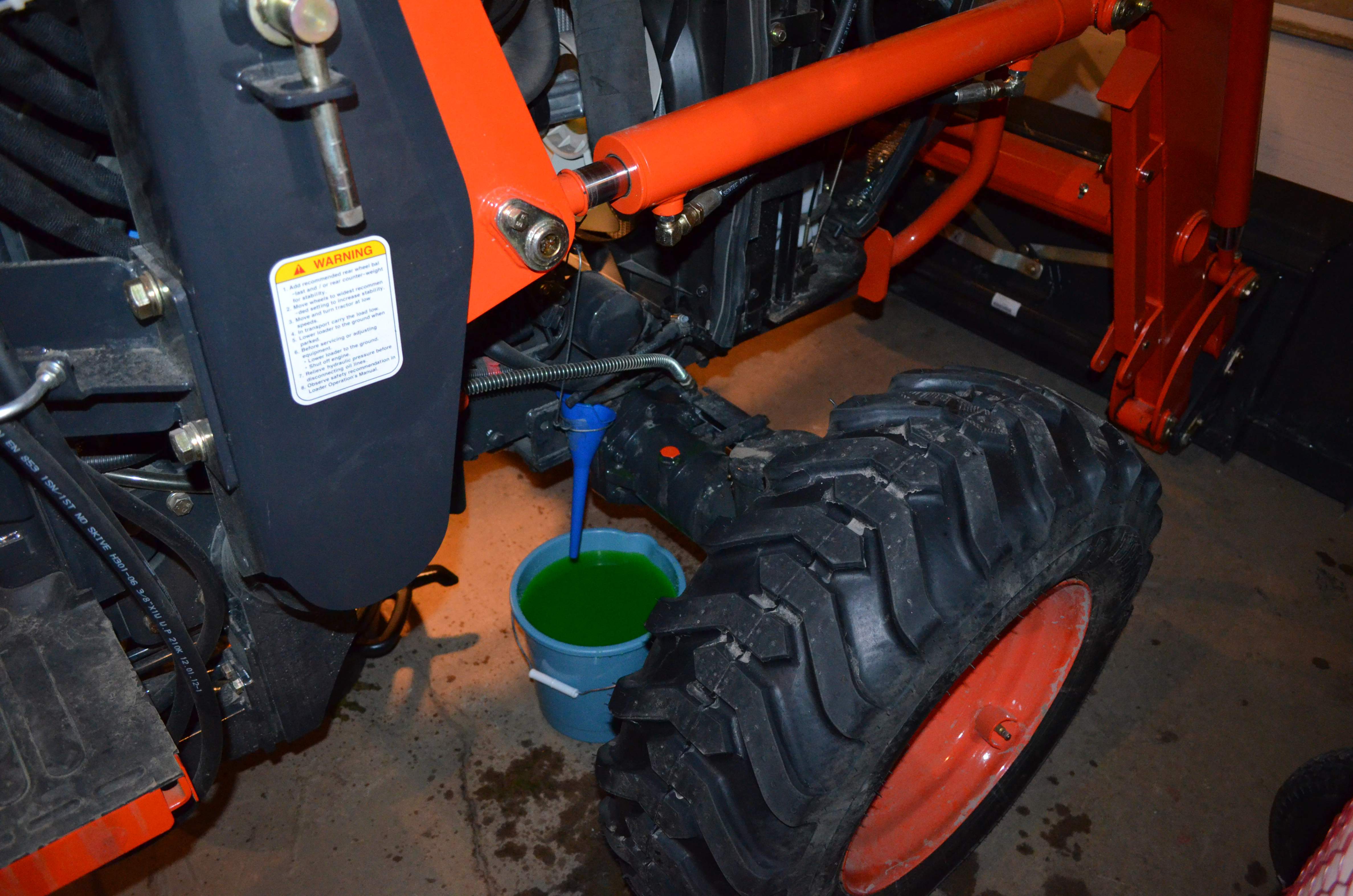

My first step was to empty the coolant. There is approximately 8-10 Litres.

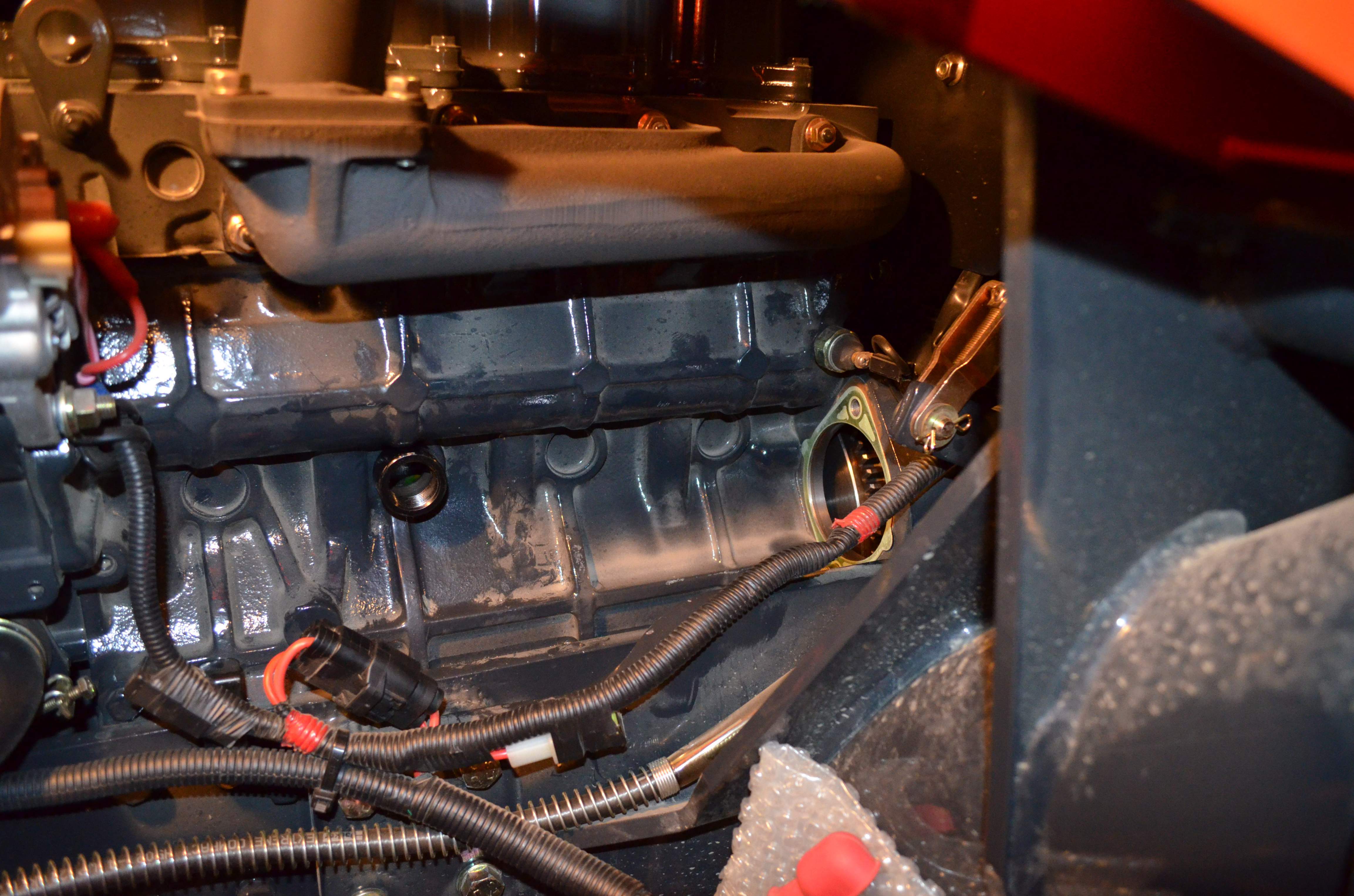

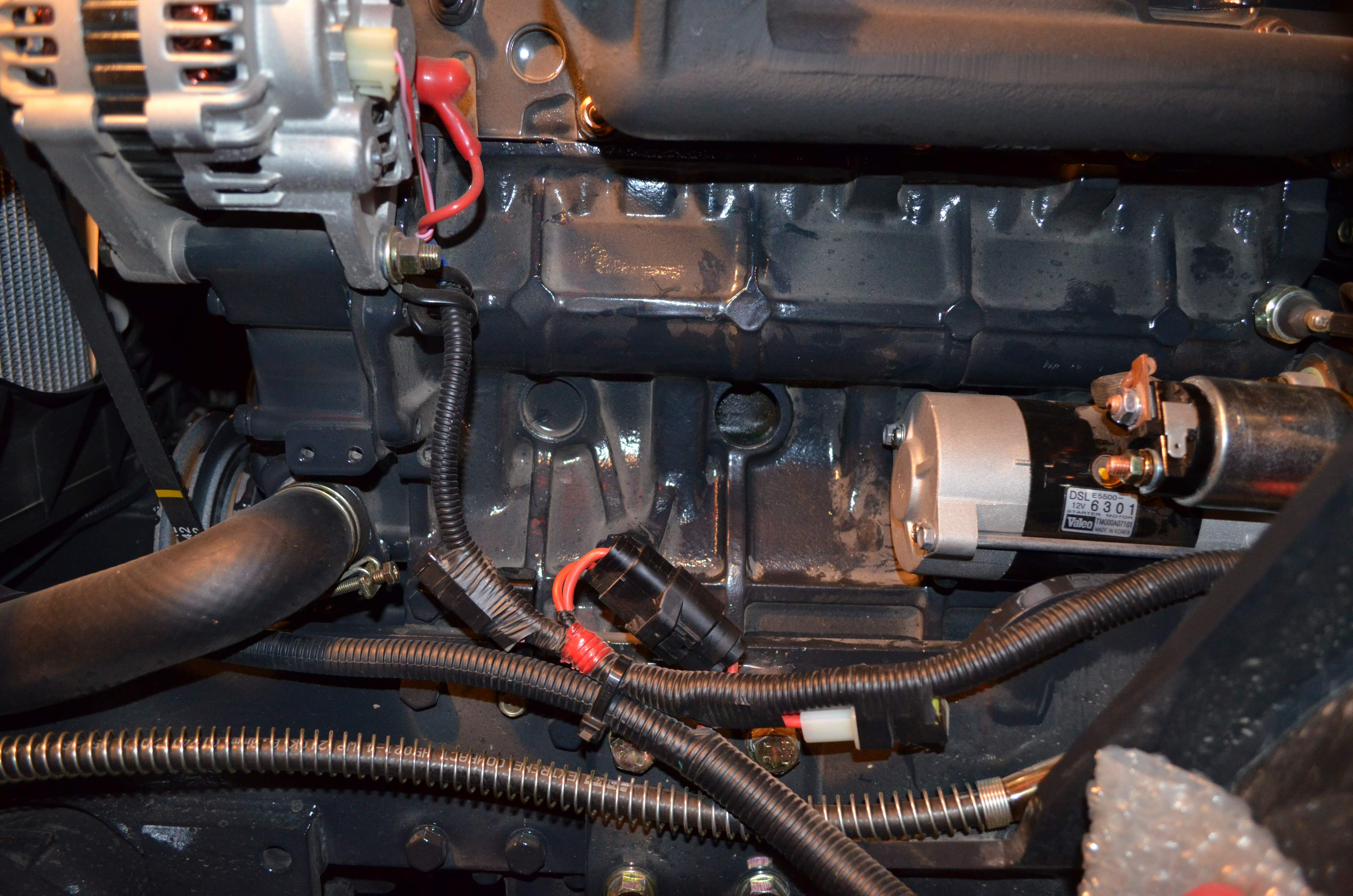

After, I wasn't which freeze plug to remove, and I want to make sure I'm able to remove the starter without problem. So I did the exercise, I install temporary the bushing and look if the starter can be removed (I unplug the battery before).
The starter can be removed no problem.

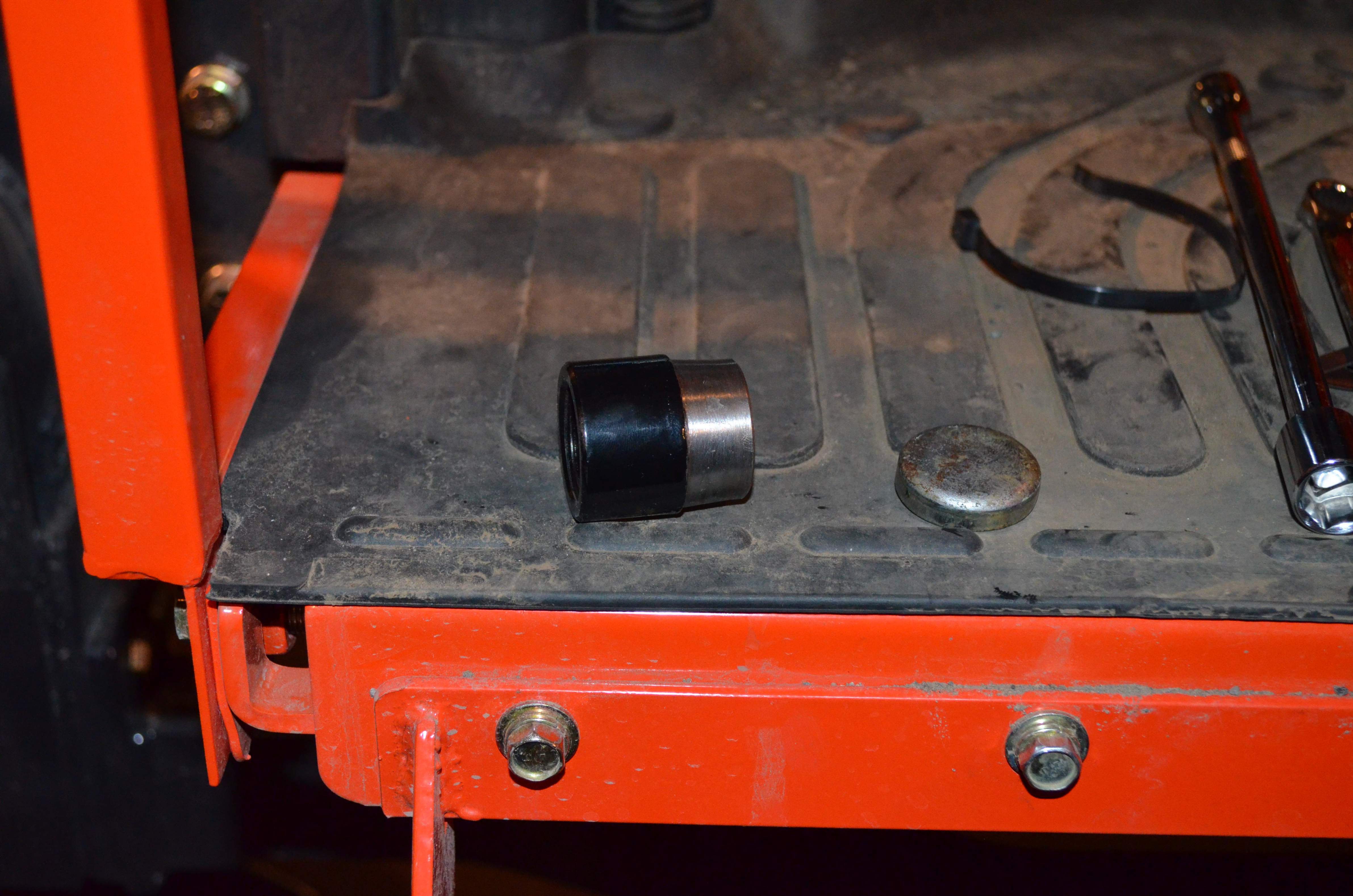

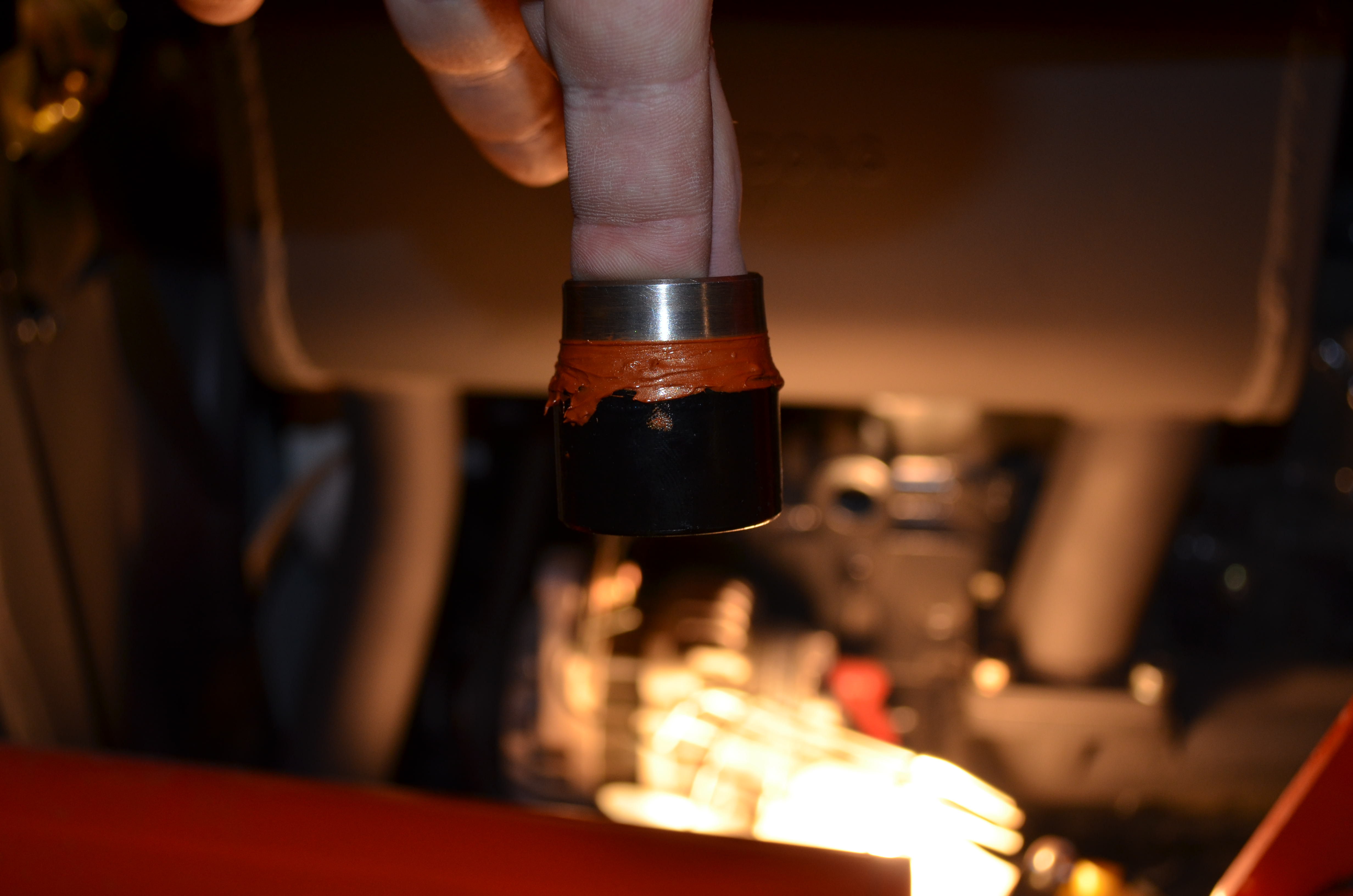

Next is to remove the freeze plug. It is quite easy, you have to gently hammer the top of the plug and it will start to pivot, than you remove it with pliers by pulling the bottom. You need to dry the block and clean the area where there will be the bushing.
The next step is to clean the bushing and apply Permatex red thread locker or high temp silicone(I use silicone)

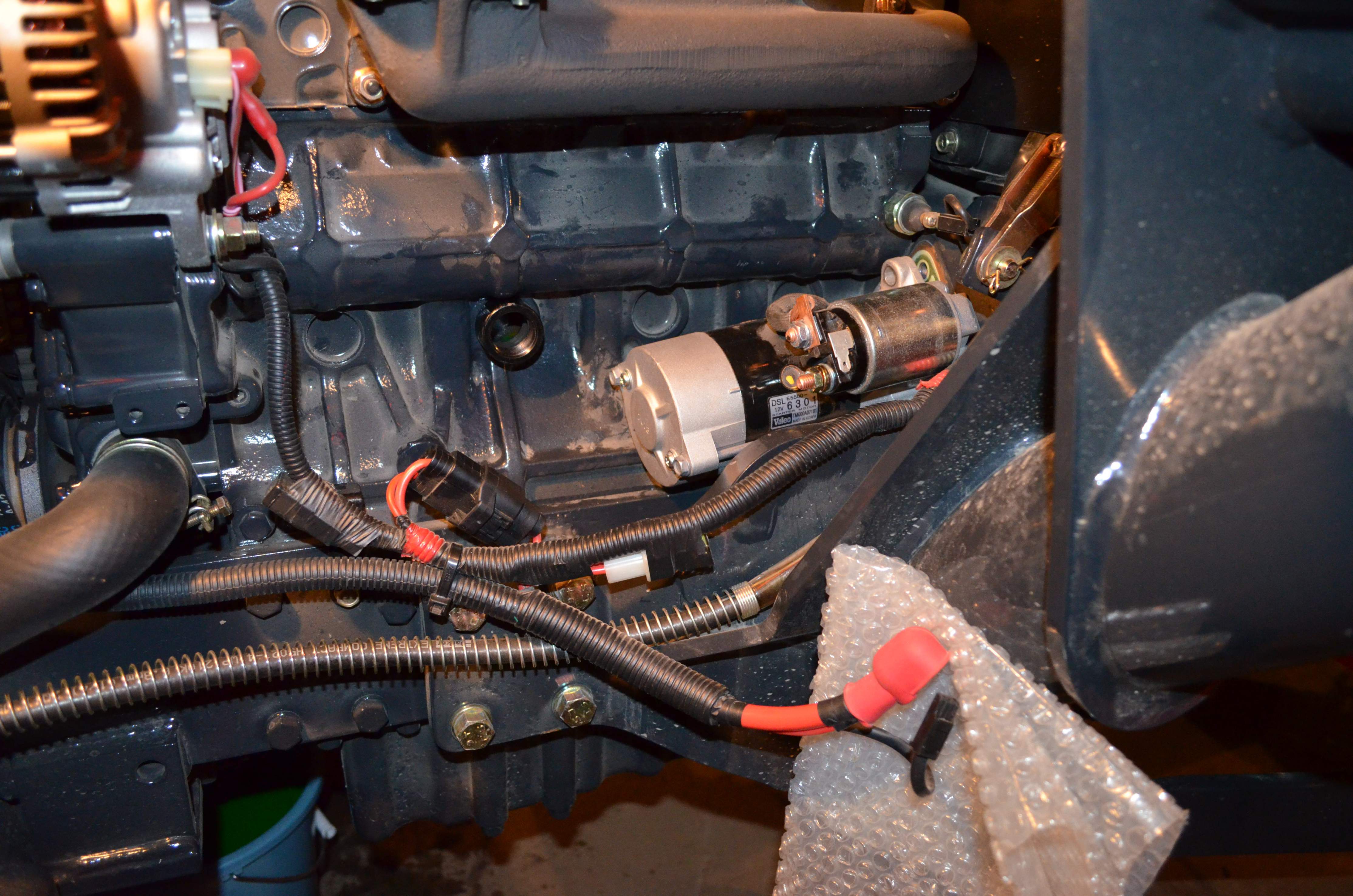

Install the bushing with a hammer and socket and an extension or in my case I have a bearing installer. Than install the block heather.

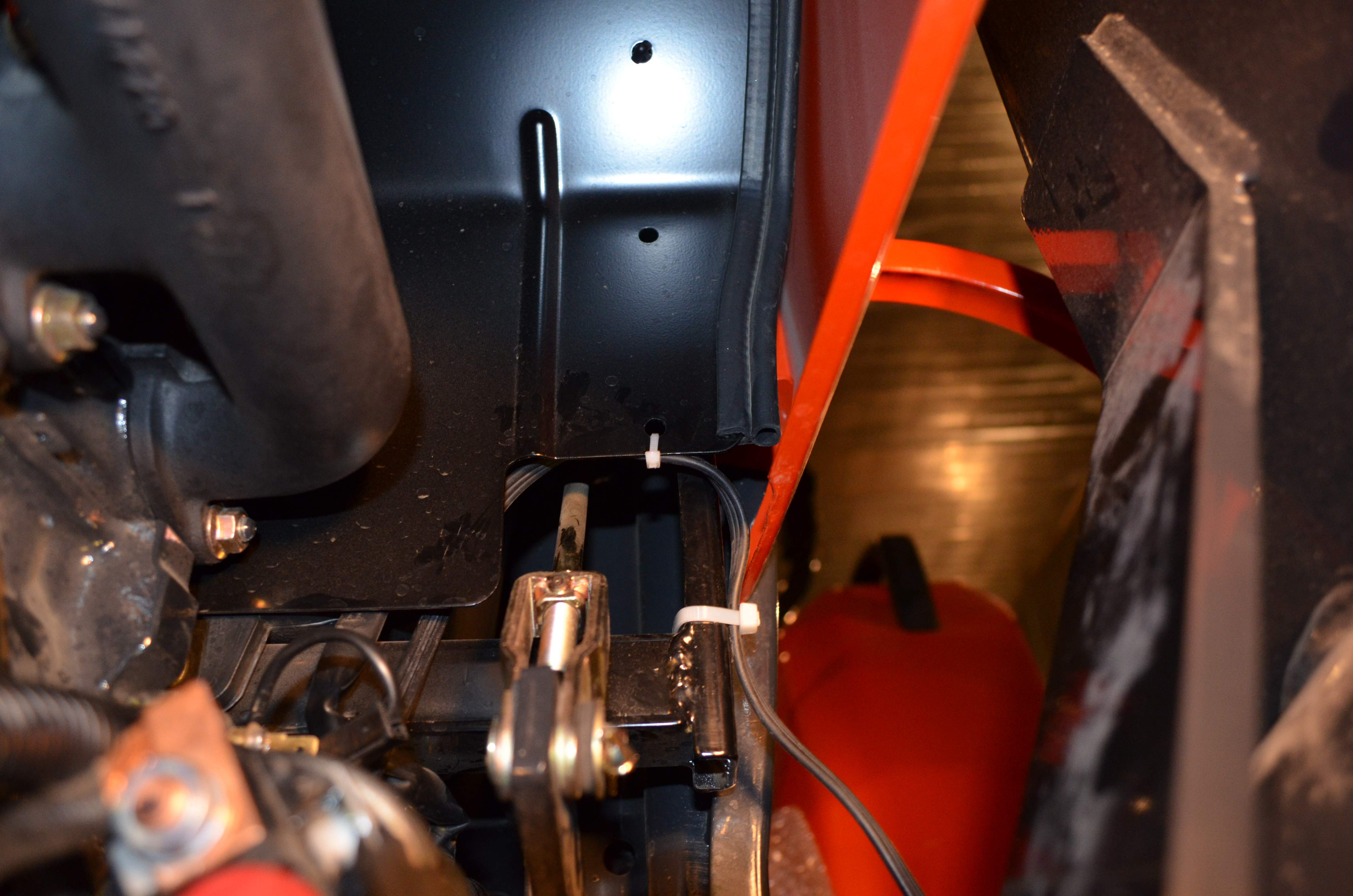

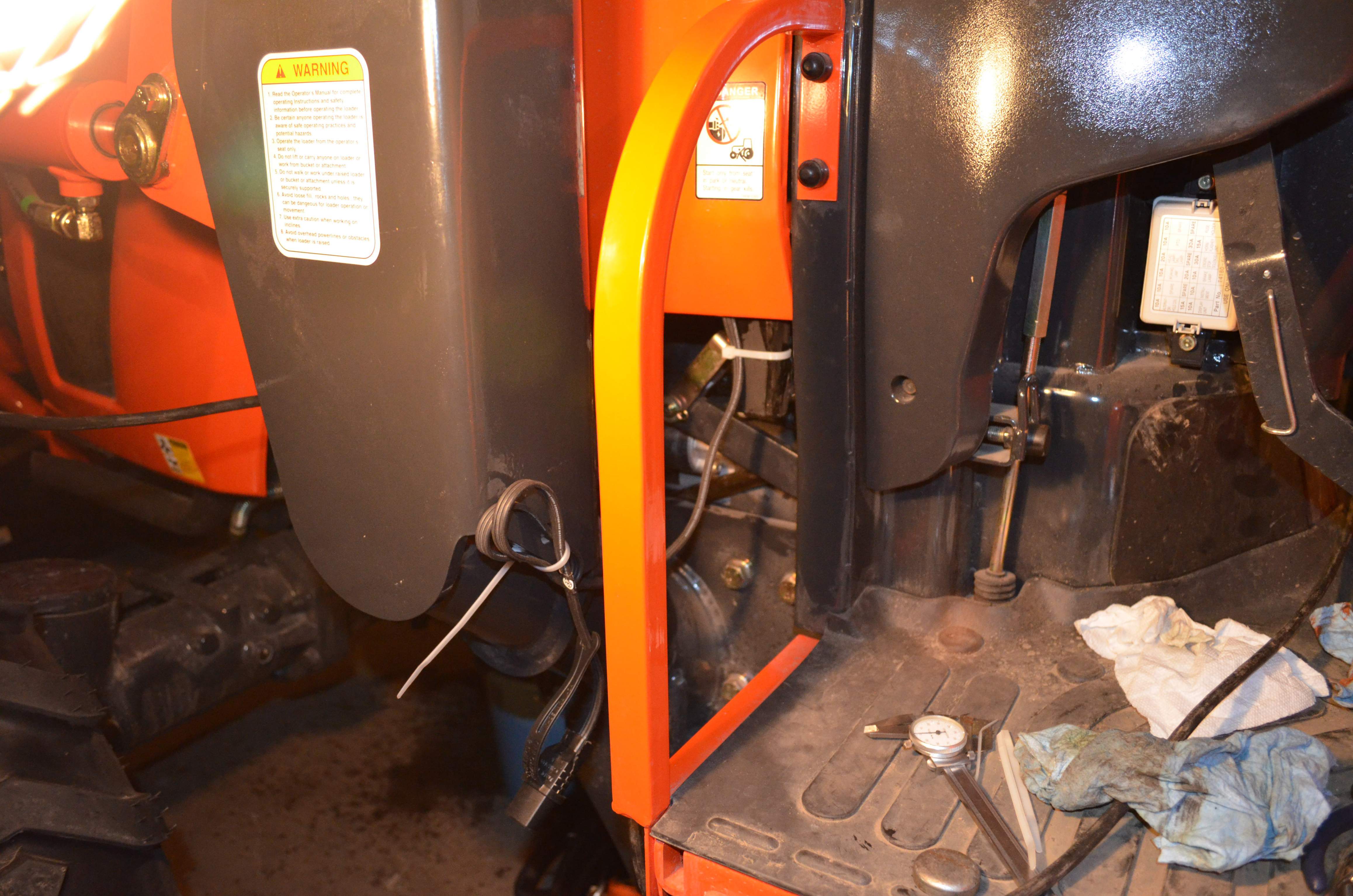

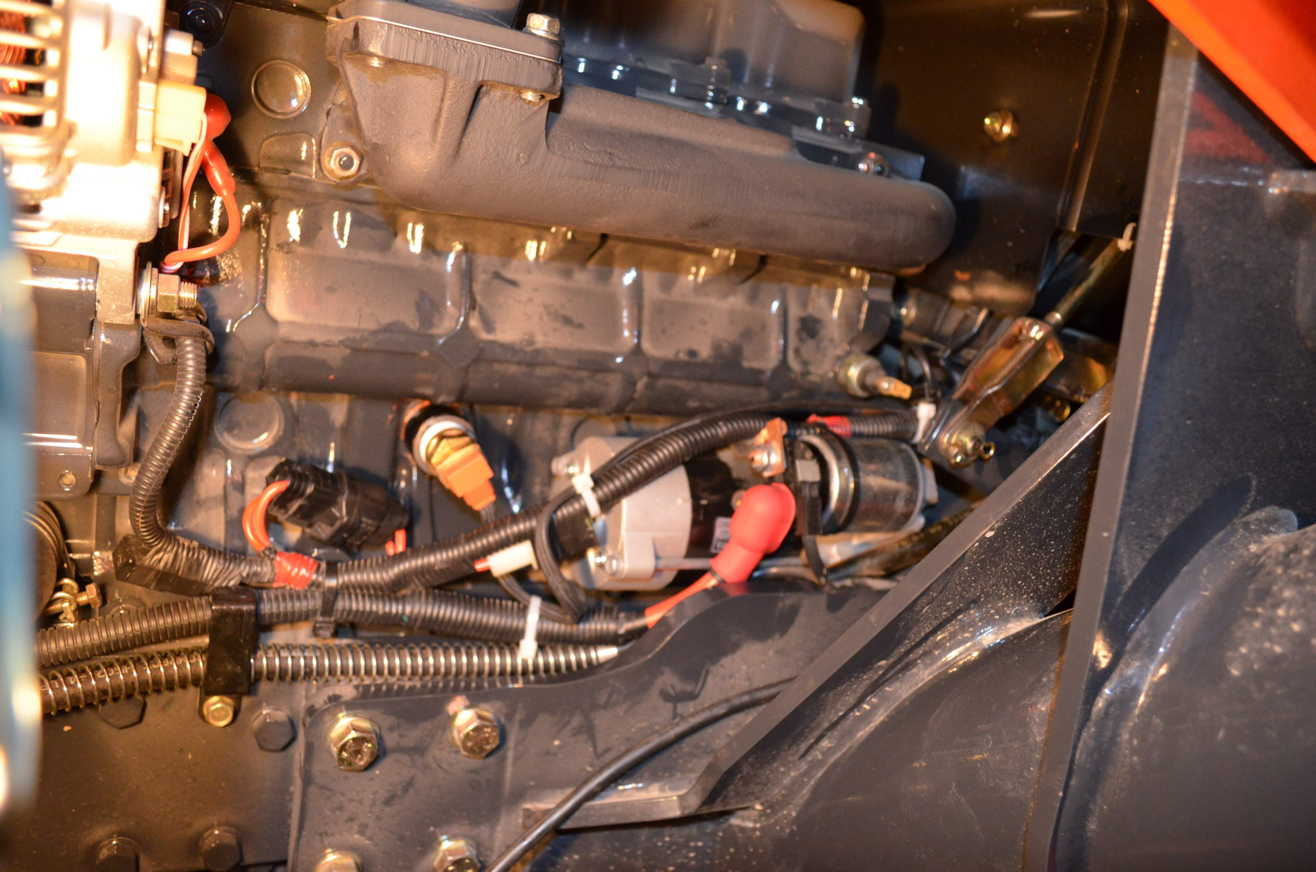

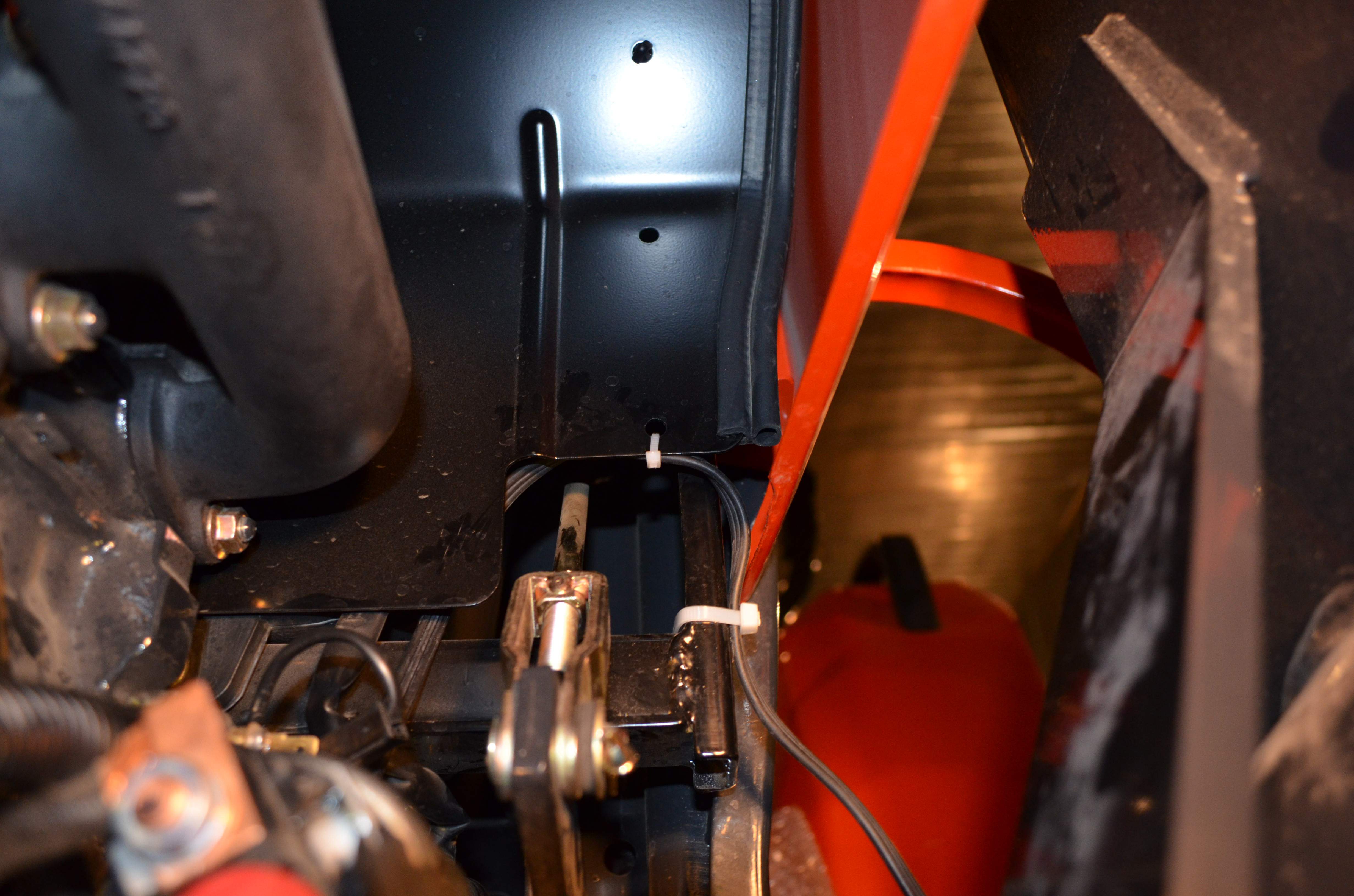

And I tie the wire as follow
Make sure the wire is not rubbing against the panel.
Let's hope it won't pop out. I tried it and it seems to hold so far.

I've been letting it running for a while 15-20 minutes. As soon as the level started to get lower, I was filing it, but then start to expand. I put the cap back. I let it run, but doesn't seems to want to warm up. I used it a little bit, but I don't think it was enough, when I touch the block, I could leave my hand there... I will let it cool down over night and do the exercise with your advices tomorrow.
My dealer told me to put it on the driver side, but didn't mention which one. I've measure the dept, and the end of bushing is within the block thickness, it doesn't block the passage. Do you have a block heather on yours? Where it is install?

Yes, it's on the same side, orientation is from the operator's seated position, so driver's side would be left, in N. America, at least.
My model is the DK series, but it looks basically the same...

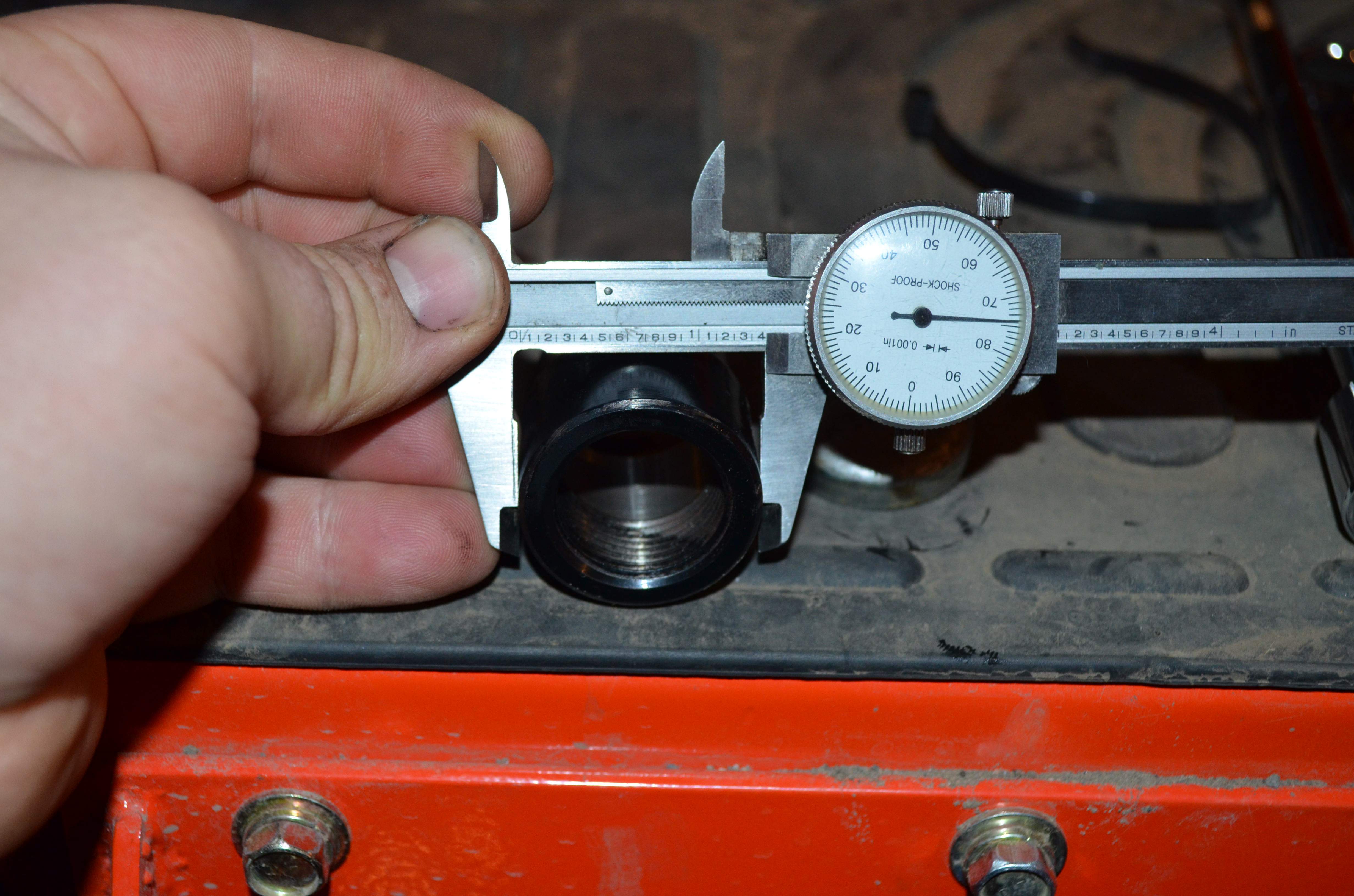

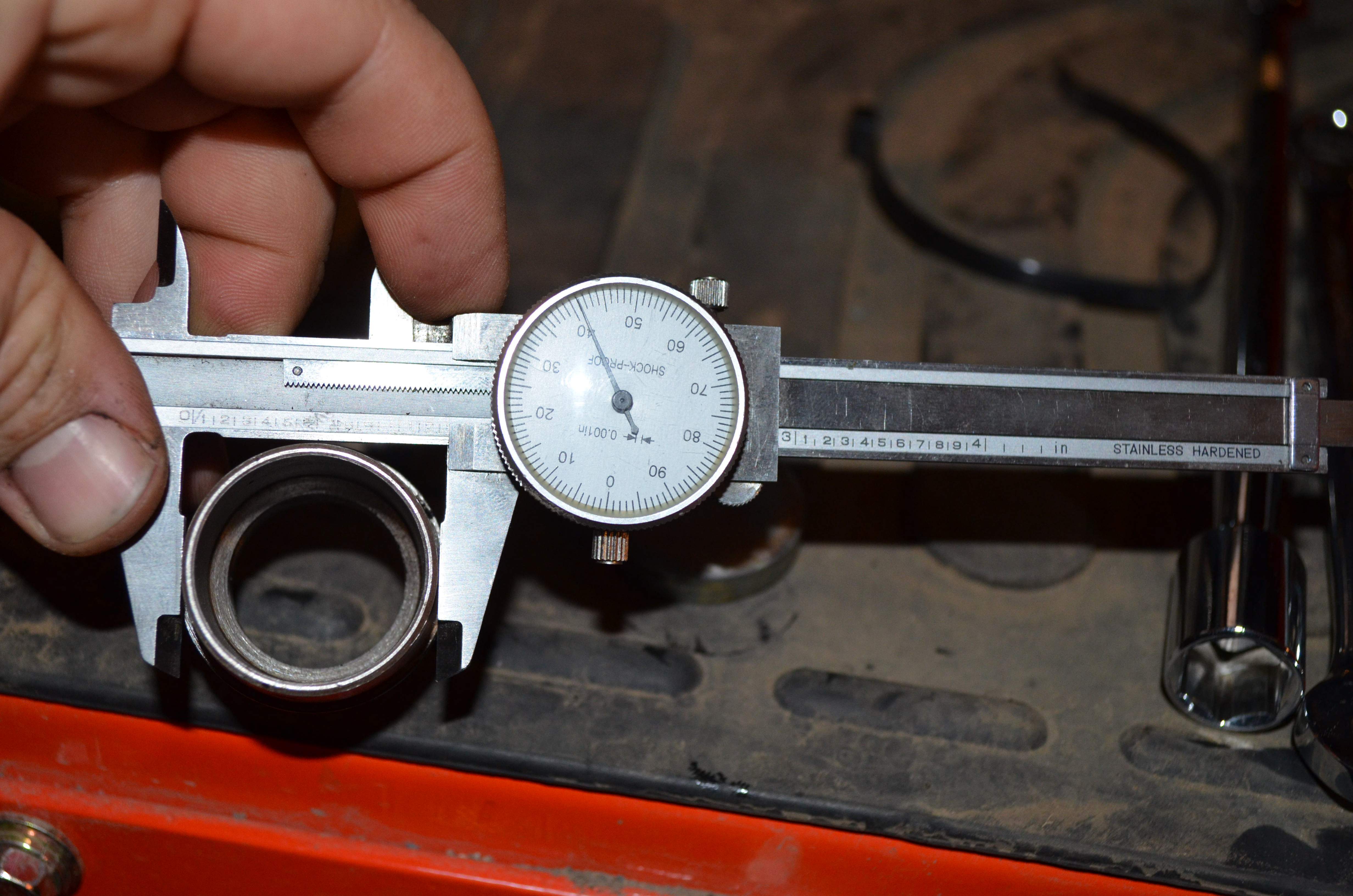

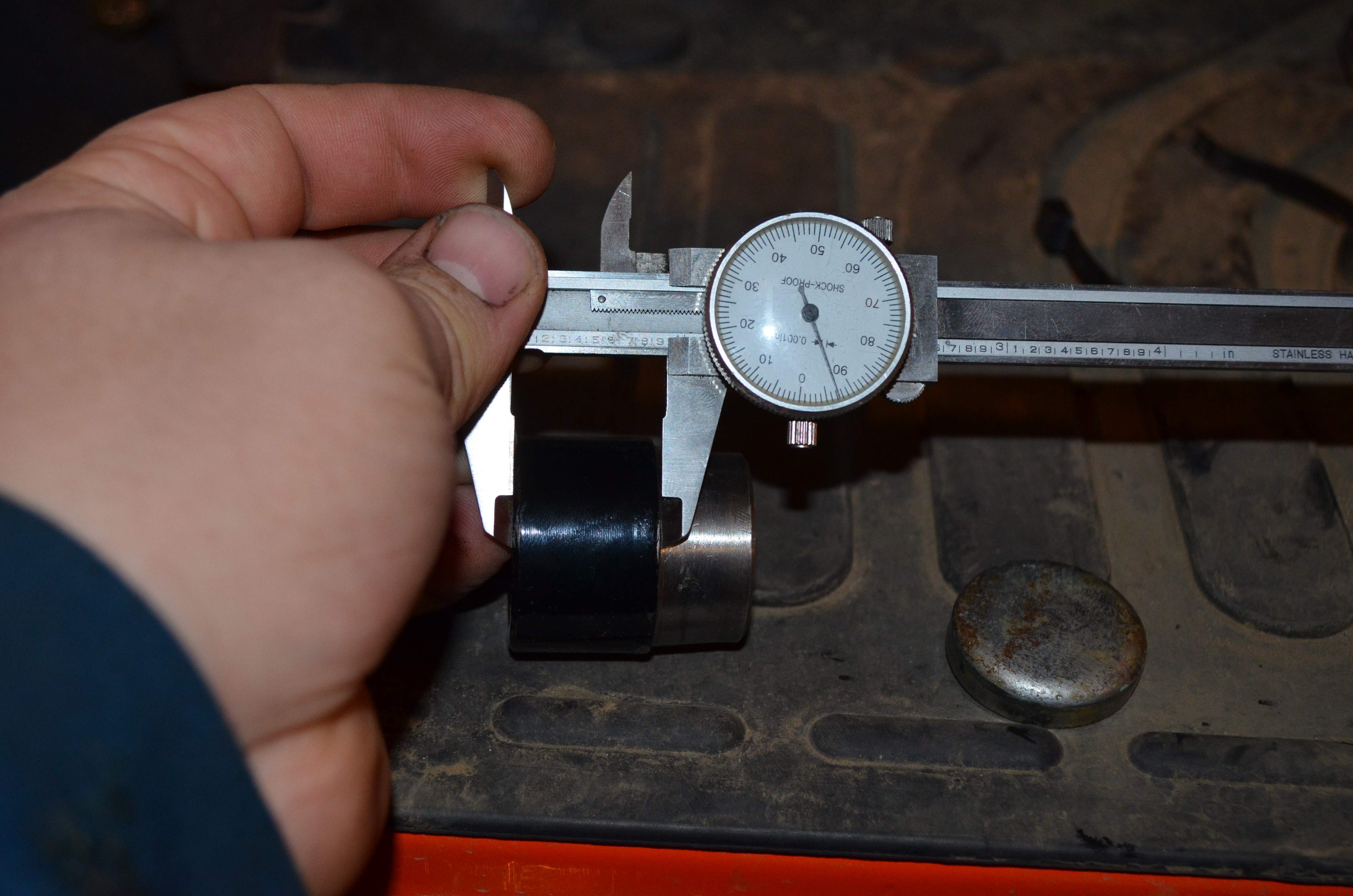

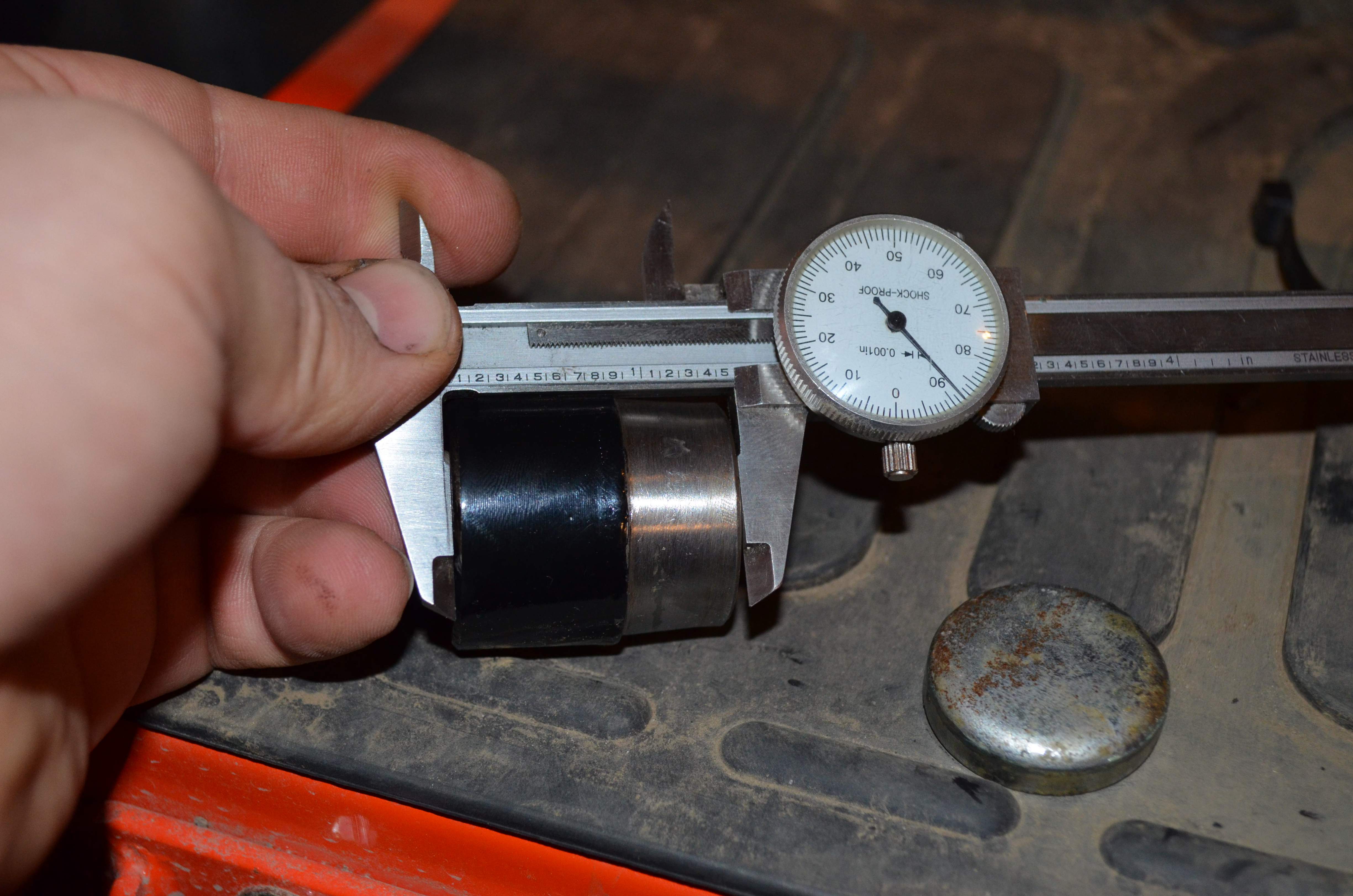

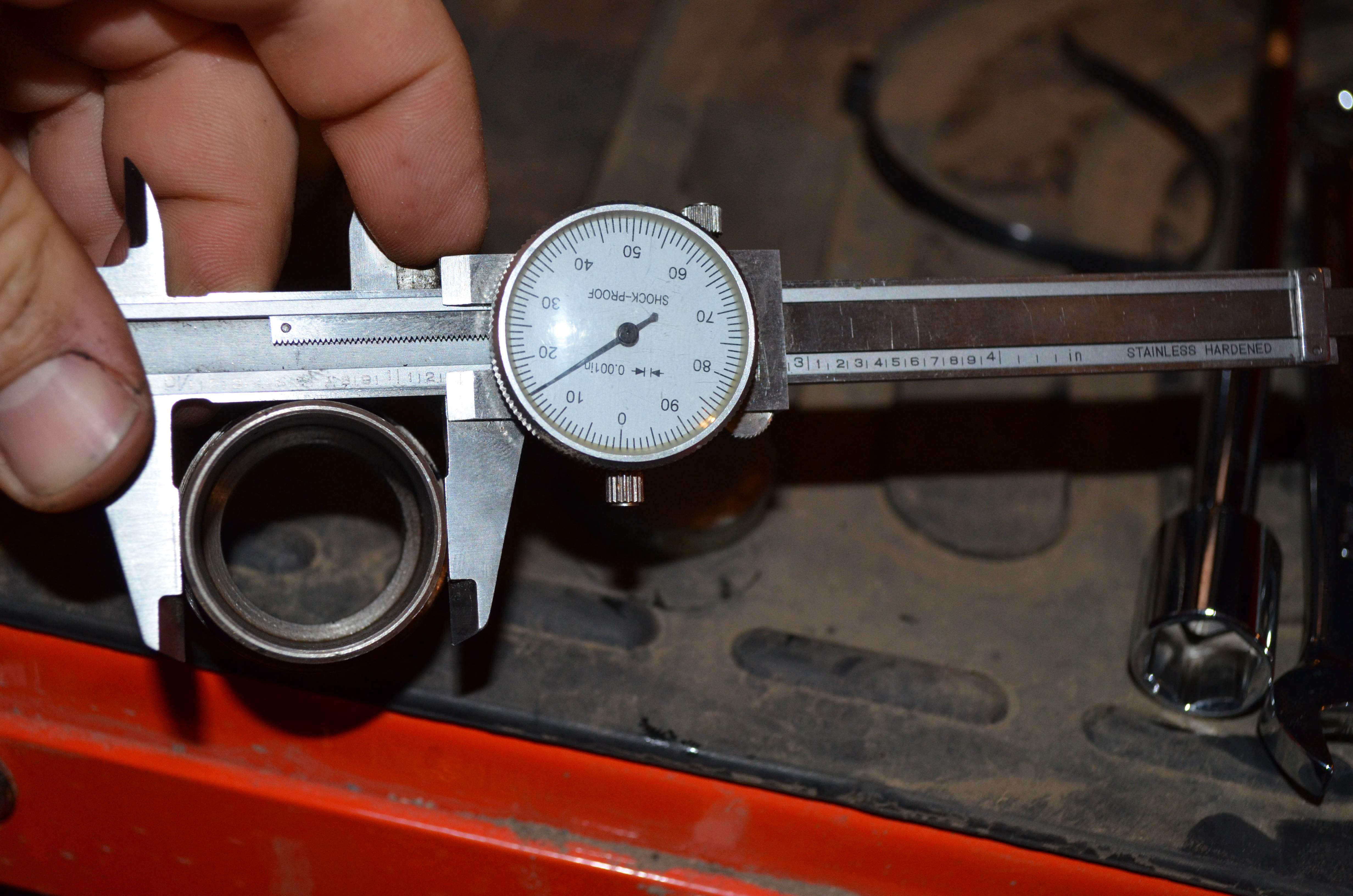

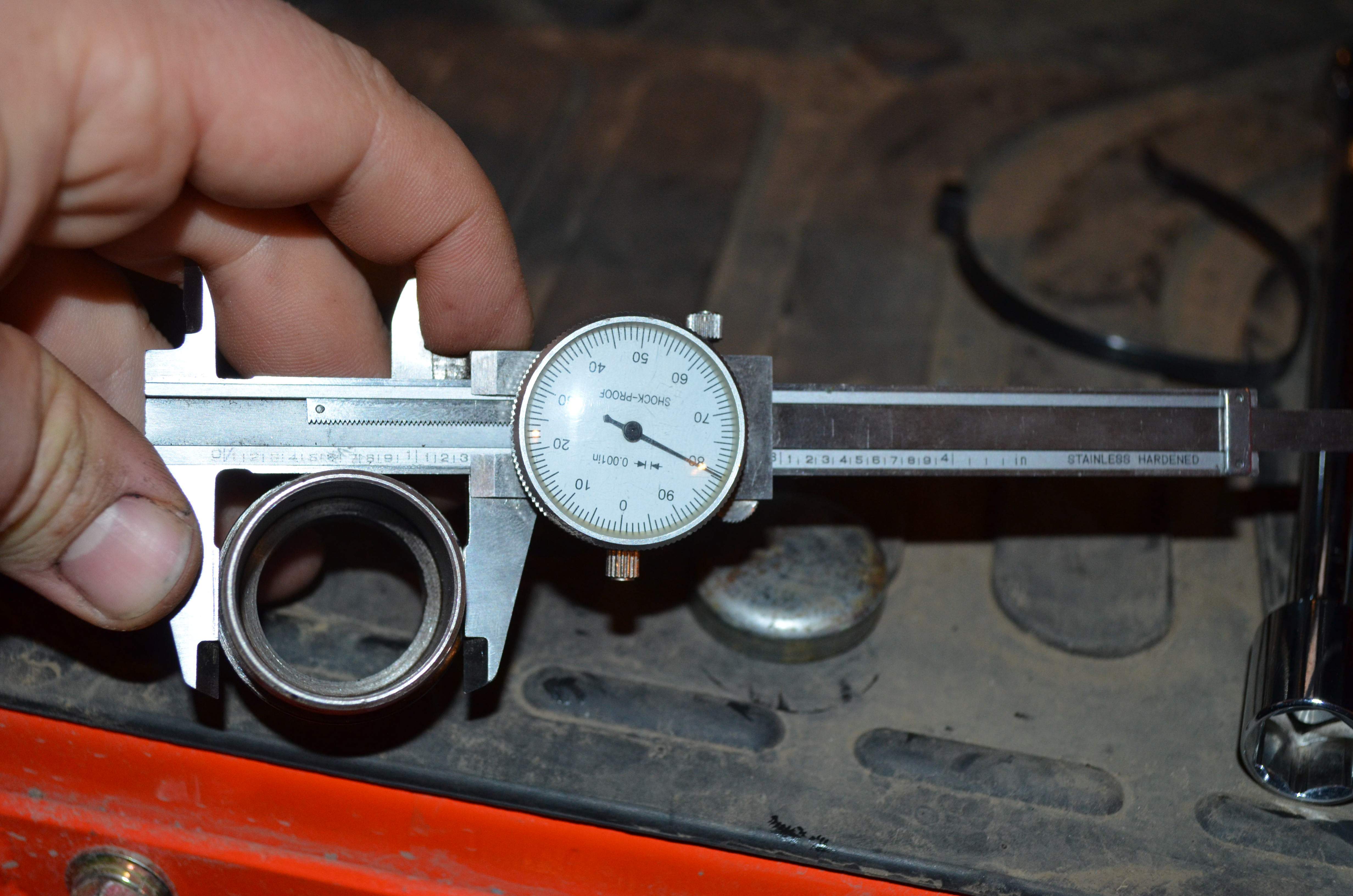

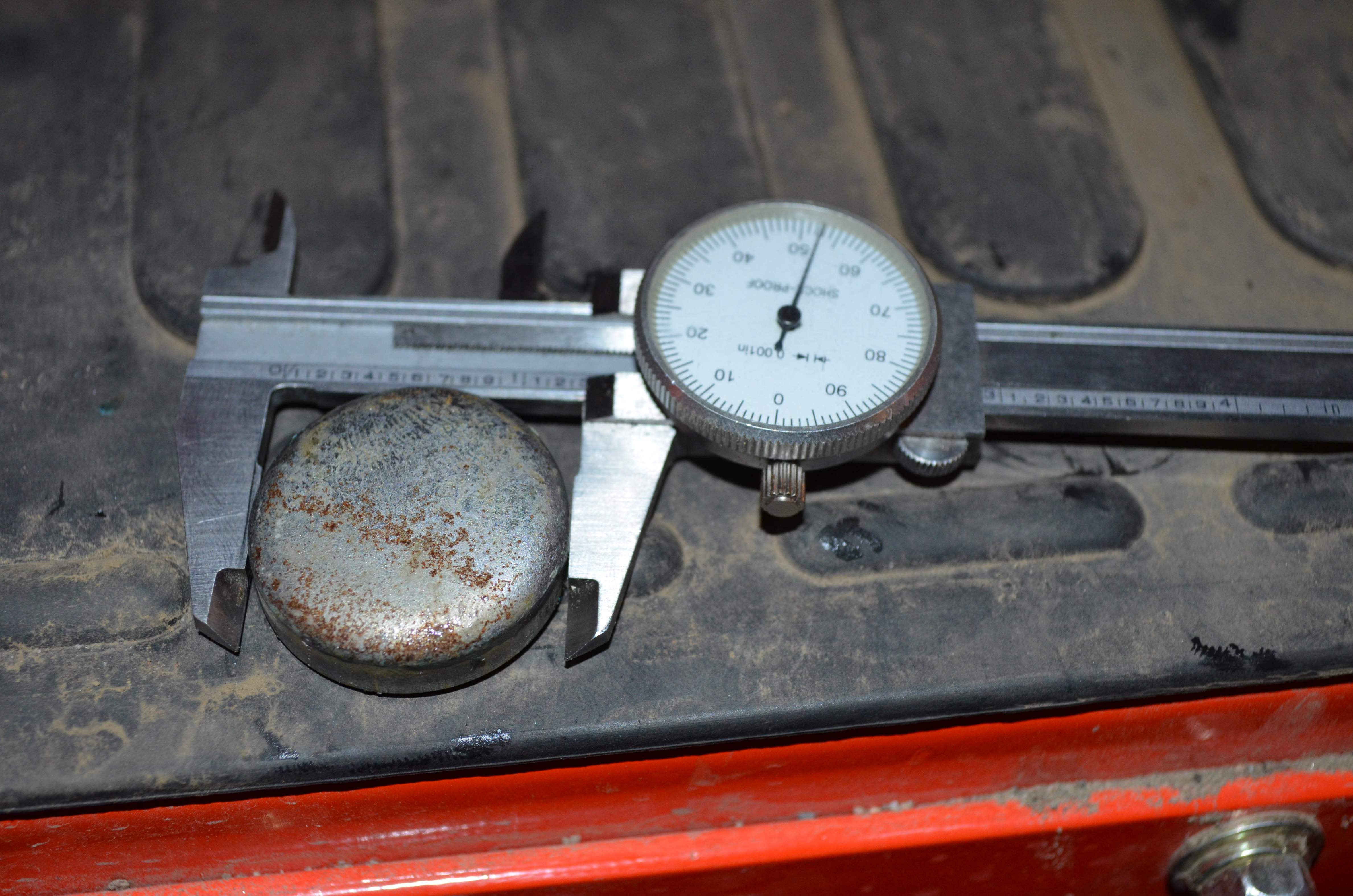

I bought my block heather from a Kioti dealer, it's Phillips & Temro p/n 3100002 and the p/n for the bushing adapter is C28125 (I don't know the manufacturer). I took some pic with a caliper. I would not use those pic to machine one though, it's not an accurate tool like a micrometer, I took them for reference only. The other reason not to machine one is I don't know which type of steel the used.
At the begin of the taper
in the middle (+ or -)
at the end of the taper
The freeze plug

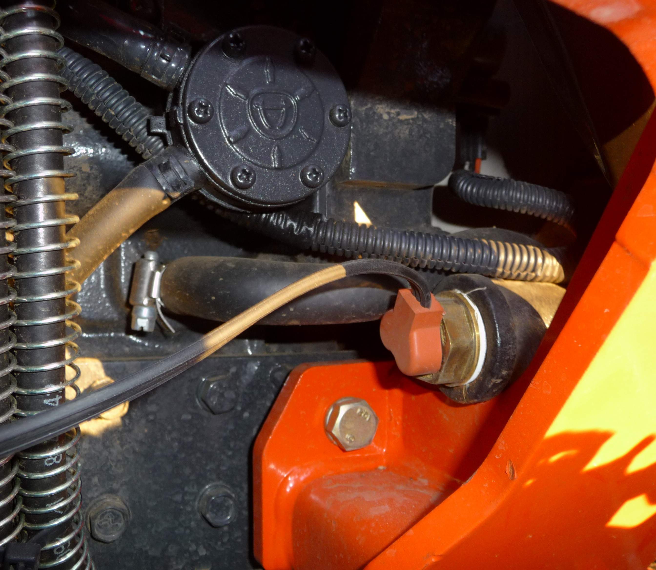

I want my engine last as long as possible too. Can you post an other photo of your installation, it seem to be install on the small hose between the rad and the engine block.

Has anyone figured out exactly where this heated is installed? I like this install a little better than the frost plug install.
